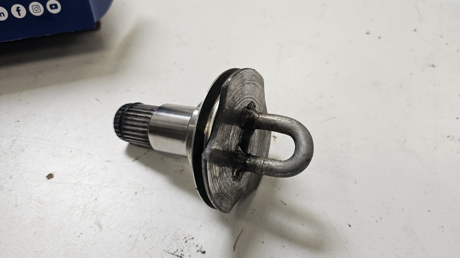

    Pretty small mass right in the center so I can't imagine it would make a big imbalance, but who knows.

    At that point the little imbalance isn't really an issue

    Yeah you'd probably have 4wd off anyways so it shouldn't spin much or at all depending on which side it's on.

    Drop bracket lift and booger welds
    Ya'll are making me wanna revisit my limp kit.

    I mean I like the loop. But you can just use a prybar on the two lips to pop it out. Thats how I remove the CV anyways.

    If you cut the CV cup too close to the seal/shaft interface, there won’t be enough material to pry on and it will be a total shitshow :anonymous:

    It's less Tacoma and more mod
    I feel like you're speaking from experience

    What gave it away?
    Luckily it was in my garage, I just had to weld some shit on there in place to hook a chain strap to it. Thought I was going to pull the fucker off the jackstands trying to get it out.

    The way @betterbuckleup cut his you could use a pry bar.

    The few times I've pulled CVs, it seems like there's a magic orientation where it pops out easily. If it's putting up a fight, turn it a few degrees and try again. Repeat until it comes out.

    Agreed. It might have to do with the orientation of the retaining clip, for instance on install, by setting the snap ring with the opening facing down.

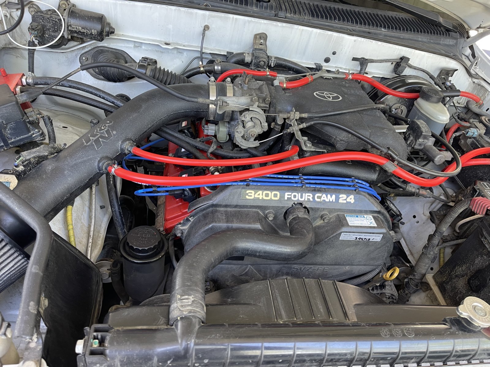

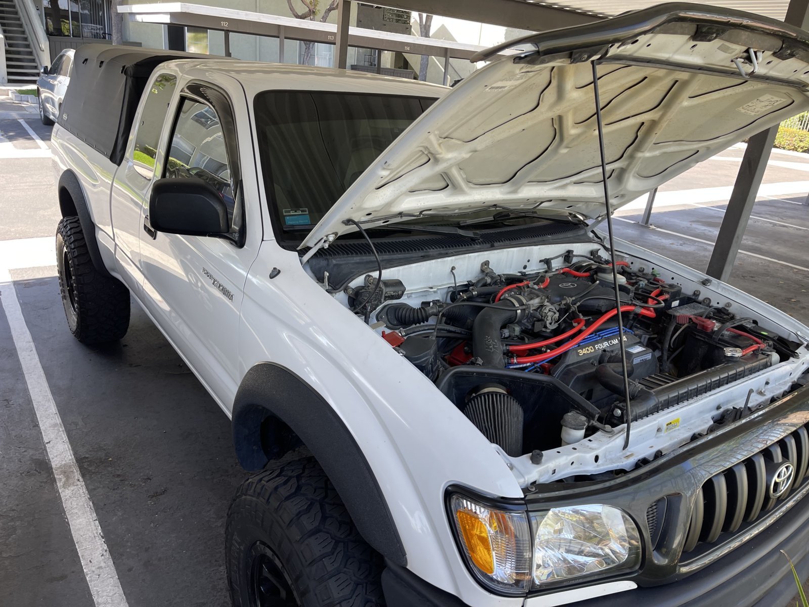

    Denso spark plugs and NGK wires went in. Been having a nasty misfire lately so crossing my fingers this’ll fix it. Drove around town for a while and so far so good. Annoying being a DIYer in an apartment complex.

    sending you good vibes that all Fixes the issues you have been having :fingerscrossed:
    ?? Annoying because the neighbors want to know if you do a side hustle and can maintenance/fix their vehicles? LOL
    once the UPS guy deliver some new TekTon tools while doing something or other deep underneath the truck in the driveway and he wanted to know if i did a side hustle on his Tundra that was having electrical issues LOL with the battery often drained after his UPS delivery shift
