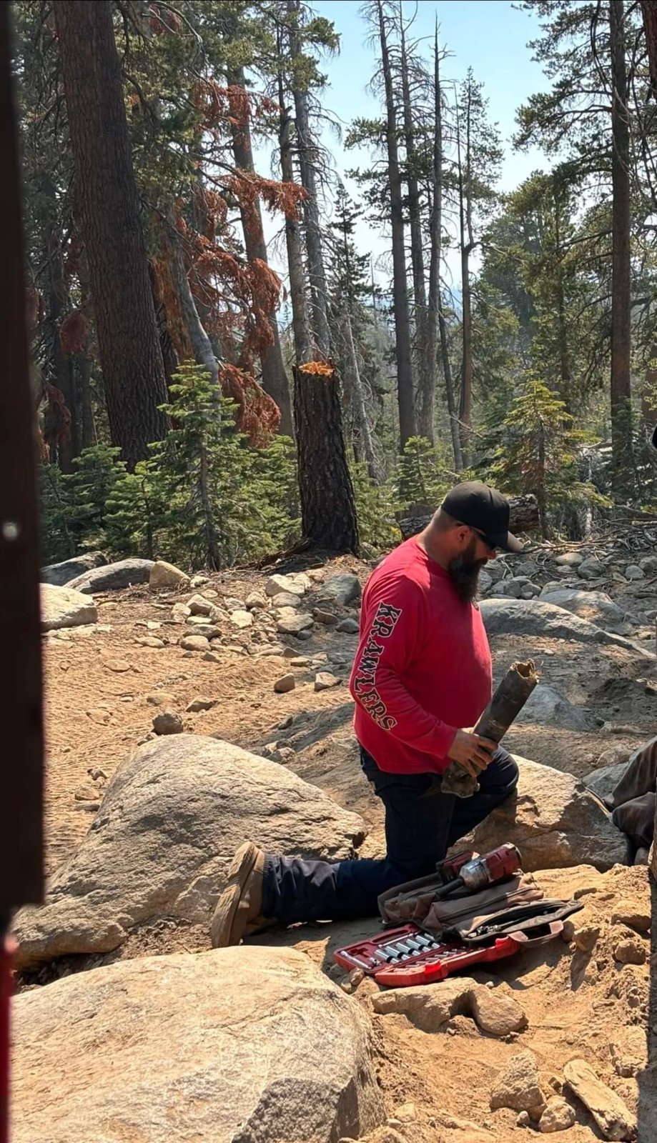

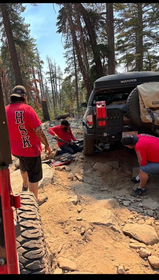

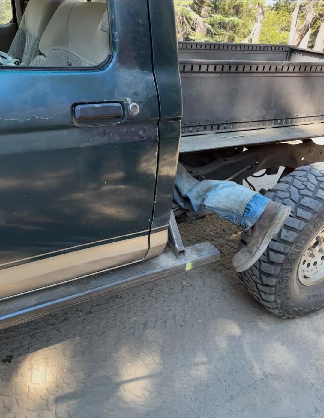

    Maybe we didn't need a chainsaw... but, it was a good thing we had a welder.
    We even got people that weren't in our group out of there. :thumbsup:
    [​IMG] [​IMG]
    Were able to remount this dude's lower control arm bracket... was completely broke off.
    They were going to probably have to leave it, get to service and call his dad, then wait for him to come from LA (6 hours) with a trailer.
