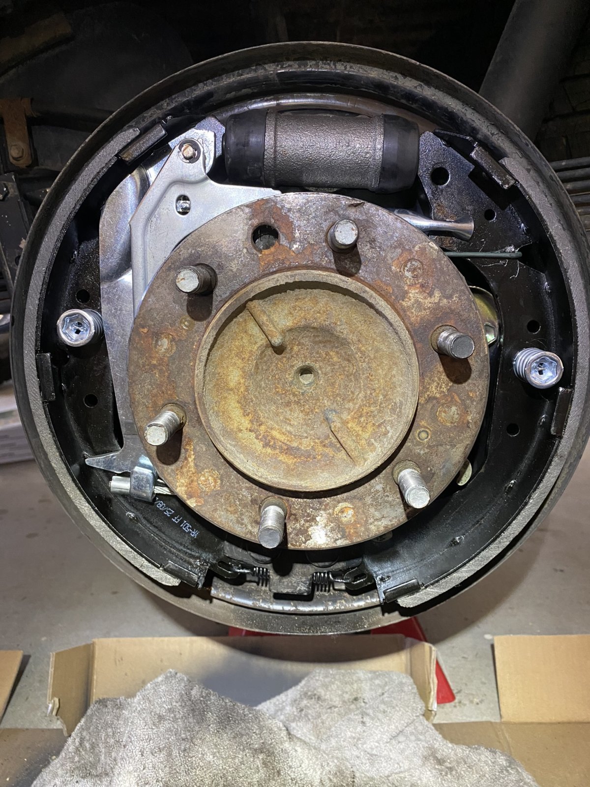

    First time doing drums (also wheel cylinders), first side took probably 3 hours, second side took maybe 45 minutes. Still need to do a ton of adjustment but noticed going in reverse and working the parking brake a ton made a huge difference. The old drums looked pretty great for 230k.
