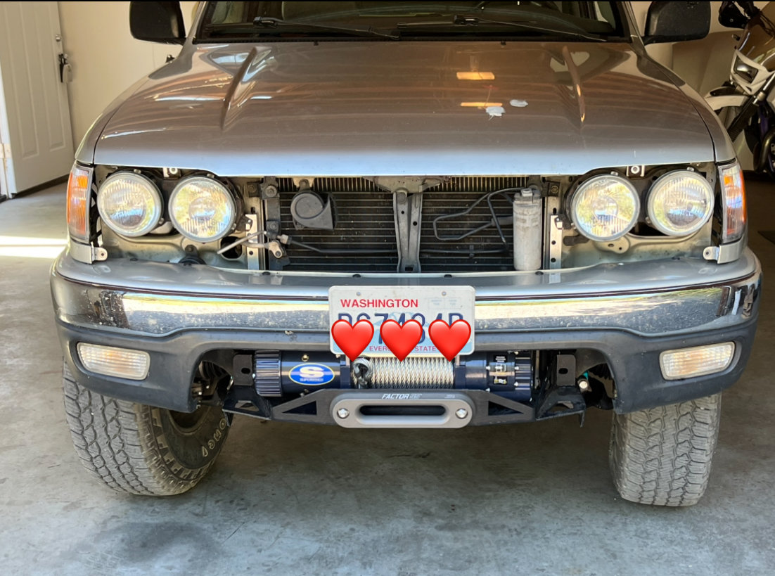

    So stoked to see the quad round setup coming together!

    Thanks man!
    I have a set of halos/angel eyes I'm excited to instal, but I'm a little hesitant to crack open the new e-codes. The integrated turns in the halos would allow me to mess w the lower bumper a little more:D

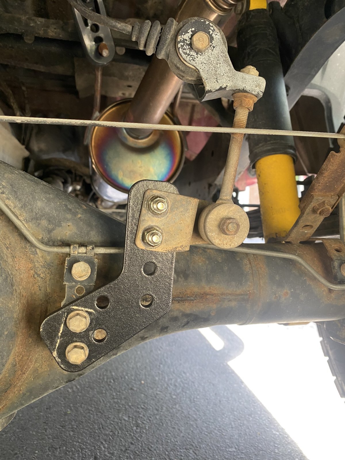

    Almost forgot about the rear proportioning valve bracket to account for the lift... 3 years after the fact.
    Night and day difference along with properly adjusted rear brakes. If you haven't done it - do it. This was from BAMF.

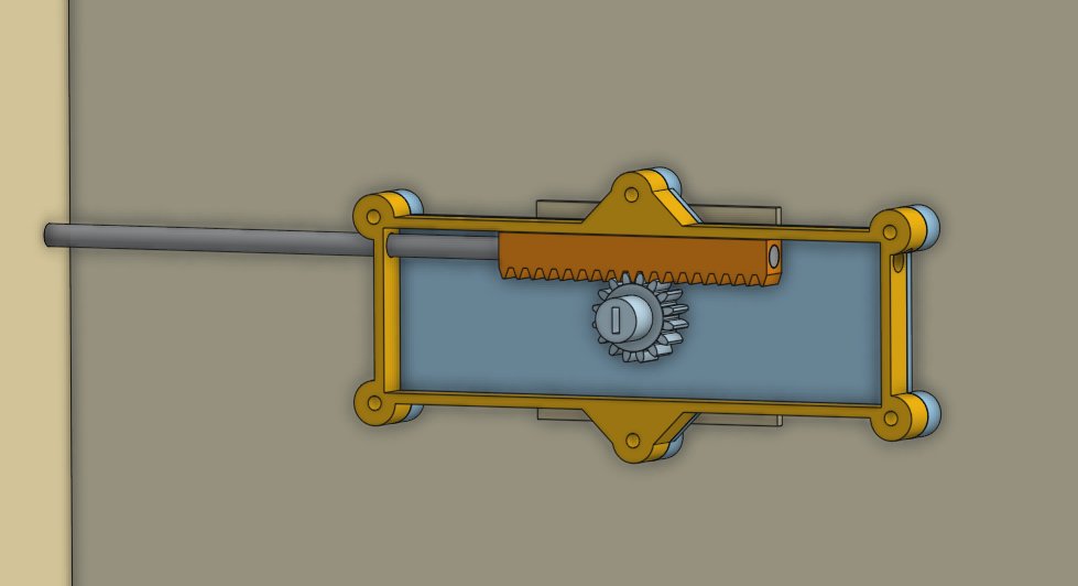

    Got a 3D printer recently so I redesigned my drawer lock with a rack and pinion. All the off the shelf "cabinet locks" I could find just seemed too chintzy and I didn't like the idea of a locking handle
    Looks awesome

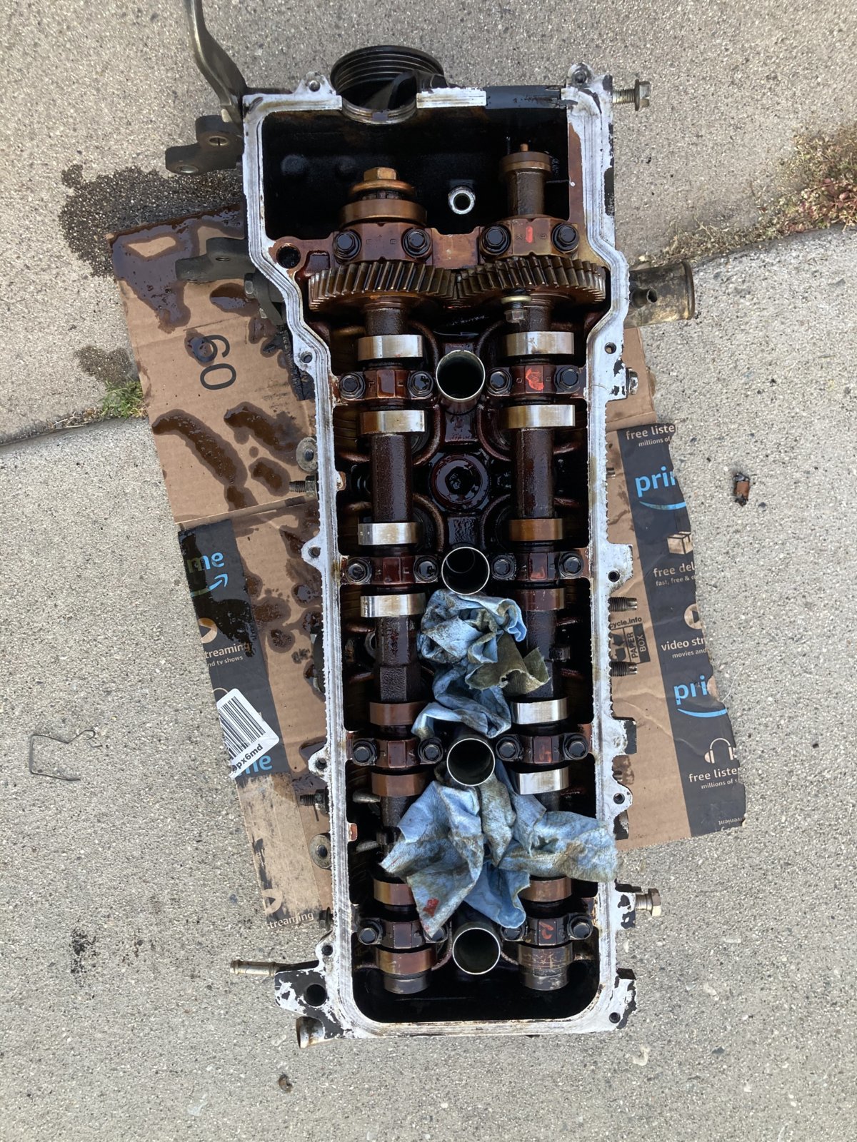

    my back hurts

    Why are you pulling the head(s)?

    I'm guessing a burnt exhaust valve

    Actually, the valve seals where starting to give you white smoke. And a leak down test showed the valve needed some touching up.
    I really thought it was a burnt valve since the valves where never adjusted. But so far so good.

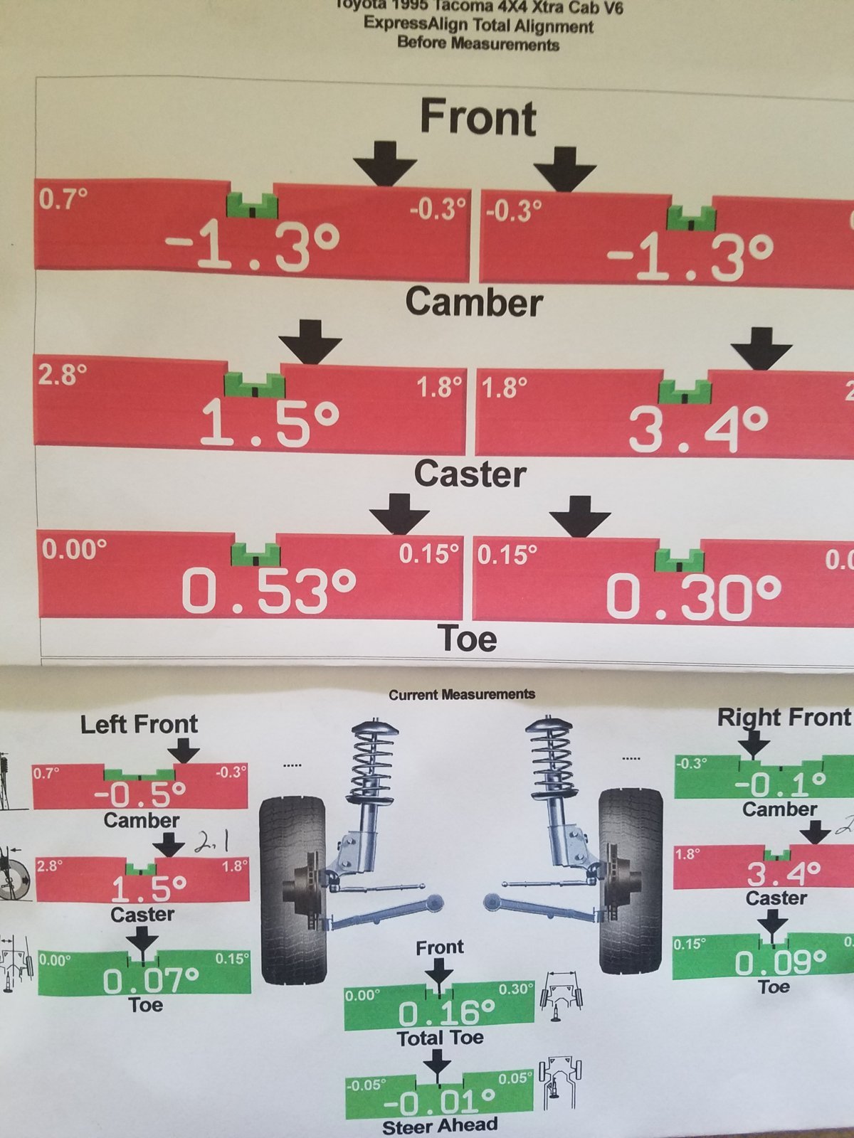

    Got the front end aligned on my 95 4X4 yesterday. The tech said "I maxed everything out to get you here and that's the best I can do". :)
    To be fair, it was wrecked when I got it, left front hit (above frame). The tires were wearing on the outside. It has 266,666 miles on it. Drives excellent. Gets very few miles anyway, so I'm gonna settle for it.
