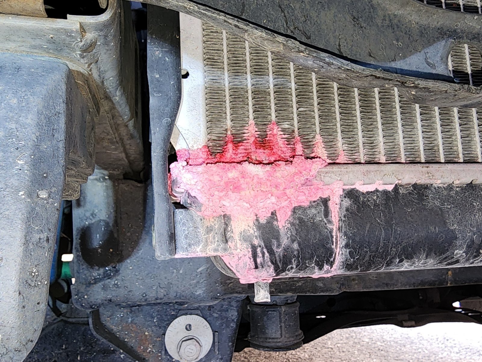

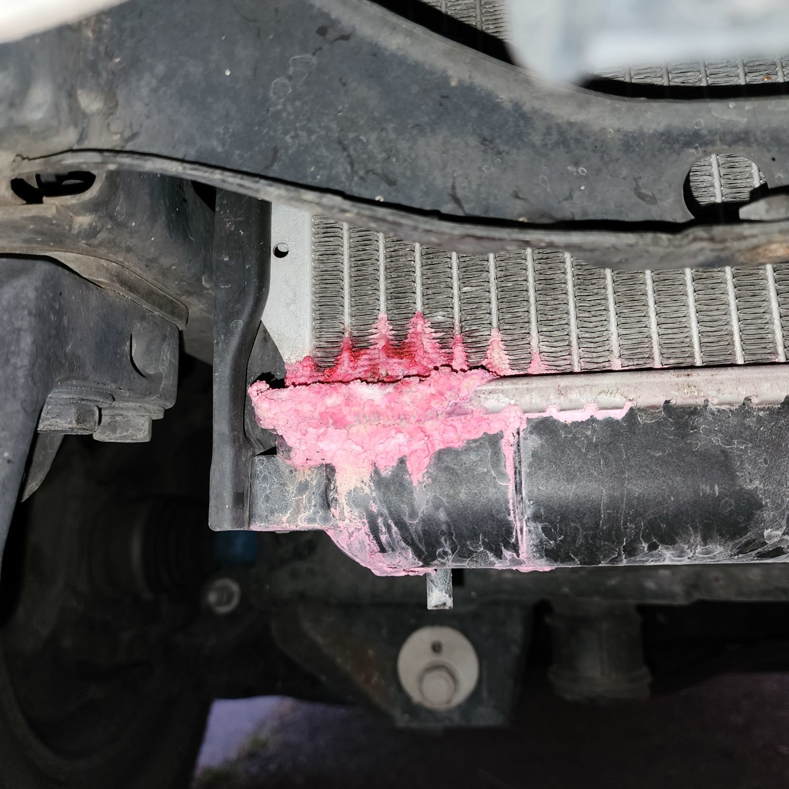

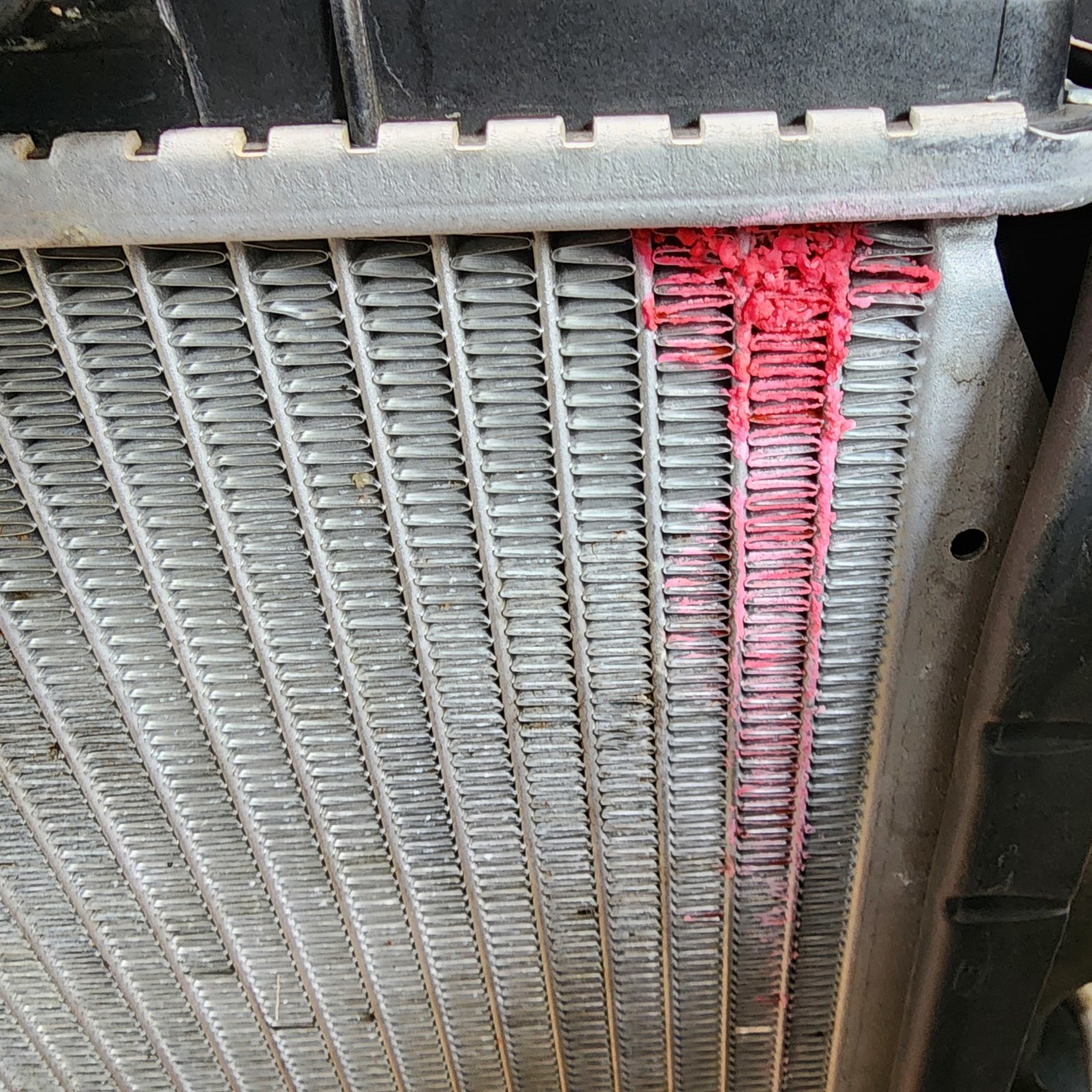

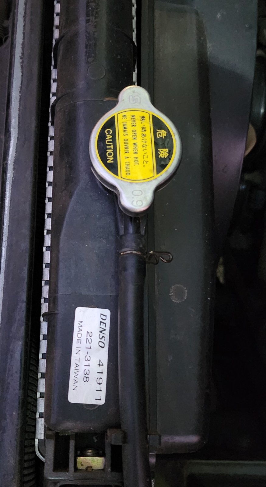

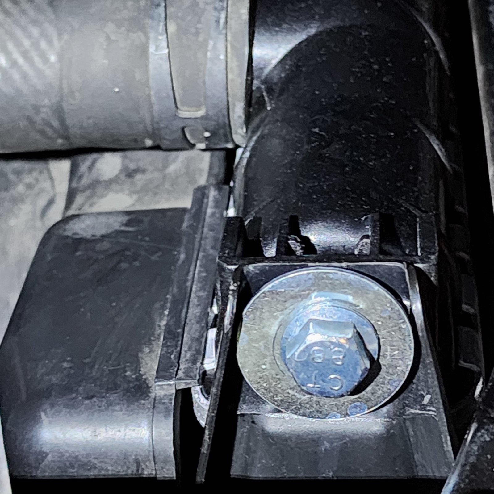

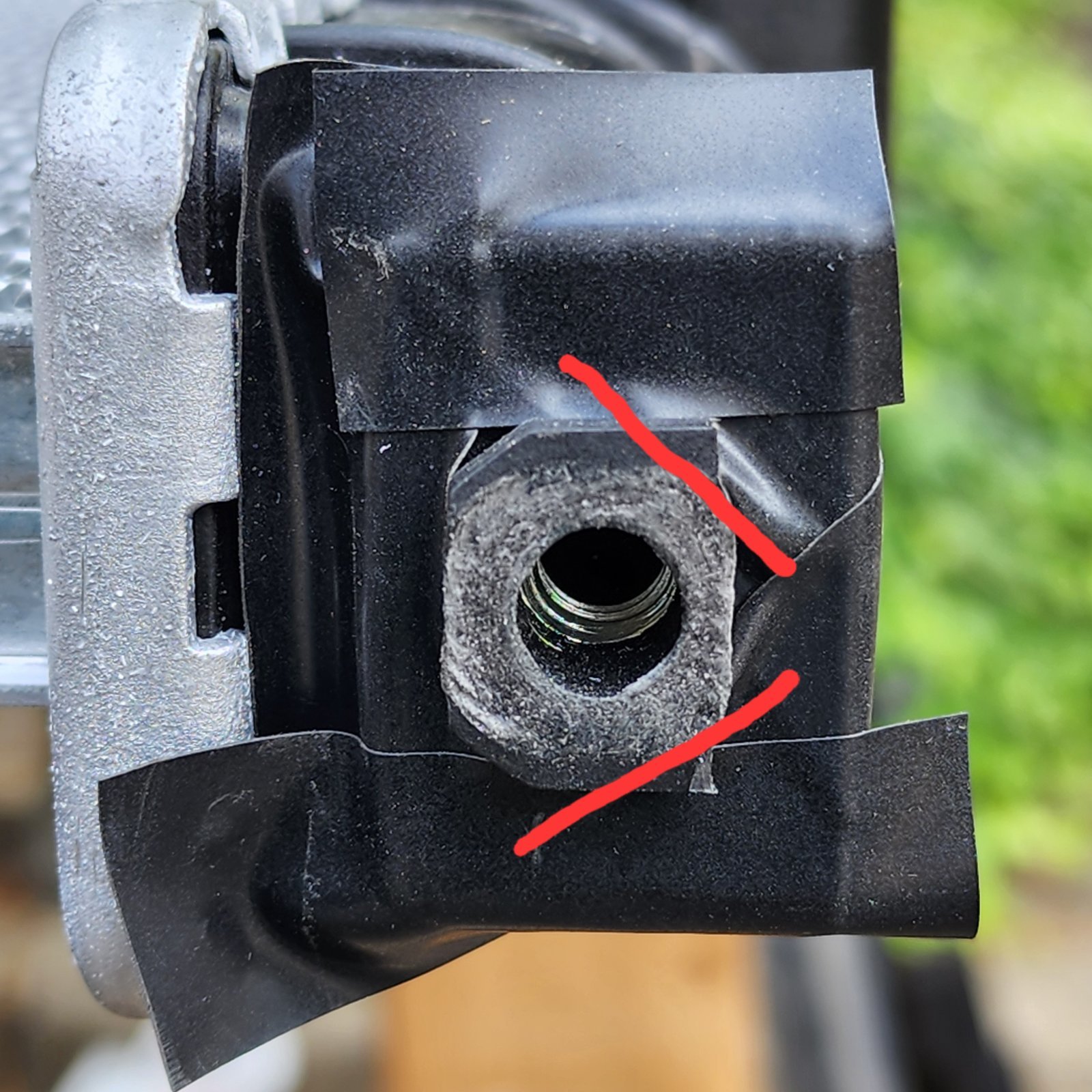

    Do you have a picture of your MVP rad and who the manufacturer is noted as?
    Toy parts was nice enough to pull one of the MVPs out of the box (not necessarily for Tacoma) and said it was marked Denso made in Taiwan.

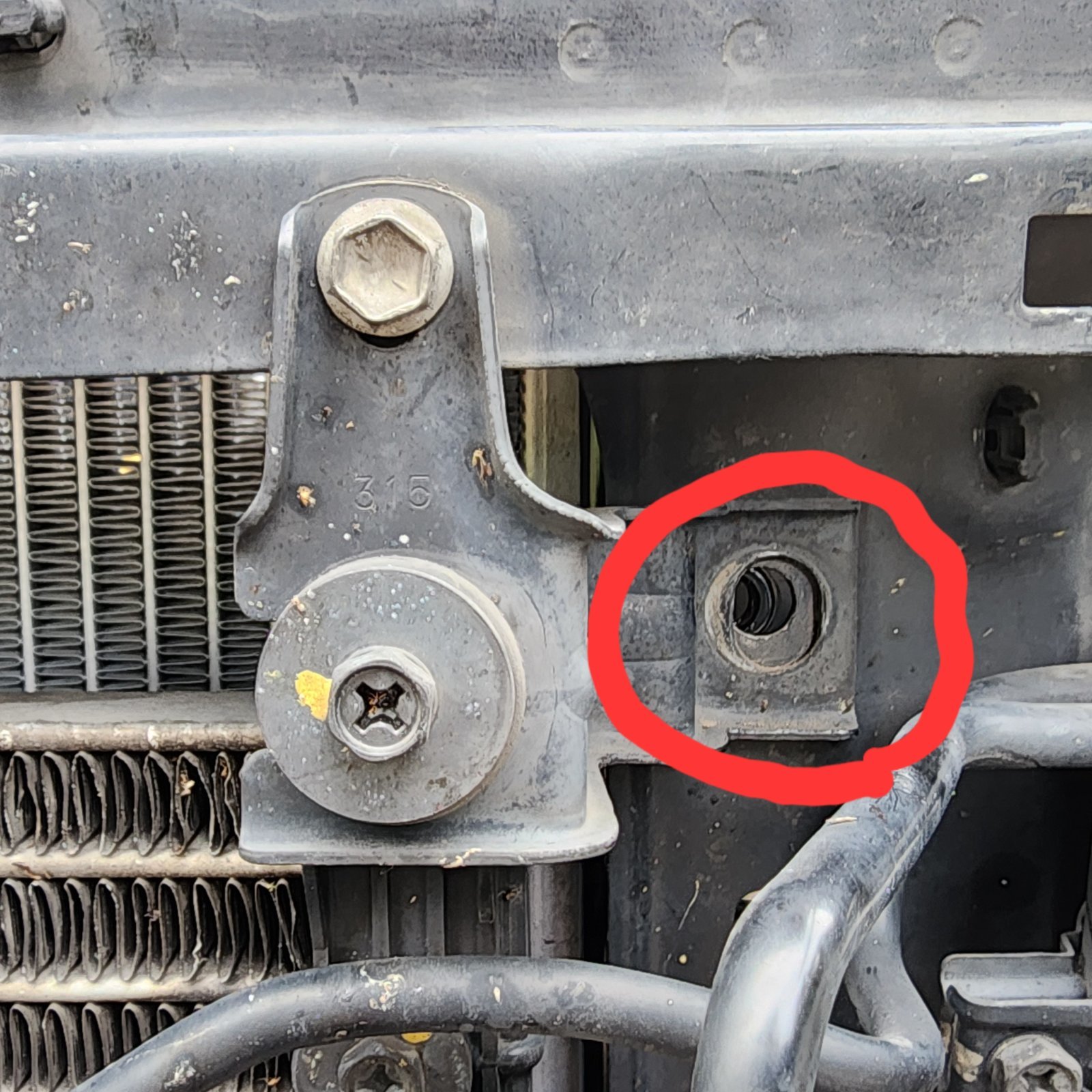

    So venture you've got what is actually a Denso 221-3138. That is what I put in previously, and had the same issue you note with fitment, with the front apron mounting holes being about 1/4" too wide to fit the bolts in the radiator mounting brackets.
    Solved that by swapping out the aftermarket brackets for the OE brackets mounted to the replacement core, instead of widening the mounting holes in the apron.
    Here's the details....

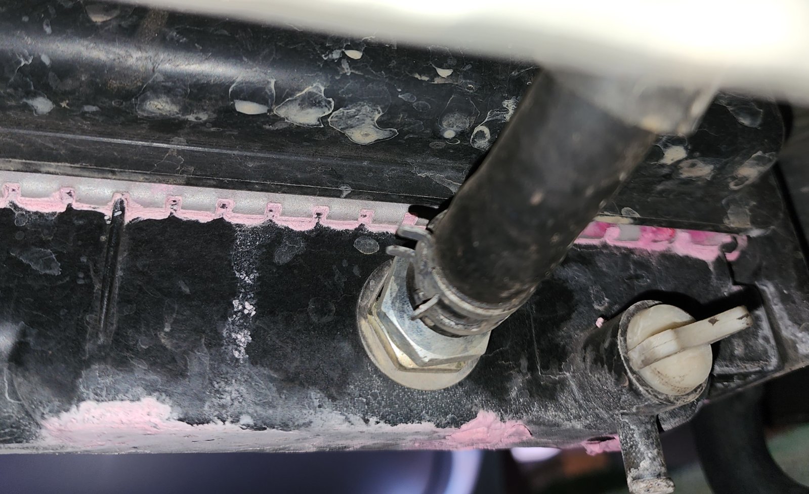

    That rad apparently began leaking about 2 quarts sometime this past 3000 miles since the last oil change, noticeable across a couple days just shy of 2 years after purchase/install (turns out it was purchased/installed July 2022 not 2020).

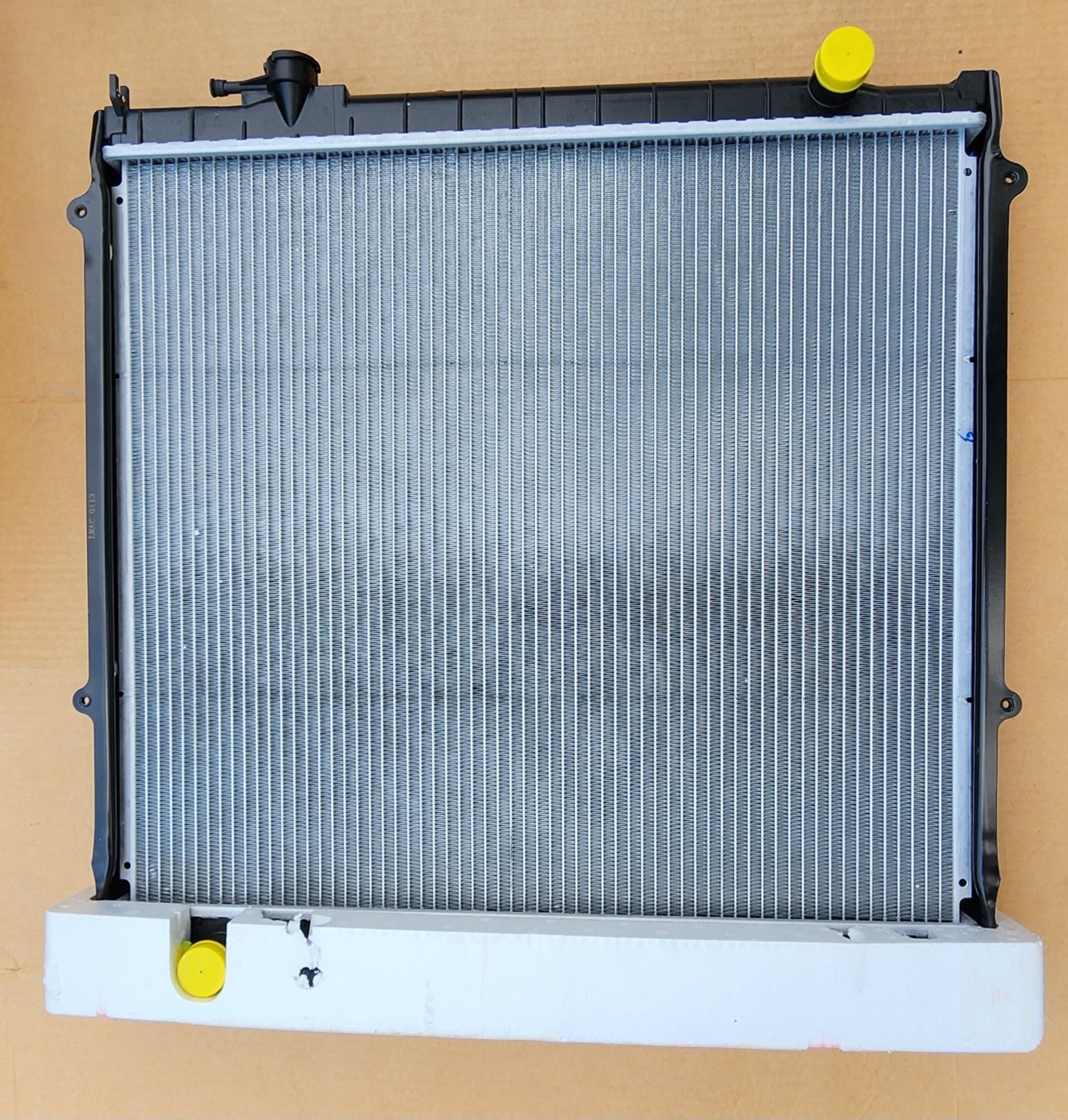

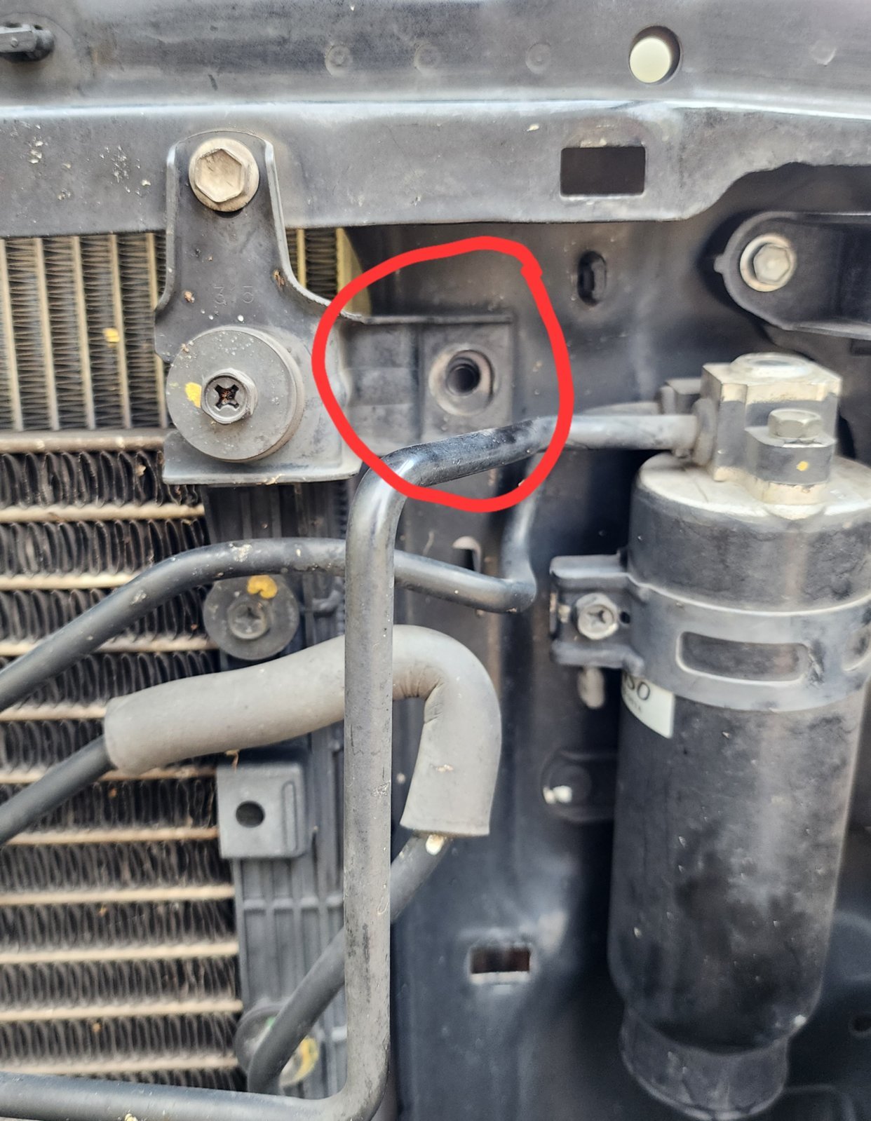

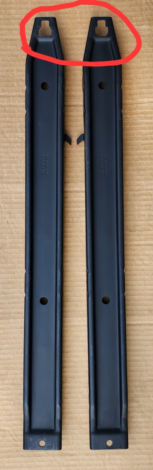

    So picked up one from the LAPS this time.
    Found again like you did that the rails from the LAPS rad like the Denso seemed to be about 1/4" off alignment with the front apron mounting holes.
    Modded the way the rails mate to the top tank due to the difference in the rail cutouts.

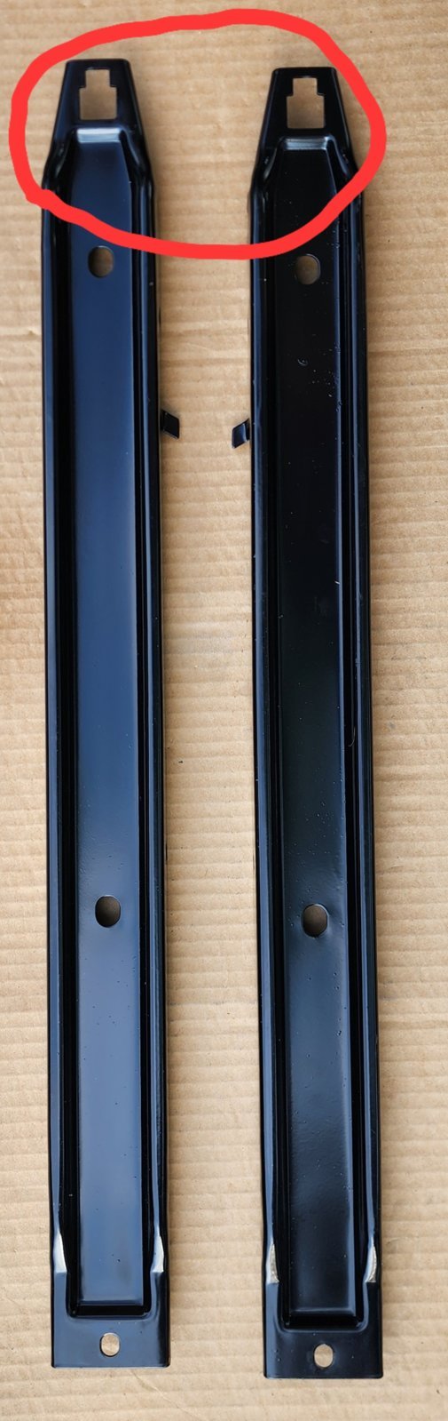

    The LAPS replacement rails had a rectangular cutout for the top tank mount
    But the OE rails fit an angled cutout for the tank mount.
    Note the LH side has angles on the top while the RH side has angles on the bottom of the bracket cutout.
    So a little contouring to the tank detent allowed the OE rails to slide on (black tape is temporary to protect tank while tooling). Finished with a big washer to capture the mount just for good measure.
    Then the mounting holes lined up.

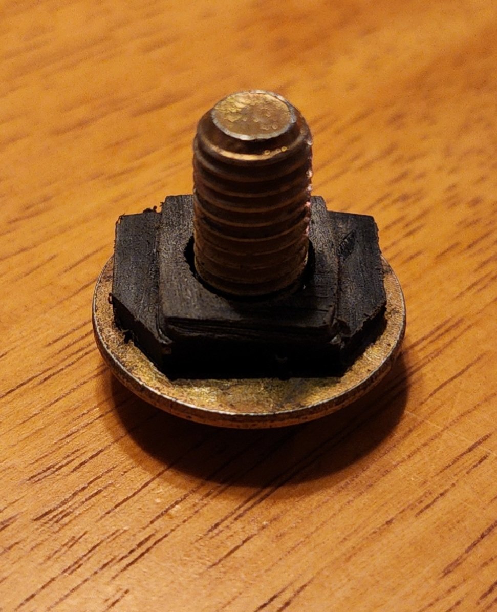

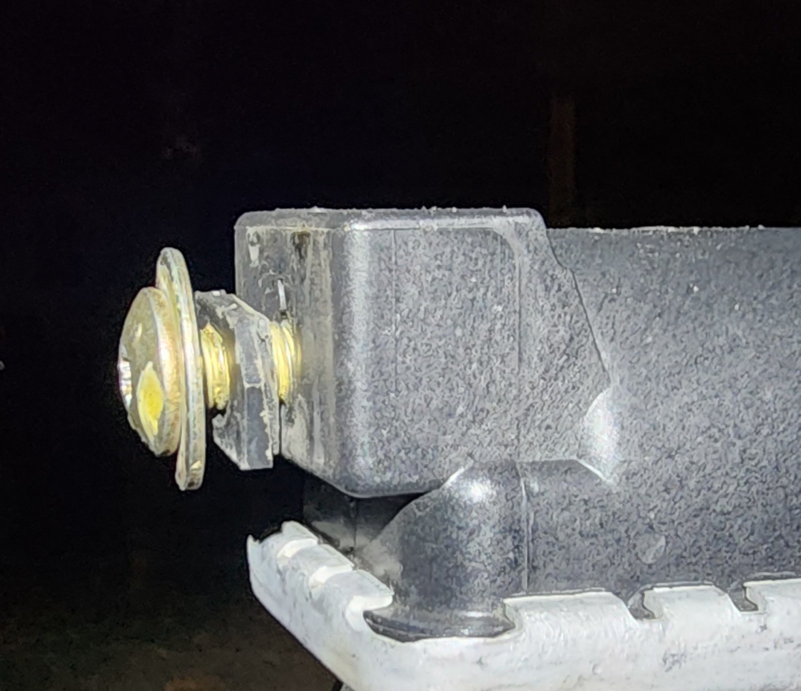

    Previously on the Denso, solved this by cutting the plastic detents clean off the sides of the tank mount with a hacksaw blade then reshaped them so they captured across and on the inside of the bracket notches to limit side motion ... held in place with the OE bolt/washer like this.
    The mod this time around was simpler and much faster to just leave detents in place and reshape a little.
    Hope this helps!
