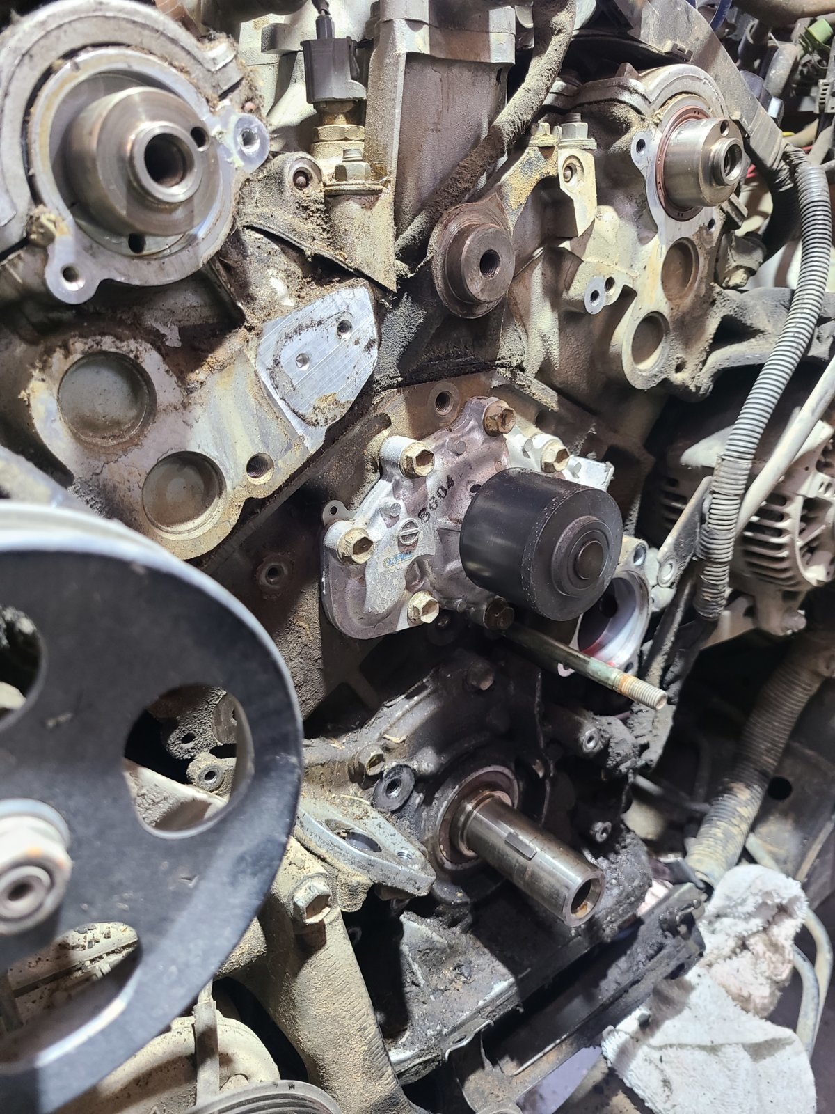

    Second time doing the timing belt and water pump. Good for another 90k

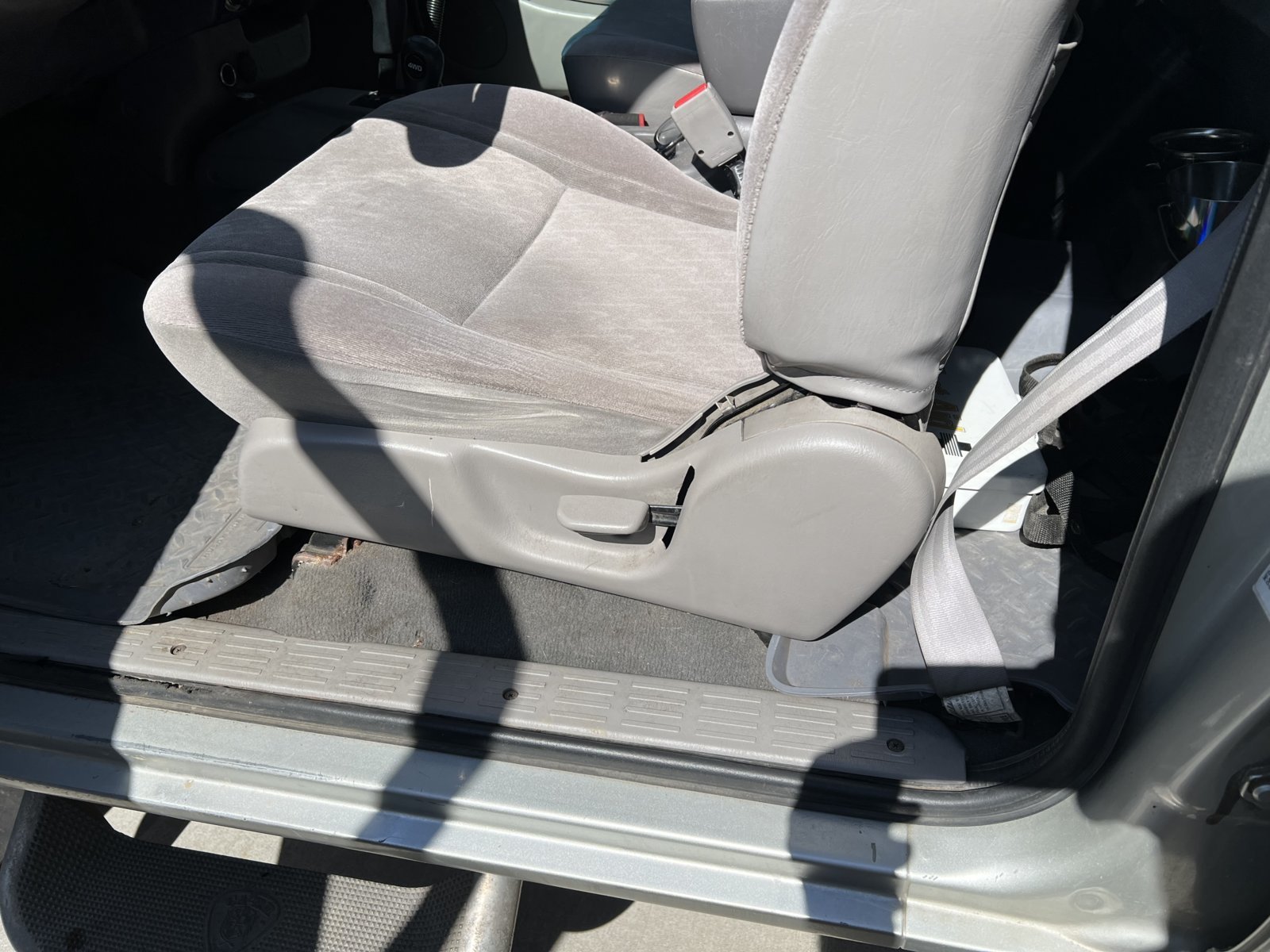

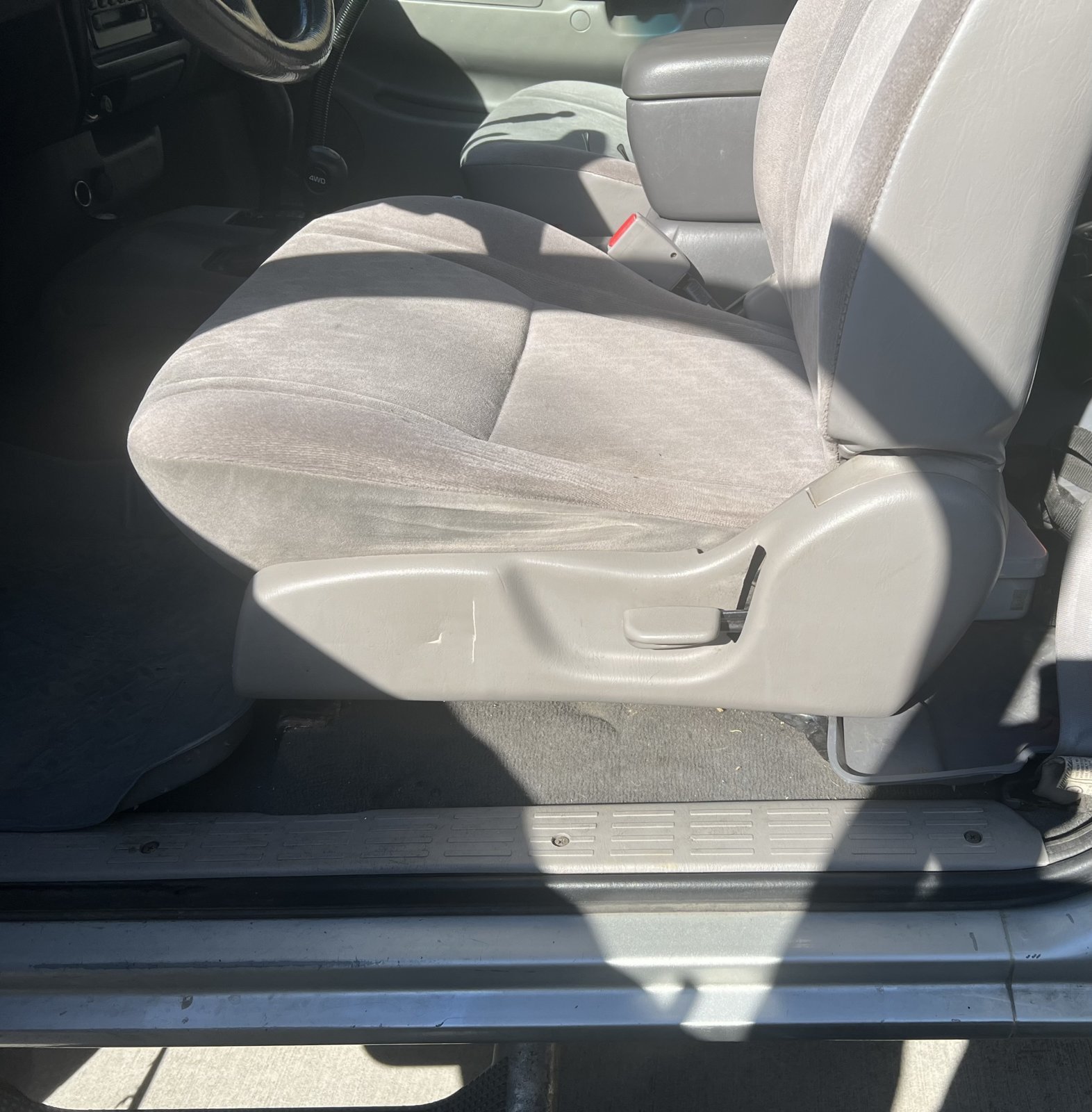

    Installed my Seat Trim Side Cover Reinforcement

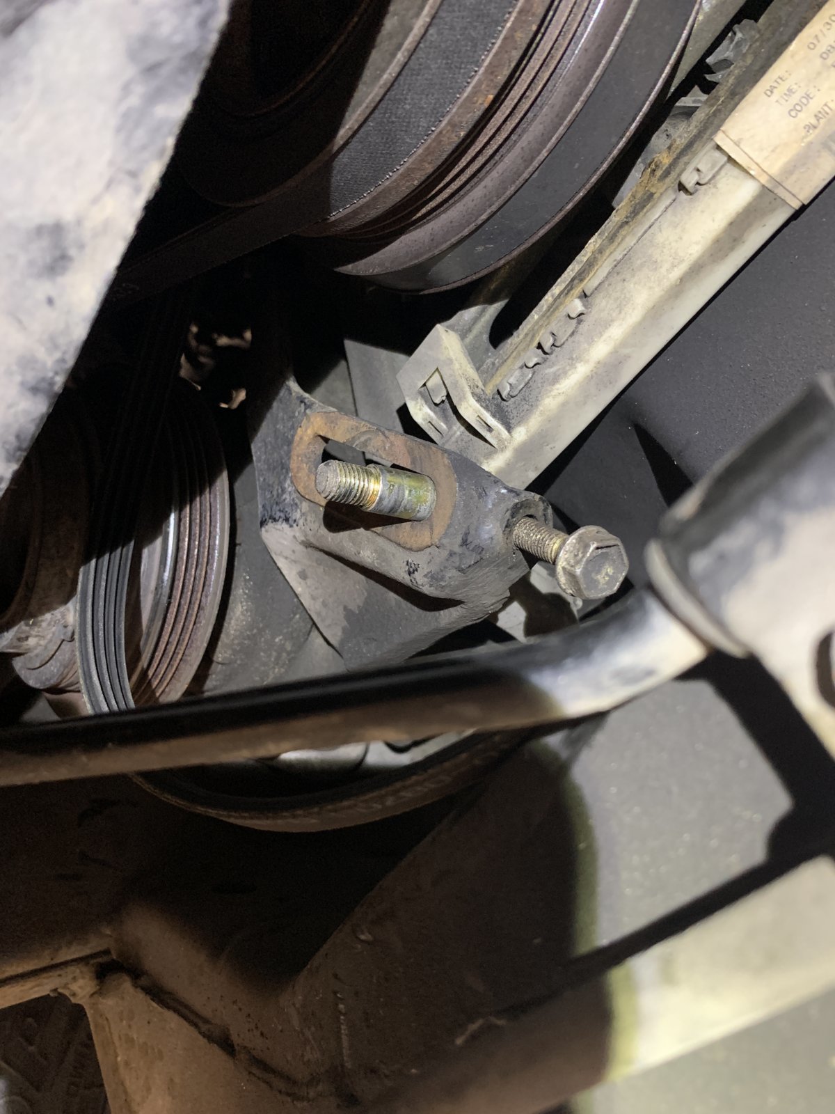

    A/C quit on me the other day. Came to find that the idler pulley nut came loose and so did everything else with it. Thankful for an easy fix and that the components (other than the nut) stayed on the skid plate.

    You should replace the bearing/pulley while you're at it.
    Wonder if the bearing going bad caused the nut to loosen. :notsure:

    Yeah you're probably right. Money is tight right now though so I'm gonna send it. The bearing felt smooth when I had it off.

    Yeah he sells them on eBay, not sure if there’s a link in the thread but you can search for “Tacoma Seat Track Plastic Trim Cover Reinforcement”

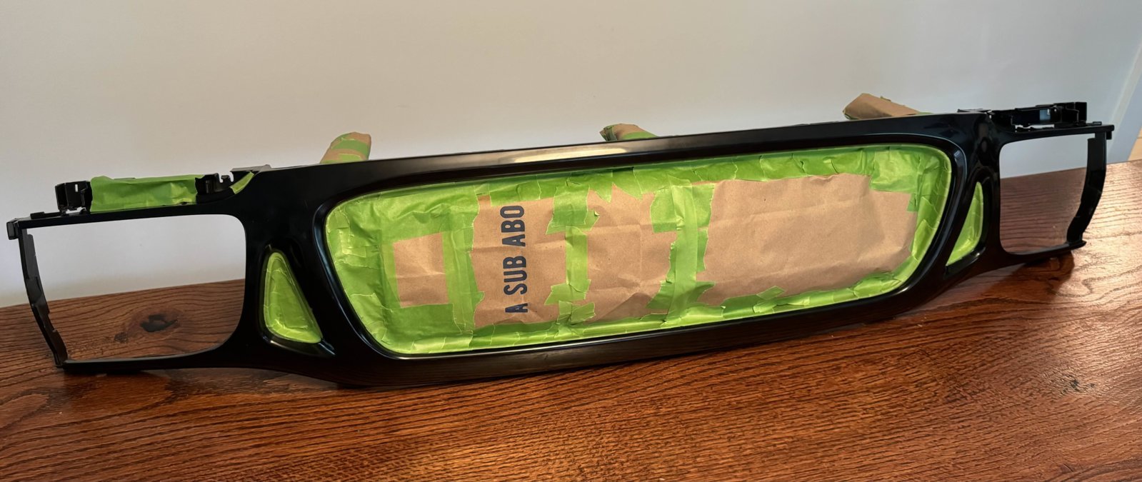

    Installed some DDI seat jackers and dipped the grille and chrome bumper trim with anthracite gray hyperdip. Not sure how well the dip will hold up, but I'm liking the color change.
    [EDIT] Forgot to mention I used these Dorman corner markers, which already have the dark gray accent strip

    That looks awesome. I'm preparing to do something to my ugly chrome grill and bumper trim. Can you share any info on how to go about this dipping process? And did you have to peel off the old chrome wrap or sand it down prior to dipping?

    The grille was pretty easy, I bought a new one off Amazon so I could work on it off the vehicle. I went with a black plastic one instead of chrome to hopefully get better adhesion. I didn't want to remove the bumper which was part of the reason I used plastidip. I figured any plastidip overspray would be easier to remove compared to paint. For the bumper chrome I used an angle grinder with an 80 grit flap disc to create some scuffing in the chrome to improve adhesion. I'm not sure if that was really needed but it didn't take too much time. For the plastidip I applied 4 dust coats and then followed with 5 wet coats.

    Awesome, thanks for the info. I'll likely do something similar :thumbsup:
