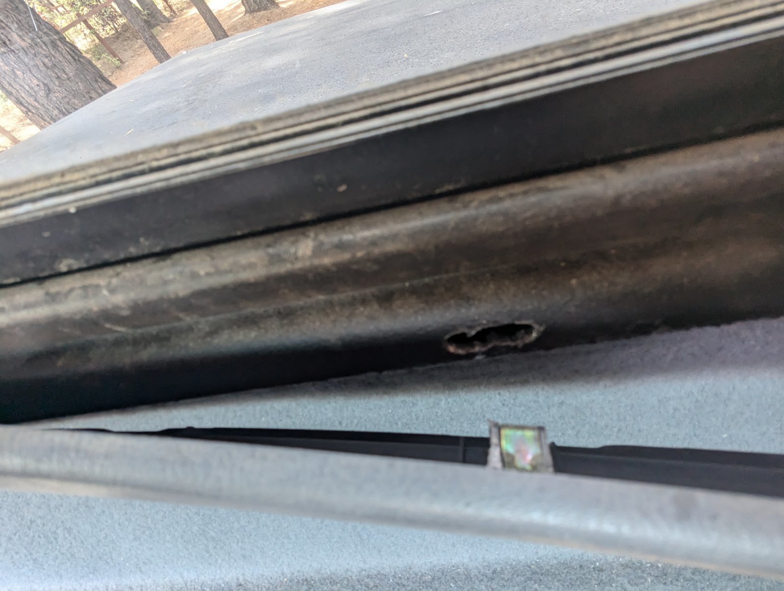

    So on my truck the outside clip holes were there. It was the 3 inside holes I had to drill.
    As for the head liner I just put it over the vinyl fit like a glove!

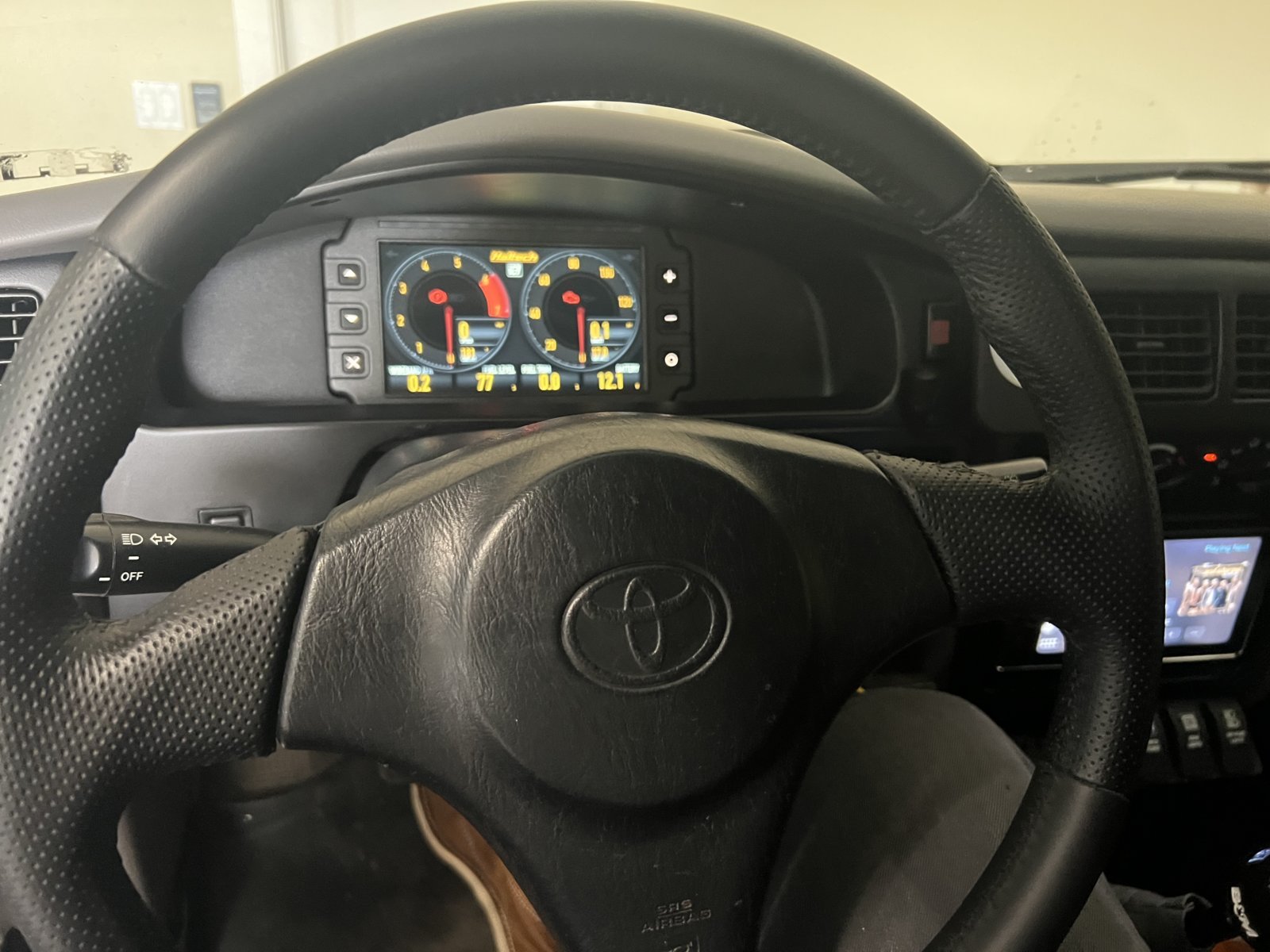

    So I’ve got a technical question for everyone. My son has an ‘02 and he got a steering wheel from pick n pull today from a 4th gen 4Runner. Once we took the steering wheel off the truck, we found the wiring harness is totally different on the two. Does anyone know what steering wheels are interchangeable with the ‘02?

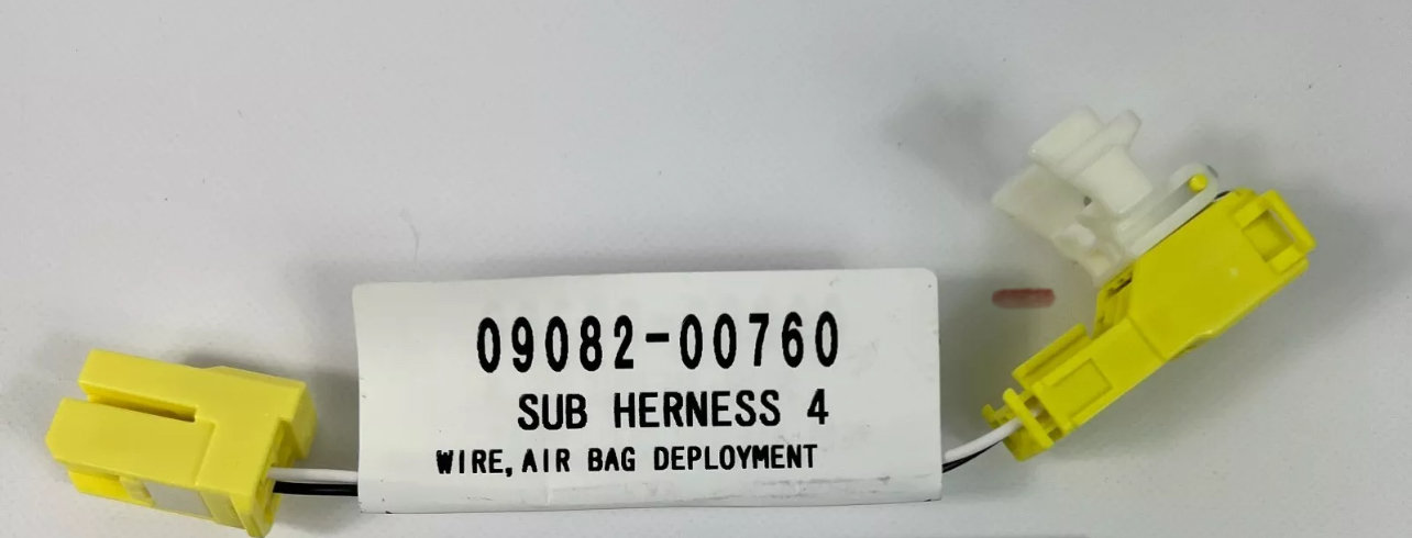

    I’d say most Toyota steering wheels from around that same timeframe will be interchangeable. May need an airbag adapter harness. This one is from a Supra.

    Thanks for the reply! We’ll look to see if there is an airbag adapter harness. Do you happen to know where I could find the adapter?

    You’ll have to check to see if you need it at all, but here it is.

    4th gen 4runner is not the same as a 1st gen tacoma. Be more similar to a 2nd gen tacoma.
    3rd gen 4runners are the ones that are like 1st gen tacomas. Could be the issue.

    Yeah he’s trying to get a newer nicer looking steering wheel to put in his, but the write ups we’ve read seem confusing and some seem sketchy as hell. Some have spliced into the old wiring and made the airbag work. I don’t want anything like that done. Seems like it could be a malfunction just waiting to happen.

    Most Toyota steering wheels will bolt on the difference is mostly with the clock springs and airbags, the wheel from the 4 runner just needs a clock spring with the additional wires I’m not sure which one it is but you can search the info on the forums
