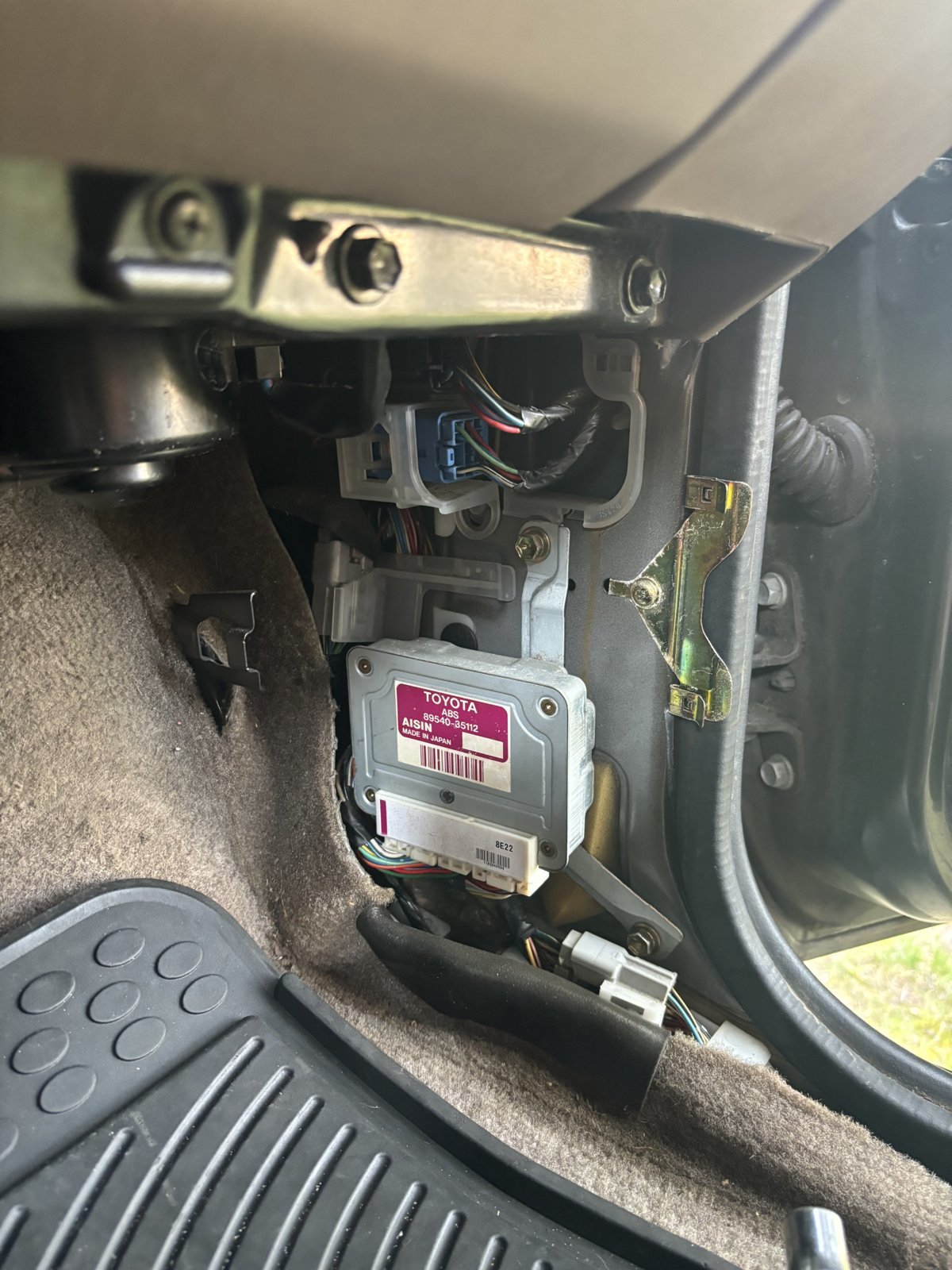

    IMG_2747.jpgIs this the relay? I opened it up and it looks super clean. What did you use to clean it?

    No thats the ABS controller. THe relay is much smaller than that.

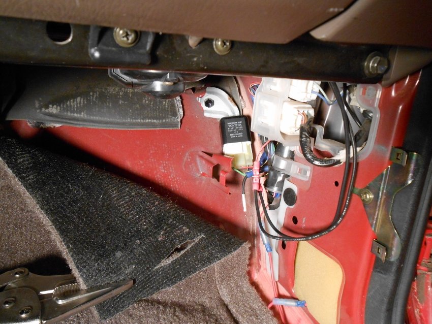

    These aren't my photos but will give you an idea:
    Just pop the black(or could be green) top off and you could see corrosion on it. Just get it off the copper contacts with a wire brush or sand paper.
    Also unplug it before you do any of that. It'll be easier to remove the top with it out of the truck. It is a bit of a pain.
