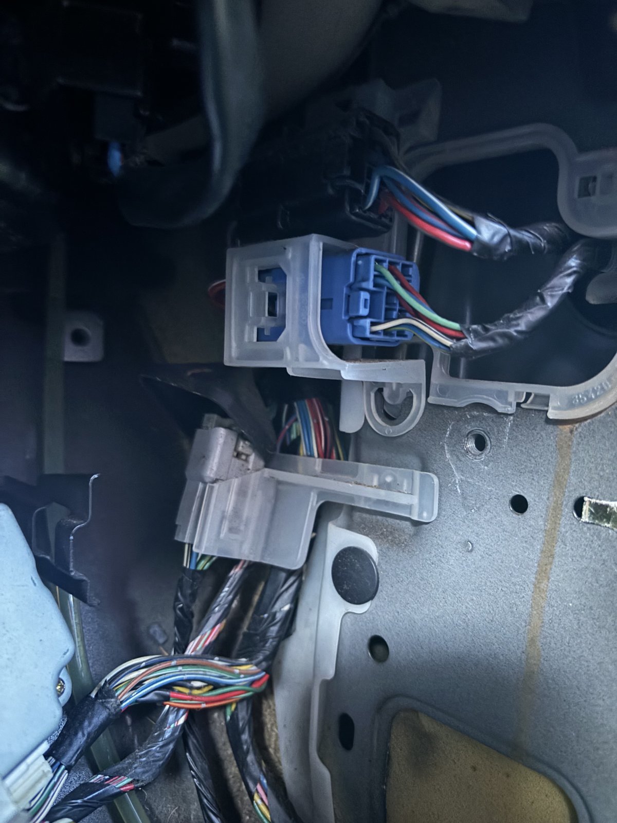

    IMG_2749.jpgThis is everything behind the kick panel. I unbolted the ABS relay to see if it was behind it. I can’t see the relay anywhere. This is frustrating!

    ah do you have a locker? It's probably the gray wire mod which grounds out the switch for the locker so you can engage it in 2wd and not just in 4wd. So i'd leave that alone if so.

    well can't hurt to look under the driver side one. Or in just the fuse box. Possible toyota moved it era to era .

    Nothing in the driver’s side either. I did notice I could hear a small click behind the ignition area when I pushed the 4wd button, so tomorrow we are gonna pull the dash apart and see if it’s what I hear clicking. Thanks for giving me an idea what to look for!

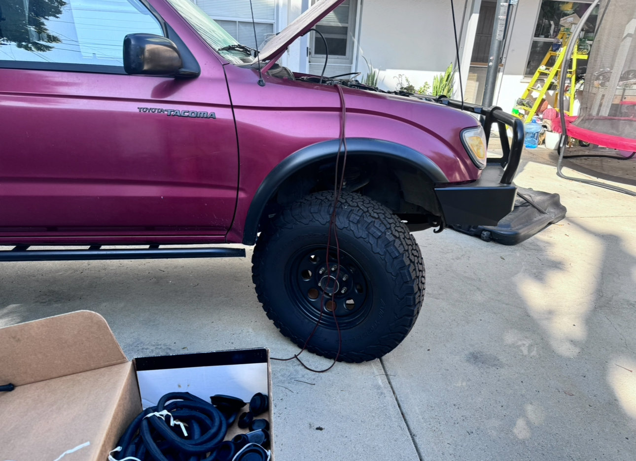

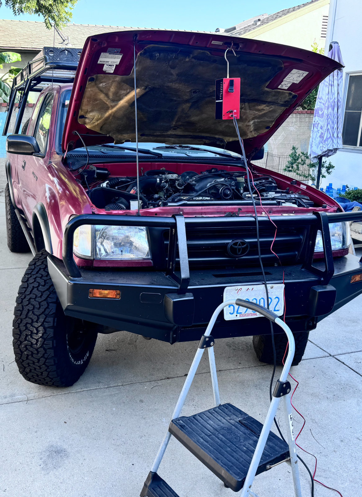

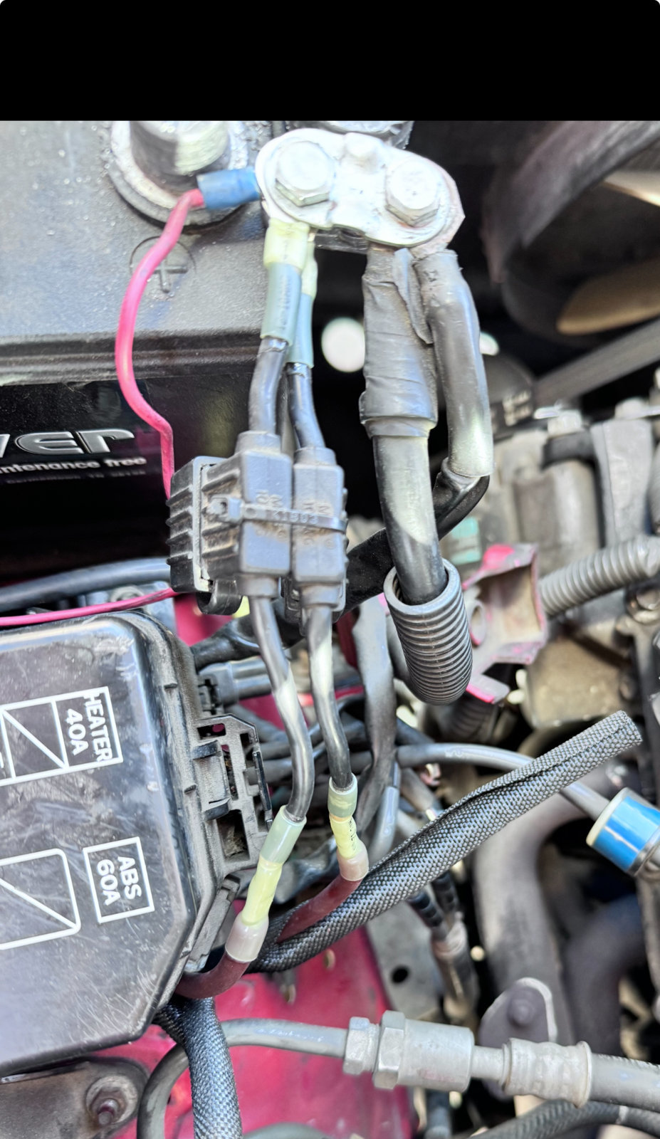

    I’m chasing down a parasitic draw and found a nice drop at the aftermarket amp for my sound system. The connections weren’t great at the battery, so I cut the connections off and replaced them and rerouted them to clean up the look a little. The previous owner used the cheesy(to me… they trap liquids and looks like shit) plastic wire wrap, so I used some leftover wrap I bought for a full rewire I did on my project car. It looks better and doesn’t trap moistures. It looks better and I after I detail the shit out of the engine bay, I’ll be a happier man.
    I did some smoke tests as well, looking for leaks.

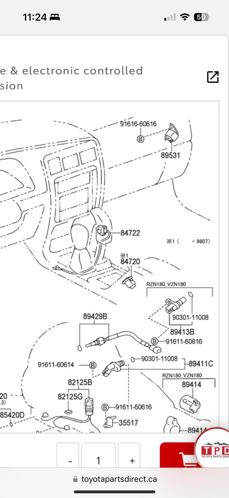

    IMG_2750.pngI found this image last night. Looks like the relay is way up in the dash beside the glovebox. We pulled the glovebox down yesterday, but will look even higher tonight. Do you know if I can take the actuator off the transfer case without having to open the transfer case? It’s a limited model.

    IIRC, not for the first gen. You must disassemble the case to remove the actuator. There’s a shaft that is part of the actuator and goes from the rear case where is mounted and through the entire case.
    maybe someone can come in and correct me.

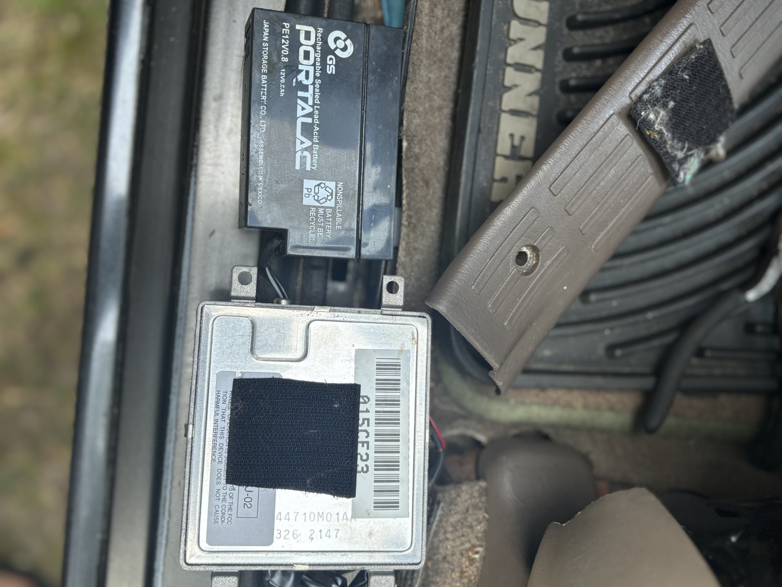

    Based on the battery I assume this might be lojack or something.

    It was wired crappy, so I pulled it and threw it into the garage for now. I figured it must not be too important since it was corroded to the floorboard and the wire broke apart when I started pulling it from under the carpet.
