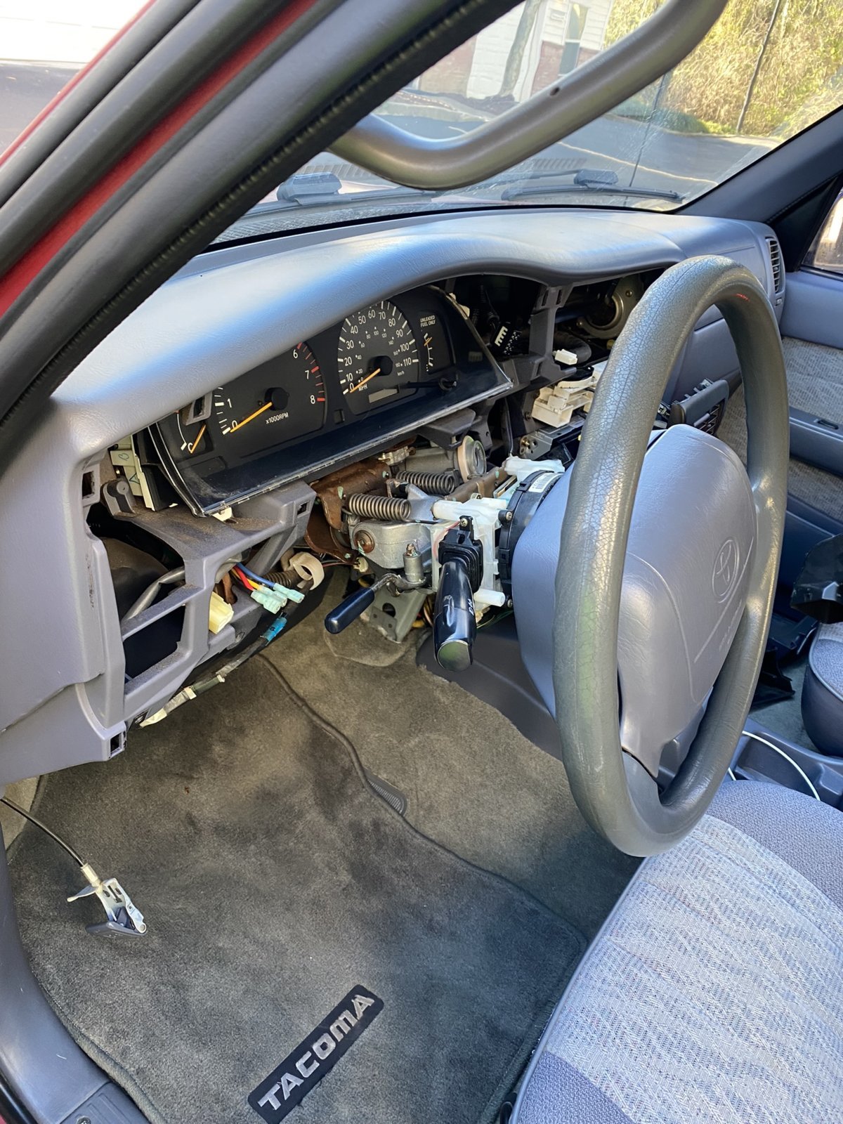

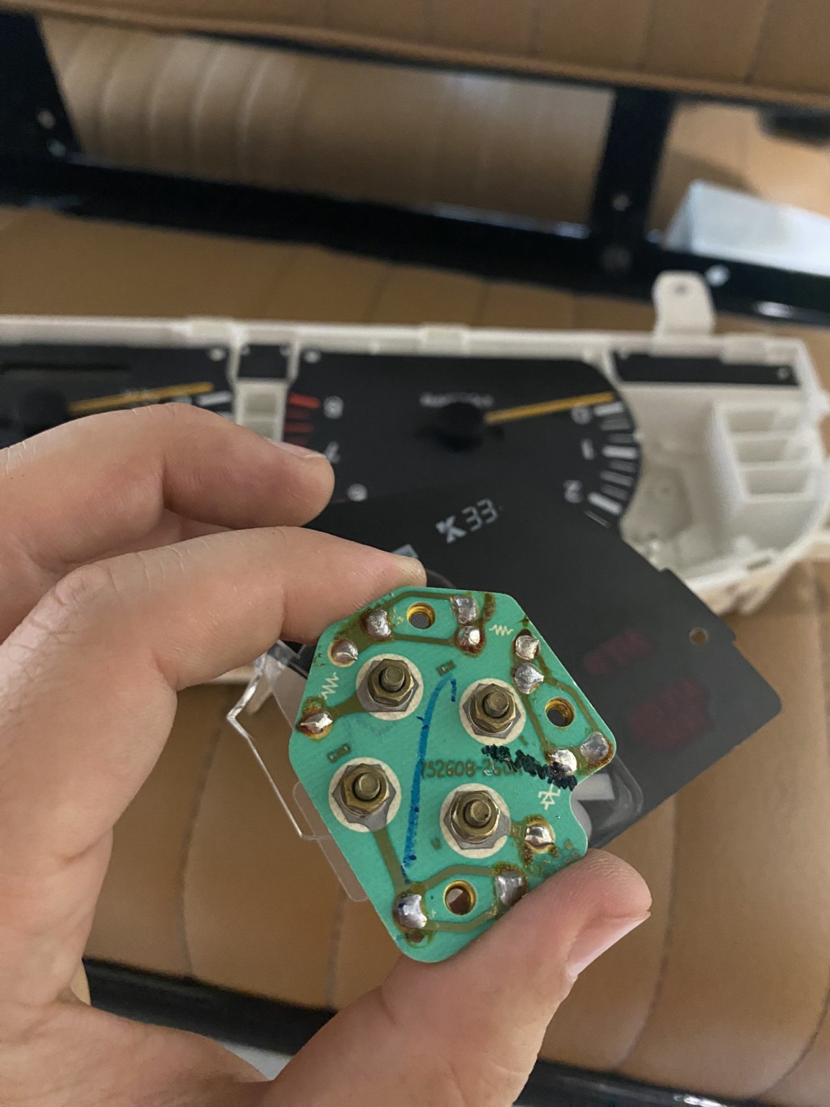

    First time took me about 2hrs, second time maybe 45min start to finish? Just need to remove the radio bezel, trim plate under the steering wheel, steering column trim, and cluster bezel.
    I used 194 LEDs for the back and a pile of 74 LEDs for the warning lights/turn signals. The brights are a different bulb I left the old one in.

    Knew I had some pictures...

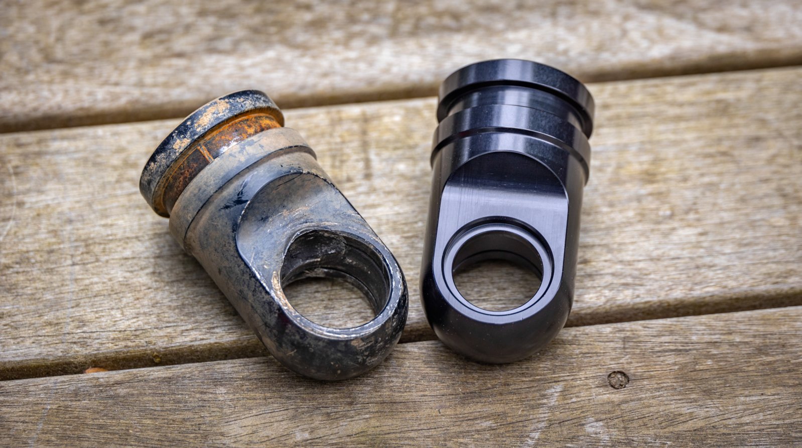

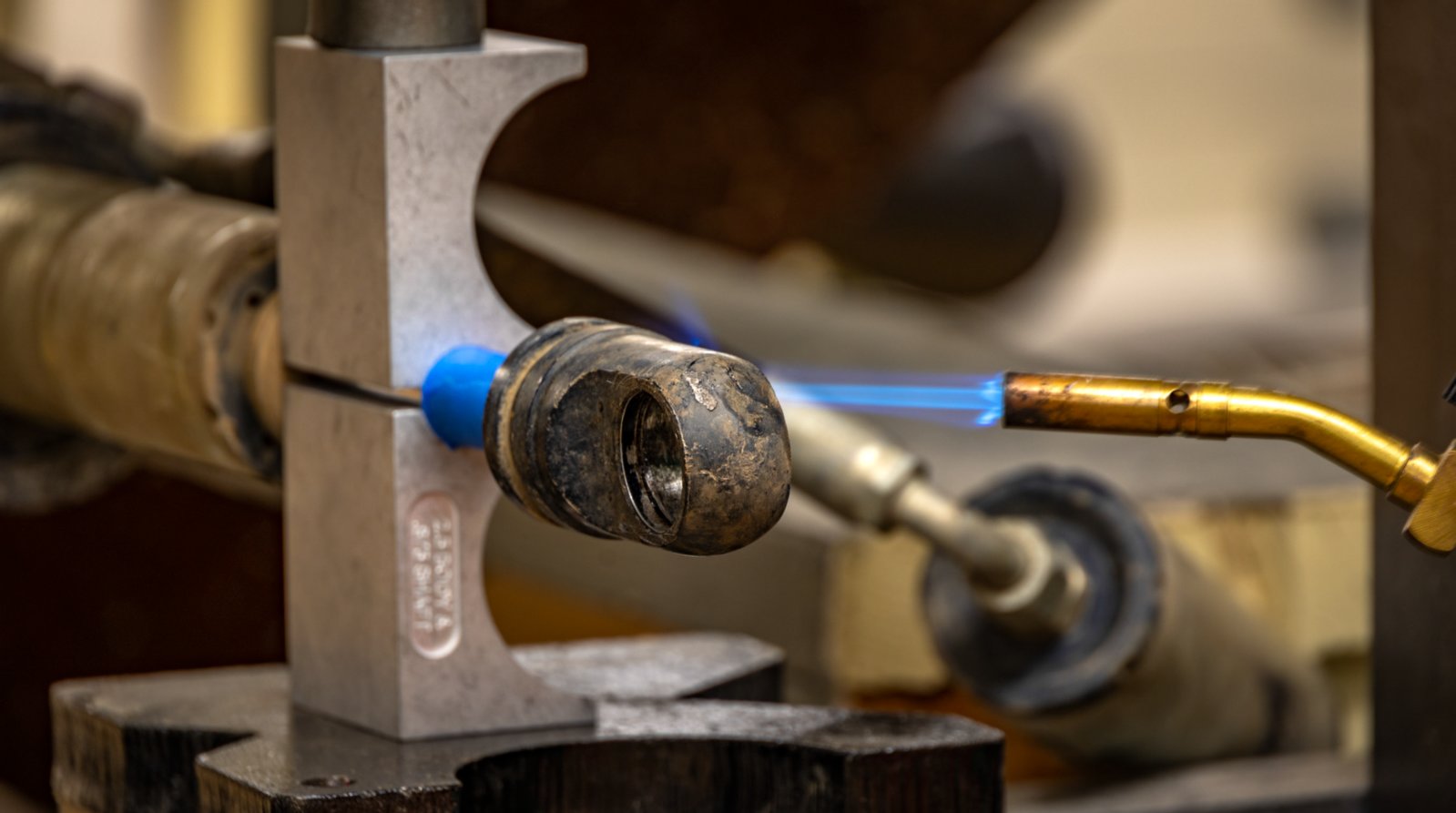

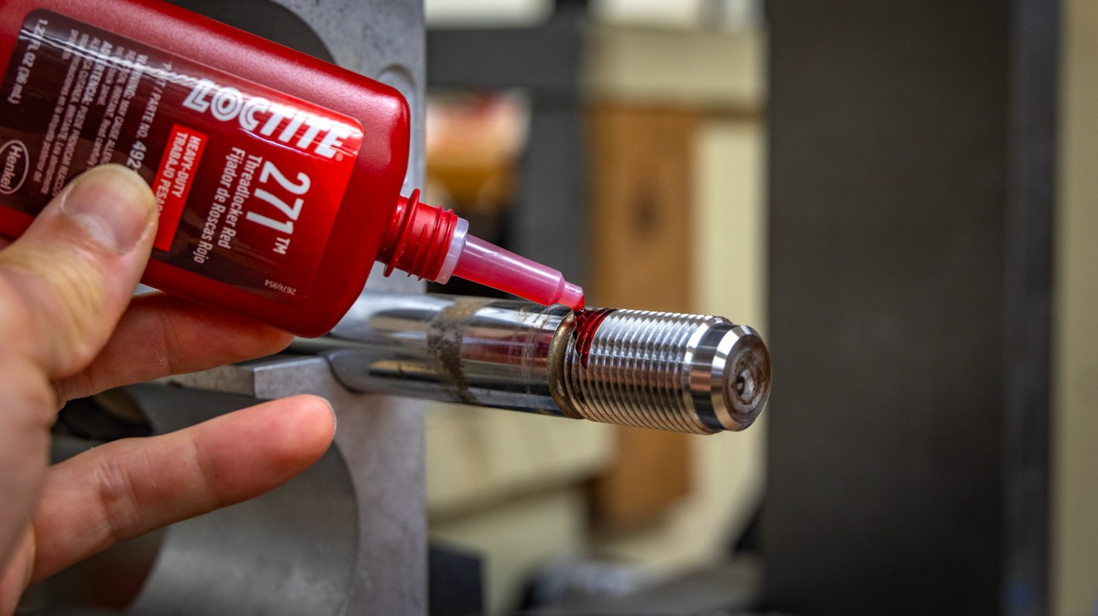

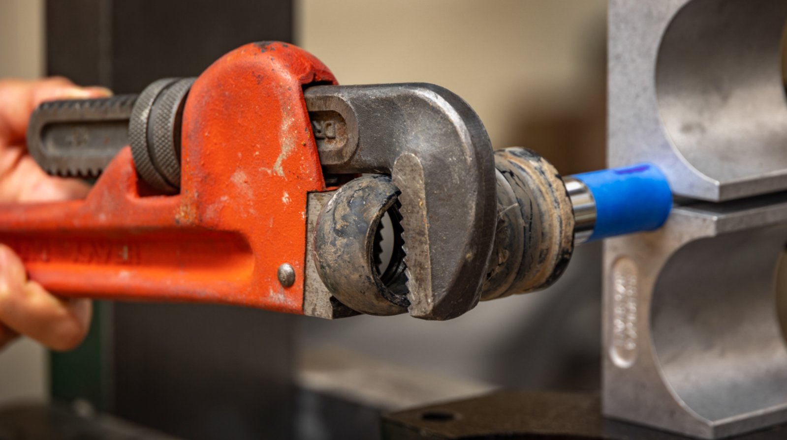

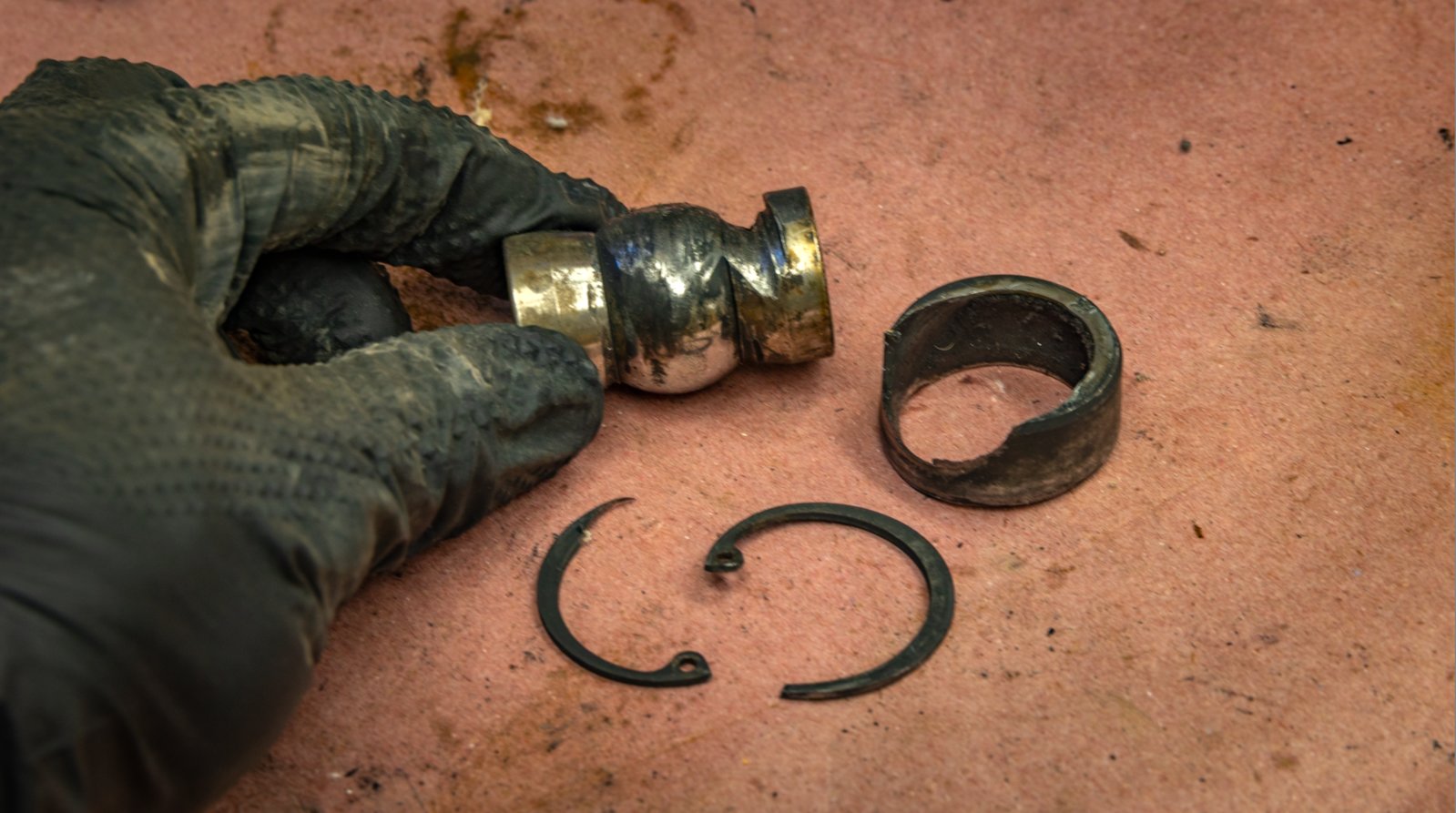

    Got the rod ends replaced. Wasn't too bad at all. ADS sells ($45) a nice fixture tool that makes it easy. And $56 per rod end.
    New rod end only uses one clip; the other side has a shoulder that the spherical bearing sits against.

    Monte made that out to be worse than it is. :p
    Heat is your friend with loctite. Nice work!

    He totally made it out to be impossible. (Which it IS Monte, now sell me your impossible-to-fix Kings for $100. :wink: )
    This was so much easier than almost anything else I've done with the shocks, hahaha. I was relieved though, when the end just screwed off after heating. Plus, this fixture thing is nice for rebuilding shocks too, as it does the shock body too... which means I can get rid of the wooden ones I made.

    awesome! I've read many many horror stories on doing it.
    And i would do that.....if I had them. Idk what @IDtrucks did with them at this point.
    Also dope ADS's tool is so cheap. That's awesme.
