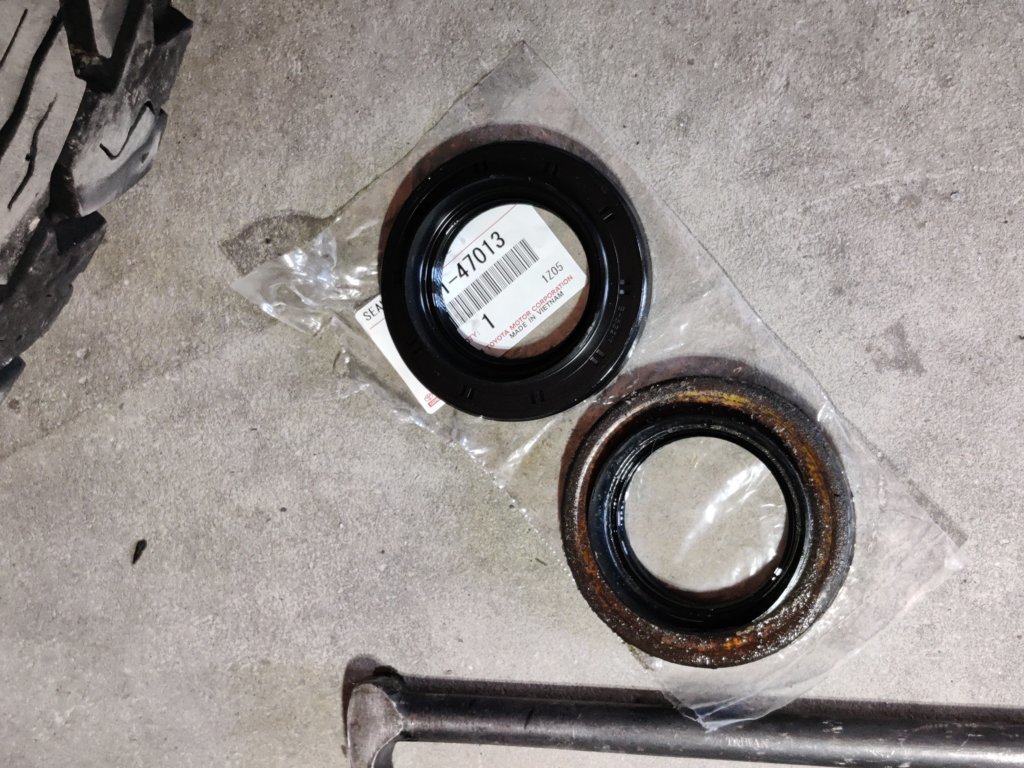

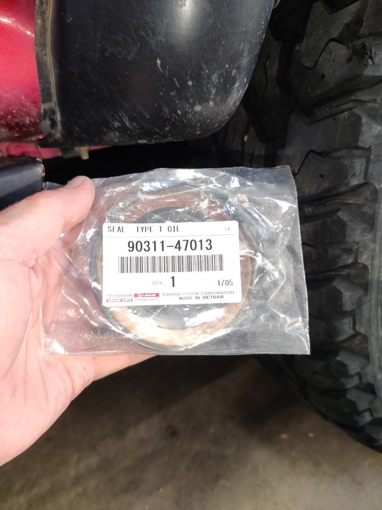

    Anybody got a PN for the front oil seal on the transfer case?
    We developed a couple leaks on our recent trip to Colorado. I'm currently working on the passenger side dif seal. Luckily I had one on hand

    Passenger side dif seal is in and back together. Here's to hoping it seals :fingerscrossed:

    how to you determine depth when installing the passenger side diff seal?
    I’m about to install one.

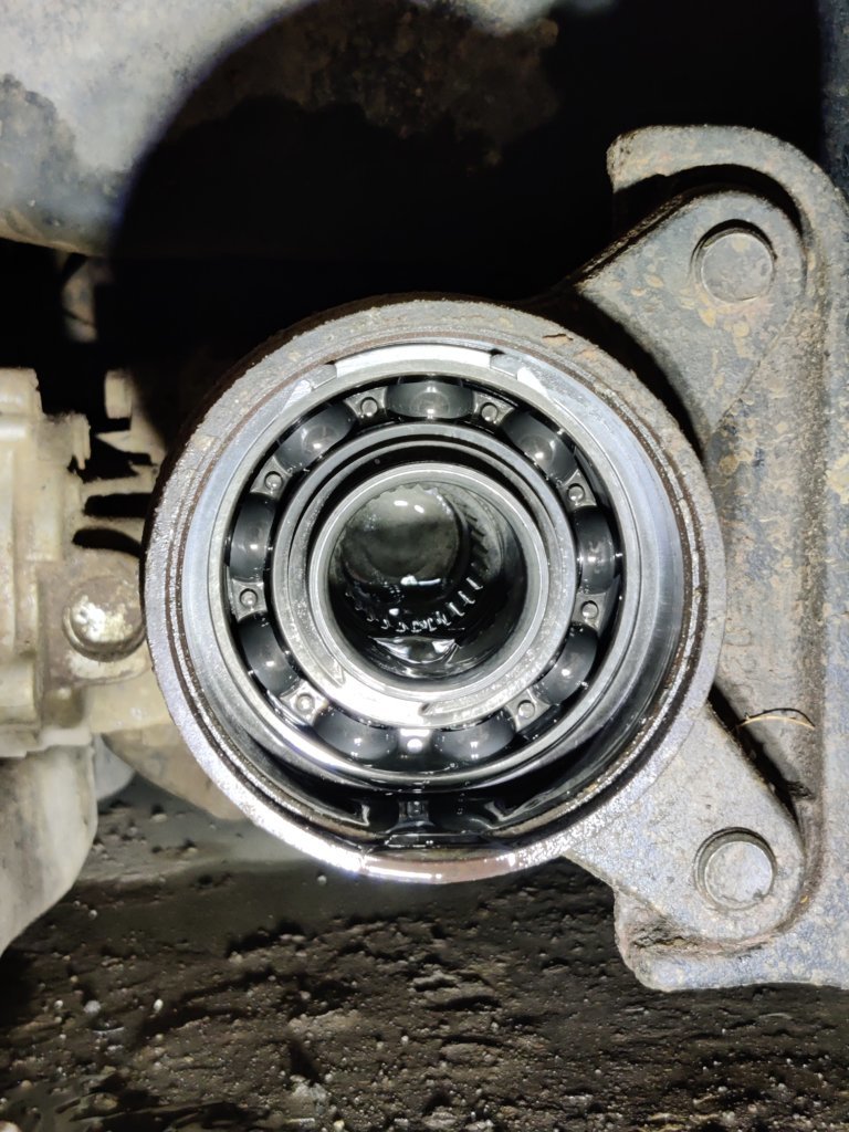

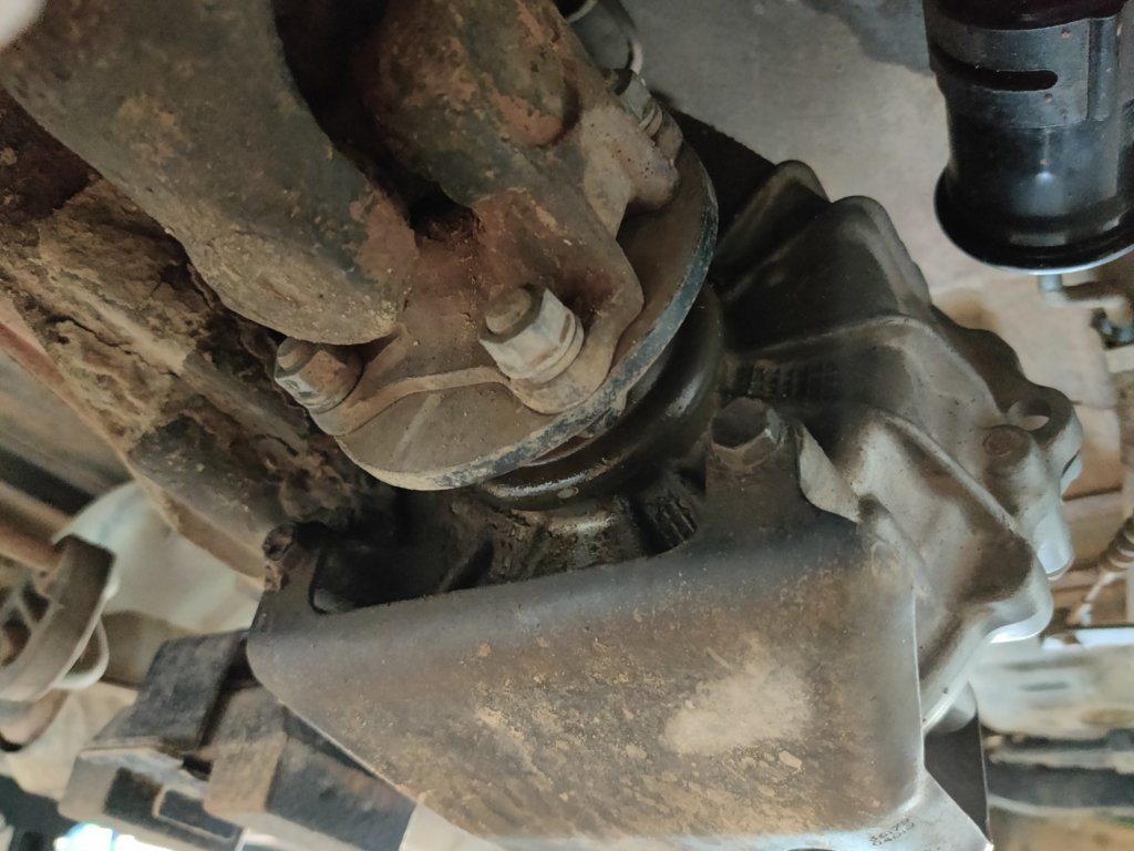

    Just did mine a couple days ago;
    For front drive shaft:
    90311-41012 - Front Output shaft seal <- this is probably the one leaking
    90312-23001 - Companion Flange seal <- while you're in there
    90179-22016 - Companion Flange stake nut
    Rear output shaft seal is 90311-41007

    I'm sure you could reuse the nut, but since you stake it I think its best practice to replace.
    Main output shaft seal:
    Companion flange seal:
    Credits to Timmys video: https://www.youtube.com/watch?v=8YuY6rv1hkE
    Same exact process for either front or rear output shaft.

    Good question, I'm guessing not as far as I put mine because it's still leaking. I was thinking it went too far before I put things back together and I'm pretty sure that's what's up now.
    I could see a line around the inside of the dif where everything was shinny and clean behind where the old seal was and that might help to Judge how far

    I considered using the CV axle to push it in.
    I took the truck to get a burger and it's leaking less now too so maybe it just needed to seat itself a bit. We'll see what happens

    Best way is to get it started and flush then use the CV to push it in.

    I knew it seemed like a good idea for a reason. I ordered another dif seal with the transfer case seals and stake nut so hopefully it will work better next time
