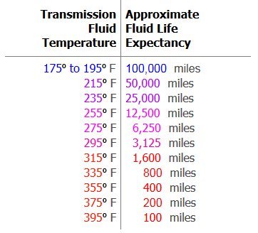

    Technically, any temperature is ruin the fluid hot - the question is how long you’re running it at that temp. Excessive heat is what breaks down hydraulic fluid (ATF, brake fluid, etc) and can cause component failure, but generally only if you operate the fluid beyond its capacity/lifespan at that temp. I have run ATF in excess of 300 degrees, but for a short period of time and with a fluid change shortly thereafter. I’ve never seen the inside of my old auto transmission, but I have it on good authority that it’s in excellent shape ;)
    I find that a yearly drain and fill (5 qts or so) keeps everything in good shape without having to worry too much about operating temperatures.
