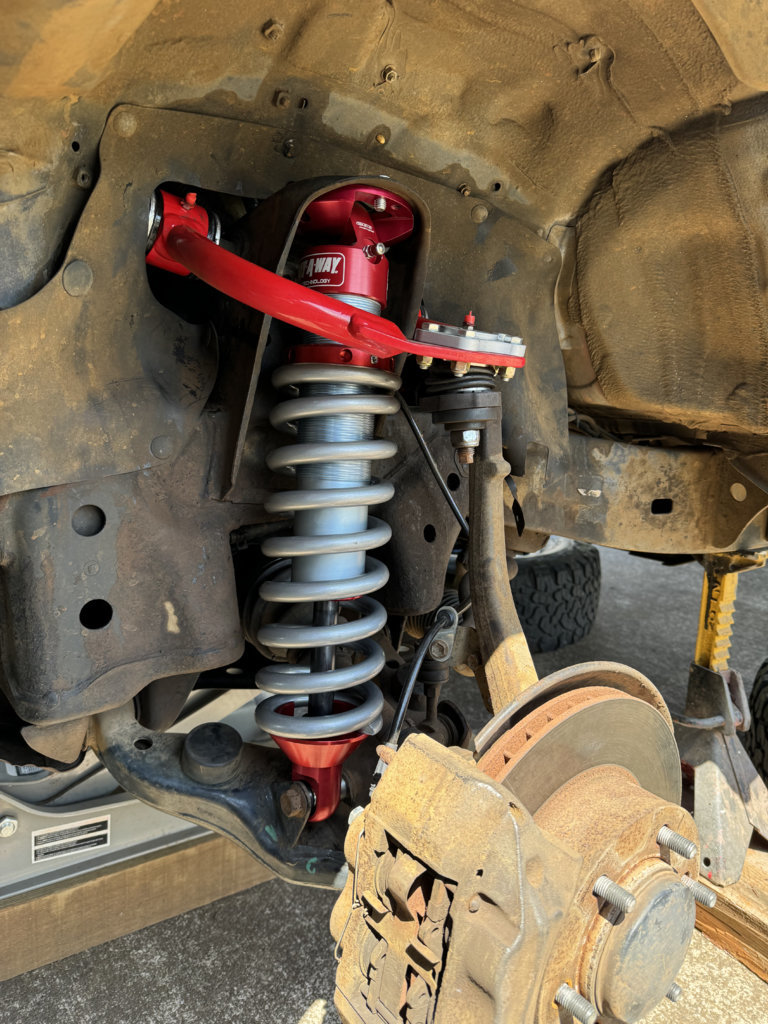

    '00 Imperial Jade Flatty / '14 Spruce Mica, 6MT, Sick
    Both on and offroad. Its helped on-road for me I feel. Sure there's a bit more body roll on tighter curves. But you dont get thrown side to side when hitting a minor dip in the road which i experience with my 2nd gen tacoma. I really only recommend it on trucks with a bit stiffer suspension which usually comes naturally with lifting them.

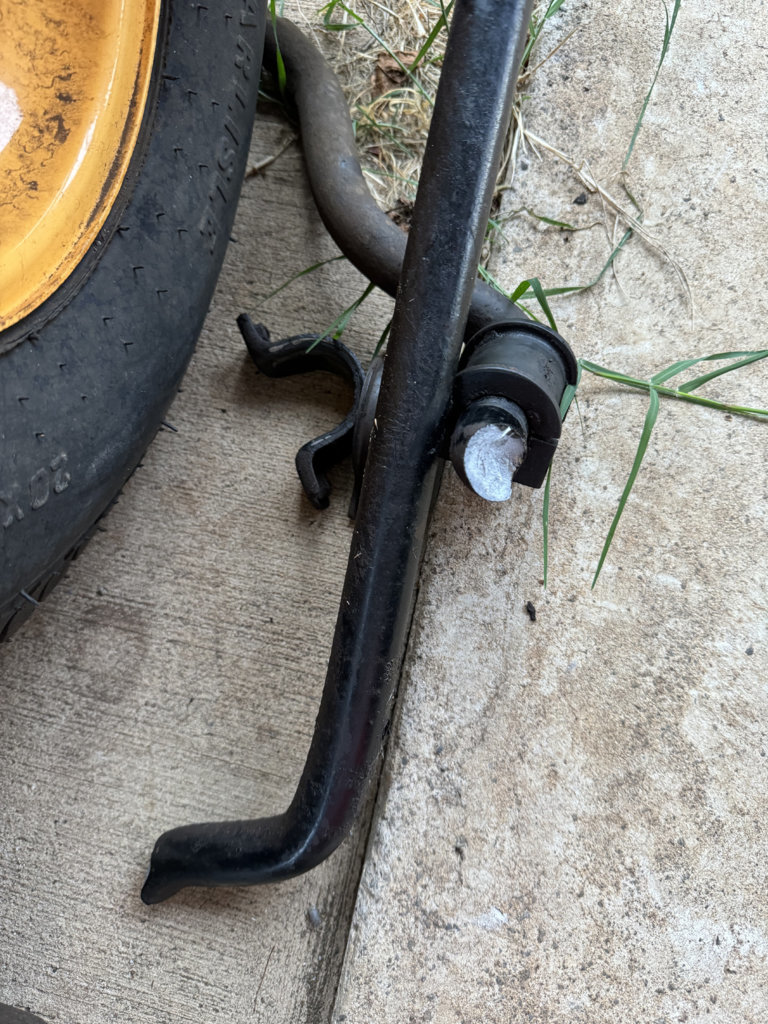

  6. Sep 5, 2024 at 5:07 PM
    Pscdouglas
    Pscdouglas Wish you weren't so awkward Darry.
    Sep 12, 2020
    #340541
    221
    Stu
    Glens Falls, NY
    2004 black Tacoma Xtracab 4WD TRD AT, 2020 Black Tacoma ACLB 4WD Sport MT
    Fatigue? ! I'd expect a non stock suspension setup to be stressing the bar more, and in a different attitude than the stock setup, so that's my vote. Also the location and break plane could tell you more about what happened if you look closely. I know that it is popular opinion that removing it is A-OK. Age? was this the original sway bar or was it replaced at some time?
    MAUIAUSTIN[QUOTED] likes this.
  7. Sep 5, 2024 at 5:12 PM
    m3bassman
    m3bassman Well-Known Member
    Jan 16, 2011
    #49376
    17,138
    Green truck
    The bar is under constant tension so after 25 years for a defect to pop up isn't too unusual. As long as you have upgraded (stiffer) springs you should be ok to remove it. The reason it is there is to force the front end to push and prevent rollovers. Stiffer springs can help with that behavior.
    MAUIAUSTIN likes this.
  8. Sep 5, 2024 at 5:33 PM
    AssQuake
    AssQuake Unknown Member
    Oct 1, 2018
    #268083
    975
    A.J.
    Washington
    4runner
    Made in Japan
    Isn’t the sway bar only under tension when cornering? Regular driving won’t introduce much force. Even if you’re lifted 3” the bar is level on each side but the end links and bushings are pushed to a higher angle not contributing to the twist of the bar
    mrlittlejohn likes this.

  12. Sep 5, 2024 at 7:45 PM
    Phessor
    Phessor Well-Known Member
    Feb 15, 2014
    #123156
    3,599
    I want to see how those work for you.
    I have some 285/75R17's that would require A LOT of trimming, hammering, massaging and spacers to get them to work on these wheels.

  18. Sep 6, 2024 at 1:50 AM
    MAUIAUSTIN
    MAUIAUSTIN Well-Known Member
    May 27, 2016
    #188067
    92
    Austin
    Maui, Hawaii
    1995 Ext. Cab 4x4 SR5
    Sway A Way 2.5 Coilovers JBA Upper Control Arms Old Man Emu CS019R Leaf Springs Old Man Emu Stock Length Greasable Shackles 10" Travel Bilstein 5125 17" DX4 Terrain Wheels 265/70 R17 Falken Wildpeak AT3
    Original from 1995... Your theory makes sense. Just thought it seemed kinda weird but I have been fairly happy with leaving it off beside getting used to the new amount body roll. Its tollerable and as @Blackdawg was suggesting the SAW coilovers do a decent job at mitigating the body roll themselves.
  19. Sep 6, 2024 at 9:02 AM
    CoWj
    CoWj Lost and Found at the same time.
    Feb 8, 2019
    #282309
    850
    Wyatt
    Northern CO
    Burt: 1998 2.7 Regular 5 speed 4x4
    Bilstein 5100, ARB Bumper, Warn VR EVO 8, 34x10.50 Toyo 4.88s ARB Locker
    So far not too bad. I trimmed my ARB for the 33s, and that looks fine so far. It lightly rubs the frame in the same place at full lock driver, which don't bother me. I haven't touched the pinch weld at all, trimmed the plastic in front of it. But I think I will finally have to move the washer fluid res, I think I am catching on that now.
