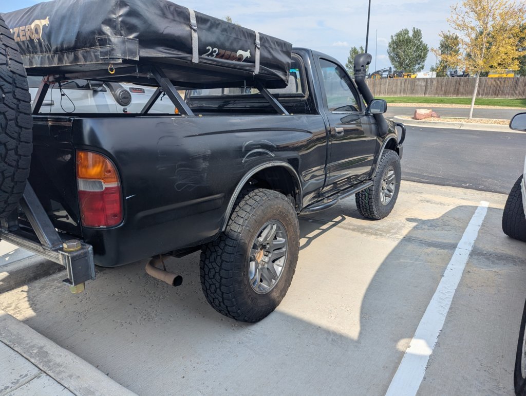

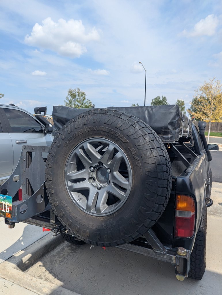

    Still waiting on the center caps to be delivered, so I can cut holes for the locking hub, and paint them to match. But they are installed Toyo 34x10.50R17 ina D load. Some more trimming will be needed. But so far its only catching the washer reservoir like my 33s did. The truck is so much quieter and rides so much smoother. Even being that the 33s were a C load and these are D load. I will try to get some better pictures this weekend.

    It looks like the the truck's original locking hub center caps would fit those wheels. Toyota being Toyota, my original center caps snap right into the 4Runner 5-Star wheels I'm currently running.

    They do snap in, but the edges don't line up correctly. Its was pretty cheap to pick up some aftermarket center caps on ebay that will be painted and installed.

    Looks good!
    How much clearance do you have from wheel to spindle and tire to ball joint?

    About 3/8" or so to the spindle, same as my 33s, then never touched.

    Interesting, I have about a 1/4" clearance from my wheel to the spindle. And only about an 1/8" from the tire to the ball joint on the 285/75R17 Yokohama M/T's.
