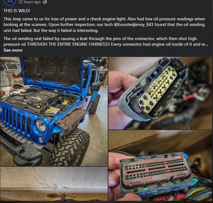

    When you think you have problems, look at the bright side—to resolve them, you need a new PCM and a complete wiring harness.

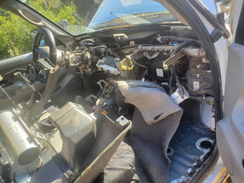

    Took my truck apart to find a water leak. Shot my self in the foot it was where I ran wires the through the passenger side grommet and when water would run off the wiper cowl it would run right on my wires and go in the cab.

    Tore my truck apart to search for a water leak. Found it to be wires I ran through the passenger side grommet, the water would run off the wiper cowl and directly on the wires I ran and the water would drip behind the passenger kick panel. Last November I tore the truck apart to fix a water leak which ended up being cracked old body seam sealer. During that time I removed the carpet and washed it, so I wasn't super happy to hop in the truck to find it smelling like old work boots. I hardly drive this thing anymore its basically now my adventure wheeling truck only.

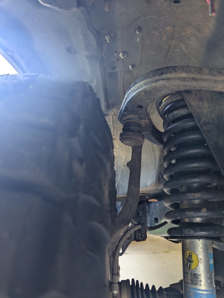

    It's actually closer to 3/4 or 1" away at ride height. Likely to change when I put an aftermarket uca on. At full droop it's 3/8"

    Oof, I hope you replaced the heater core while you were at it :rofl:

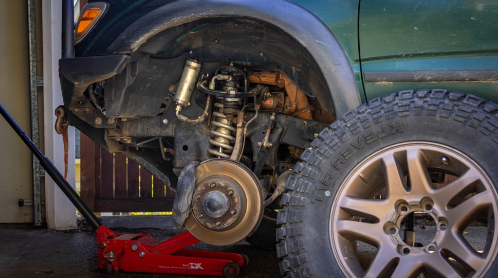

    This is about the same as me (with SPCs). The problem I'm having is that when turning passenger, near full lock, the driver side rubs on the bottom of the resi that's in the wheel well. I forget if you've got resis up there Bob? (I can see you don't, Wyatt.)
    I've got some 0.5" spacers and longer studs on the way, which should solve the problem (I hope) given that this new wheel/tire combo puts the tire 0.35" closer to the frame than the old set. At least, that's mathematically the positioning, since we all know that tire diameter and width vary from manufacturers specs/dimensions quite a bit.

    Oh no. Fixes have been posted for the cowl water leak problem. I had that problem when I got my 1st gen back in 2019.

    I used windshield sealer on both sides just for good measure.

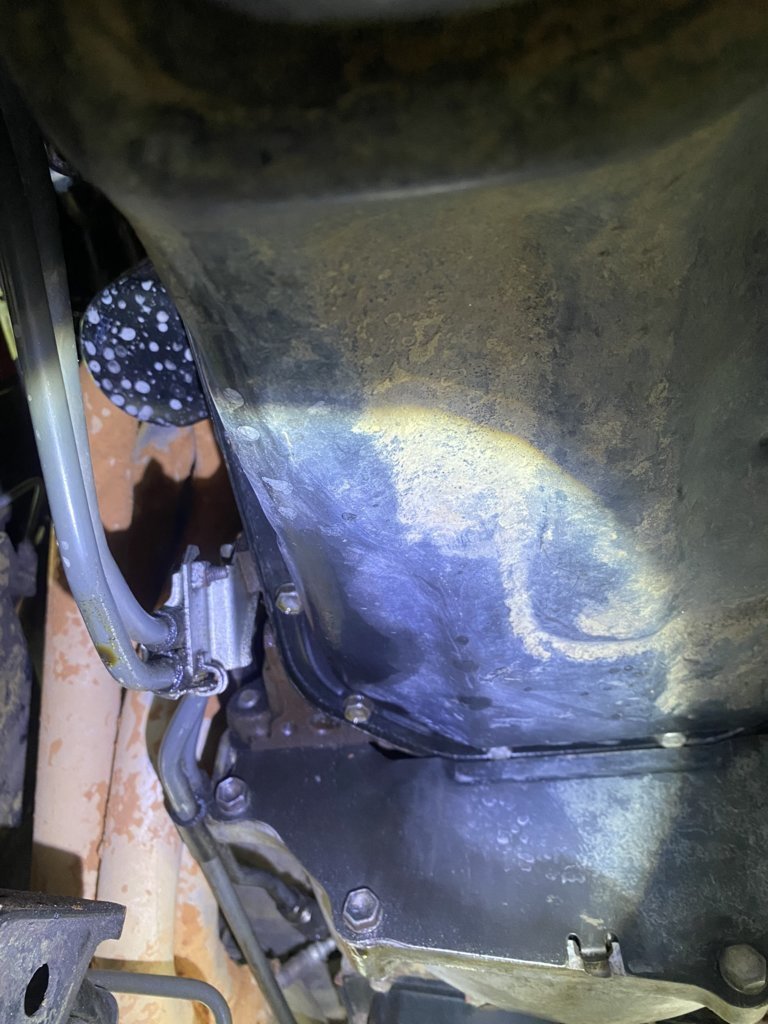

    Went under the truck to get a better idea of the steering rack bushings I'm about to change out and noticed the rear main is leaking again... a month after dumping $800 to a shop to replace it. Back we go! I believe my torque converter is giving me the horrible driveline vibrations so might be a good thing to get in there again.

    $800 is a great price to do a rear main. I guess you get what you pay for...

    OEM parts too :)
    Oh well, I never use shops and this one came pretty highly regarded in the area. I'm sure they'll make it right.
