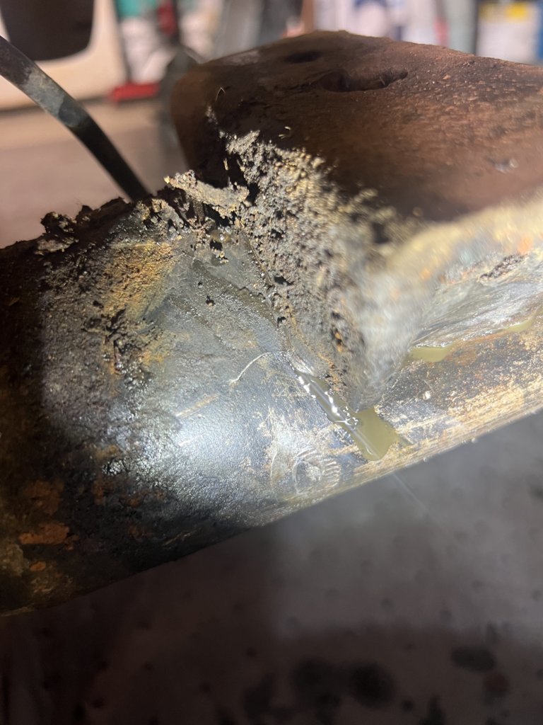

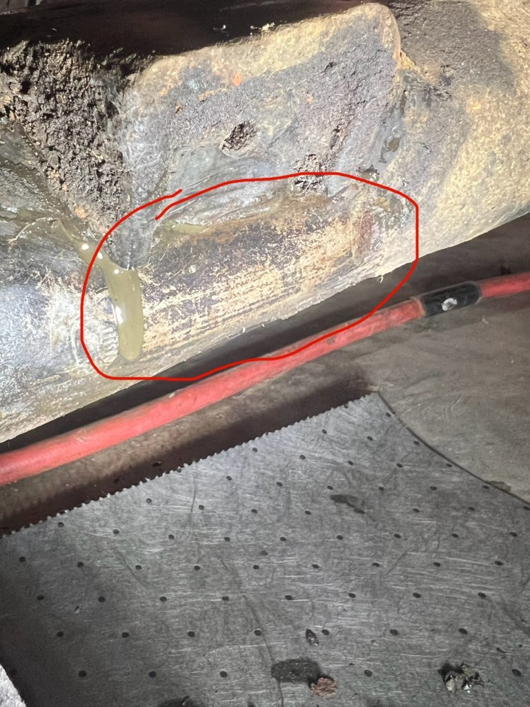

    Found this absolute beauty of an issue while installing axle shims. Looks like that tundra axle / SUA swap is going to happen a little sooner than I thought. IMG_8485.jpg

    I recently bought a T100 with a very similar issue.

    Other than just the crack, the axle tube appears to be crushed. I would also have to remove the spring perch to completely weld up the crack. Not real sure how or when it happened, but here we are.
    LT is in the near future so I might as well go to a full width rear end and the tundra swap seems like the way to go. ‍♂️
