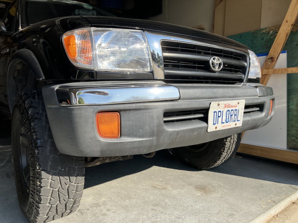

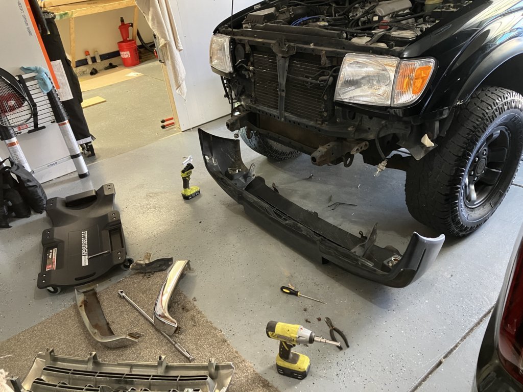

    Finally got that new front bumper cover, blacked out grille and chrome bumper end. Hopefully nothing is too bent up underneath, but I'm sure there's some broken plastic hardware. I guess I'll find out what I still need after I pull the thing off. I wonder if those are in stock at the local dealer. Those doohickeys that fit underneath here.
    I've "restored" the plastic a bunch of times, with whatever plastic restorer and the heatgun method too, but it's just time to go. I'm planning to black out the chrome bumper ends too but not sure if my DIY sand/primer/rattle can method will do the trick. I don't know, maybe just derp them. I bought the 16" 4Runner wheels 3 years ago, pre-derped black, and they have surprisingly held up fine so far.

    That faded bumper comes with the definition right on it

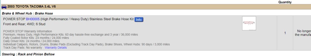

    Received an email stating that the below Power Stop brake lines are subject to a safety recall... I purchased them off rock auto some time ago. Supposedly, they will refund the purchase price + a $250 flat rate for labor.
    Looks like time to go brake hose shopping.

    Sounds like they're being overcautious. No catastrophic failures, no injuries, no serious incidents reported. Over caution is not a bad thing with critical safety equipment, of course, but my interpretation is that as long as you inspect your lines and verify they're not leaking you're okay to keep driving while you figure out what replacements to buy.
    I wish I remembered whether my brake lines were Power Stop branded.
    https://static.nhtsa.gov/odi/rcl/2024/RCLRPT-24E053-1887.PDF

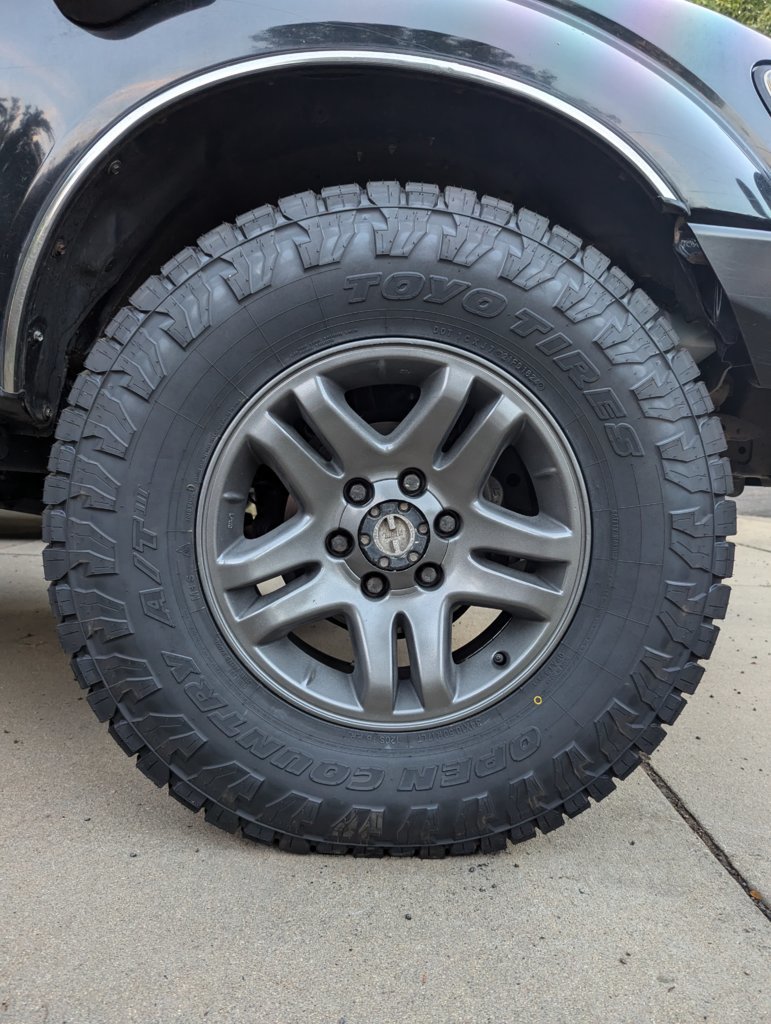

    Finally got everything painted and mounted up with my Tundra 17s
    I cut the center caps to match the locking hub as well.

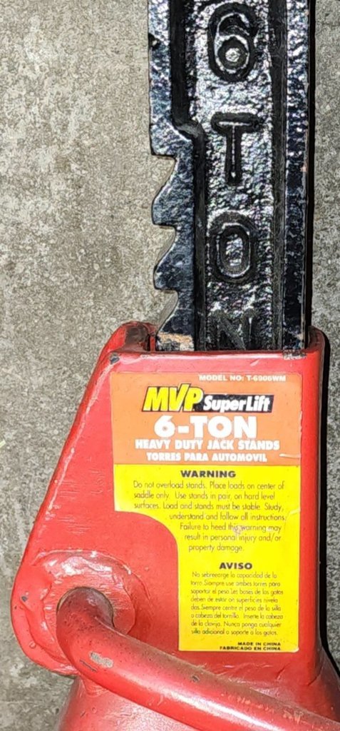

    How do you like those Prolifit jack stands. Was looking at those at home depot as a possibility but still using MVPs that have been solid for this past 20 years. The Prolifts looks basically the same with locking slide pins...

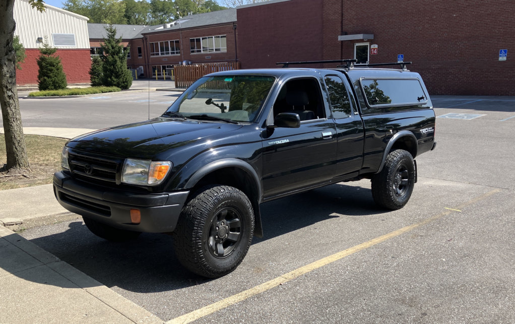

    Finally installed the replacement bumper cover, grille, and new bumper inserts. Ended up being a PITA since the bumper supports were cracked (not rusty) and maybe tweaked a bit from some old minor hit to the bumper. The passenger side insert was a hassle, and it's still kinda crooked. I guess it wouldn't have hurt to buy all new parts. There is really no structure to speak of under there, just that light stamped "bumper" unless there was something missing since before I bought it.
    I derped the chrome inserts about 5 coats, maybe an hour between each one. Grille badge too, but not sure if I like that, might peel it off. The new grille is black, but the truck isn't entirely murdered out. Little bits of chrome here and there like the lettering and the door handles. Still not bad for 25 year old DD.

    They’re solid... They feel heavy duty, the welds are nice and they have a nicely fitting safety pin. I just bought them though, so we’ll see how they fair over the years.

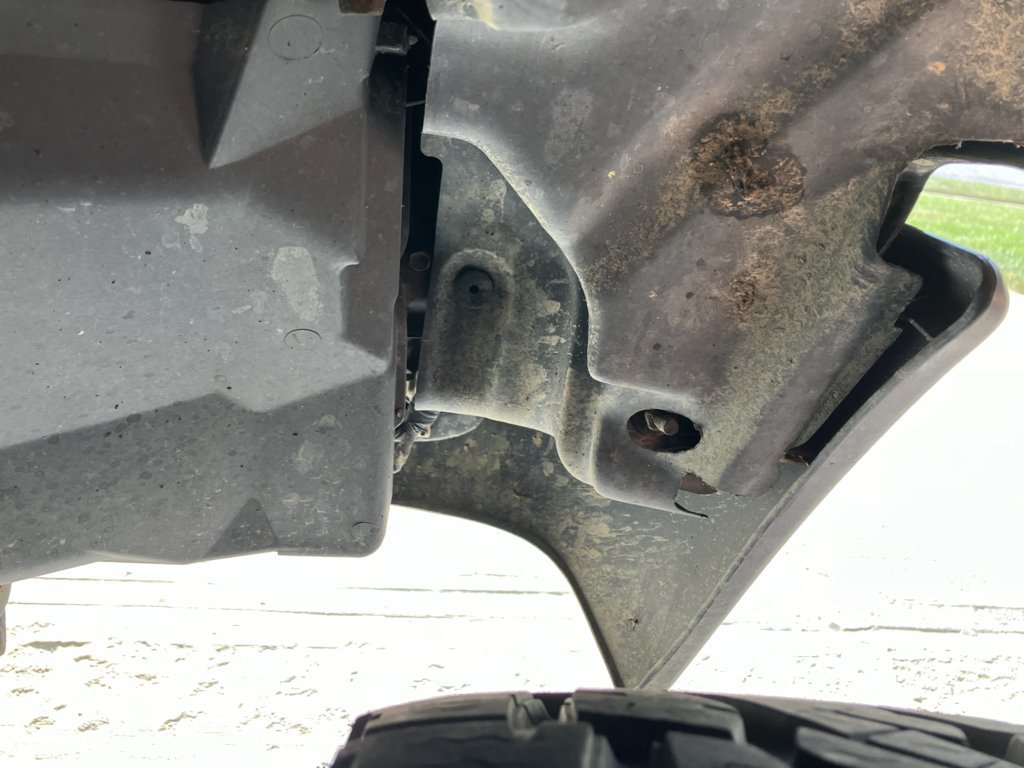

    Checked clearance on the 34s before a trip this weekend.
    No rubbing in the front now that the washer fluid reservoir has been replaced. No pinch weld mods yet which is rad. I have a bit over 1/2" from it.
    However I'm rubbing the front of the rear wheel well, so I think I need to relocate the axle back about 1/2-3/4" to center it up when tucked up in there.
