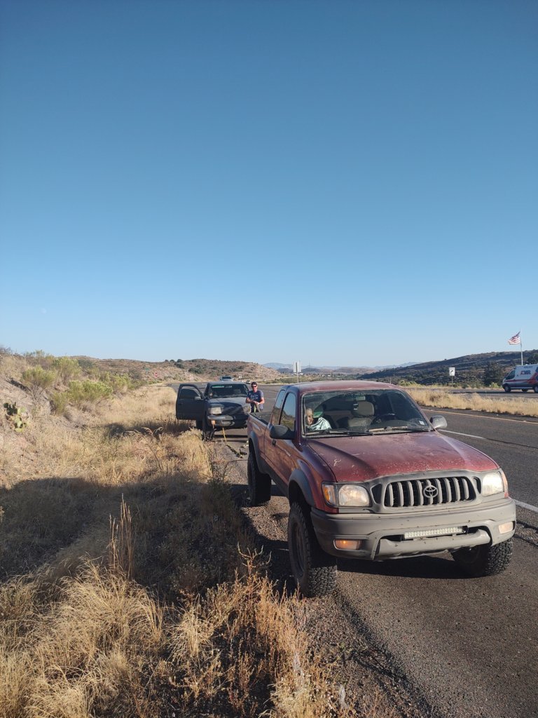

    Also towed my buddy's '98 home with a tow strap after his head gasket seemingly popped on the way back from Crown King

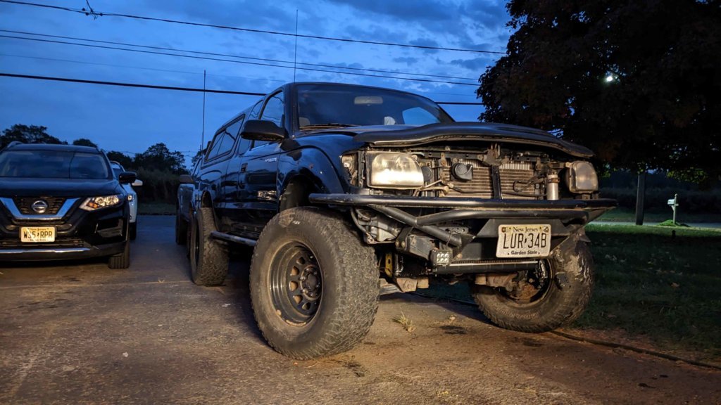

    Took it out for a drive today for the first time. Performed ok but started surging at idle a few mins in. Also still has high idle ~2000 rpm. I cleaned out the IAC and replaced the gasket before installing the throttle body but then took it back out today and checked resistance and it wasnt even remotely in range so I think my IAC valve is shot. Ordered a cheap one on Amazon cuz OEM is $400 or something insane. Will see how it works.

    Installed new IAC, idle is at about 1100, so seems to have fixed it. Took it for a real test drive and perfomed ok, still some minor idling issues but mostly settled down. I think after a drive cycle itll balance out. Brakes are super soft now though, I accidentally let the master cylinder drain out when I removed the drivers side caliper so I think I might have to pull it and bench bleed :annoyed:

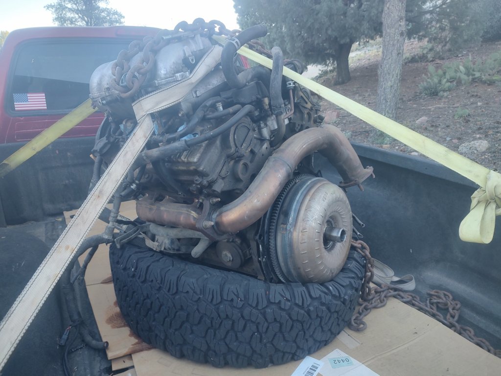

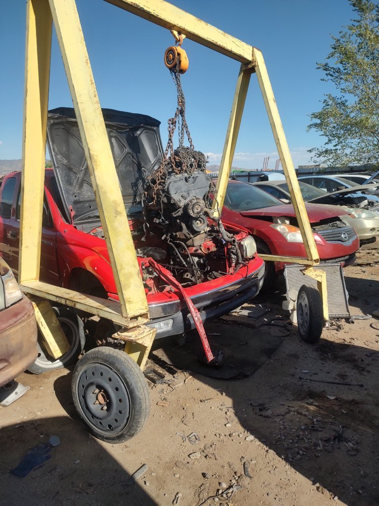

    So I went and pulled a 5vz for my buddy to throw in his '98 with a blown head gasket. First time pulling a motor and managed to get it out in just over 5 hours. Pretty satisfied with that
    My Alcans really handle the weight of an engine nicely though:

    One question for everyone:
    Is it normal for the torque converter to be pretty well stuck on the rear of the motor? I have no experience with automatic transmissions.

  6. Oct 14, 2024 at 6:10 PM
    m3bassman
    m3bassman Well-Known Member
    Jan 16, 2011
    #49376
    17,138
    Green truck
    If it was stuck to the front you'd have bigger problems.

  7. Oct 14, 2024 at 8:28 PM
    Red_03Taco
    Red_03Taco Well-Known Member
    Nov 2, 2021
    #381170
    1,758
    Jerad
    2003 Tacoma Xtra Cab 4WD
    Lol, I don't know much about automatic transmissions, but I do realize that the rear is better than the front.
    I guess my question is will it come off simply enough with a little encouragement from a pry bar?

  8. Oct 14, 2024 at 9:01 PM
    Jixerboy96
    Jixerboy96 Member
    Sep 1, 2024
    #456288
    11
    DO NOT use a prybar! Yes that’s normal since you didn’t unbolt flywheel from the torque converter. There are 6bolts holding it on and one of them is painted black, mine looked like very dark green.The painted one has a shoulder that helps with the alignment of the flywheel to torque converter and is supposed to be put on first during the assembly. Your going to need to turn the crank one full revolution to be able to access all of the bolts. You will see 1 maybe 2 bolts , turn the crank a bit and another one will show up, repeat the process until all 6 are off.

  9. Oct 14, 2024 at 9:25 PM
    Red_03Taco
    Nov 2, 2021
    #381170
    1,758
    Jerad
    Thank you so much!
    My dumbass was thinking prybar lol

  11. Oct 14, 2024 at 11:05 PM
    Digiratus
    Digiratus Adventurer
    Mar 26, 2010
    #34006
    23,815
    Roaming the PNW
    The RedHead
    2002 XtraCab TRD 4x4 SCv6 AutoTrans With Lots of Mods ADS COs w/Compression Adjusters Camburg Uniball UCAs Whiteline Lower Control Arm Bushings Kartek 7" Limit Straps Plastics Guy Front Bumpstops Total Chaos Sprindle Gussets Custom Alcan Springs +800 lbs +3" ADS 10" Stroke Triple Bypass w/Resi Rear Shocks Custom Rear Shock Relocate All-Pro U-bolt Flip w/Timbren Bumpstops 4.88 Nitro Gears ARB Front Locker ARB Twin Compressor Black 17x8 Konig Countersteer Type X 285/70r17 Falken A/T3w Gunmetal 16x8 SCS Ray10s 255/85r16 Maxxis Bighorns Limited Edition (Relentless) Elite Front Bumper Smittybilt X2O 10K Winch Diode Dynamics SS3 Sport Selective Yellow Fog Lights in the Bumper Diode Dynamics SS3 Pro 4,000 Kelvin SAE Driving Lights with Clear Lenses on the Bumper Morimoto D2S Projectors XB35 Ballasts + 4300K Bulbs Badland Sliders FrankenFab Tire Carrier Swingout bumper w/kitchen BudBuilt Front & Bellypan Skids BAMF Rear Diff Skid Dometic CFX 55im Fridge/Freezer Alpha II Hardshell RTT Badland Custom Bed Rack Denso 210-0461 105 amp alternator Dual Northstar 24F AGM batteries BlueSea 7622 ML-ACR Battery controller Peak DBI Dual Battery Voltage Monitor Haltech IC-7 Display with Mako Dash Insert Haltech Elite 2500 Standalone ECU Magnuson MP62 Supercharger w/URD 2.2" Pulley Doug Thorley Headers Denso 650cc Fuel Injectors Aeromotive Stealth 340 Fuel Pump TransGo A340F Reprogramming Shift Kit OEM ECU Delete Full A340F Trans Control with the Haltech 2500 ECU 2.5" Magnaflow Hi-Flow CAT Magnaflow 18" Muffler w/Vibrant Resonator 13WL Brake Calipers with OEM Rotors & Pads Braided Steel Brake Lines Kenwood TM-71A Dual Band Ham Radio STI-CO Flex Whip VFH/UHF 1/4 Wave Antenna Midland MTX275 GMRS Radio w/Roof Mount Antenna Pioneer DEH-P9400BH HU Alpine Amps & Type R components (F) and coaxials (R) Wet Okole Seat Covers Weathertech Digital Liners Deck Plate Mod 1" Diff Drop Carrier Bearing Drop
    Access to the bolts mentioned will be from below the back of the engine. When the trans is still mounted, the bolts are accessed thru a small inspection plate. I suspect you had to remove that plate cover when you separated the engine from the trans.

  13. Oct 15, 2024 at 5:41 AM
    Red_03Taco
    Nov 2, 2021
    #381170
    1,758
    Jerad
    No the truck this motor is intended to go into is a manual transmission truck. So did I screw anything up by pulling this motor with the torque converter on it still?
  14. Oct 15, 2024 at 9:07 AM
    Digiratus
    Mar 26, 2010
    #34006
    23,815
    Roaming the PNW
    The RedHead
    Seems unlikely. The TC and the flex plate it is mounted to will be of no use to you. You will have to reuse the old flywheel from the original engine.
  15. Oct 15, 2024 at 9:43 AM
    Red_03Taco
    Nov 2, 2021
    #381170
    1,758
    Jerad
    Okay great. That's good news. We were planning on reusing quite a bit from the old engine, considering the truck with the blown head gasket is a '98 (4wd 5spd) and the donor vehicle was a 2004 Prerunner (w/auto trans obviously).
    Would you recommend a new pilot bearing, or can the old one be transferred over from the '98's motor?
  16. Oct 15, 2024 at 9:45 AM
    Speedytech7
    Feb 20, 2014
    #123587
    58,100
    FCQM+VG Cheney, Washington
    It's less Tacoma and more mod
    Definitely new, they're like $10 for a good Nachi one
  17. Oct 15, 2024 at 9:50 AM
    Digiratus
    Mar 26, 2010
    #34006
    23,815
    Roaming the PNW
    The RedHead
    Since you are in there, now is the time to do all that stuff. Don't forget a new rear main engine crankshaft seal too.
  18. Oct 15, 2024 at 10:11 AM
    Red_03Taco
    Nov 2, 2021
    #381170
    1,758
    Jerad
    Okay roger that. We're also planning on doing valve cover gaskets, spark plug tube seals, rear main seal, new PCV valve, new motor mounts and likely a new clutch. Most everything else we're thinking can be reused from the motor that blew (earlier style throttle body, plug wires, coils), and accessories (PS Pump, Alternator, AC Compressor, Fan).

  19. Oct 15, 2024 at 10:54 AM
    drr
    drr Primary Prognosticator
    Oct 17, 2013
    #114681
    2,740
    Dan
    Seattle-ish
    02 4WD Tacoma
    Are you swapping over the entire wiring harness from the original engine? I think you’ll need to in order to use the old style TB (good idea btw), and it will keep you from having to dork around with the auto trans plugs and all that.
