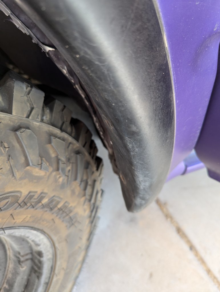

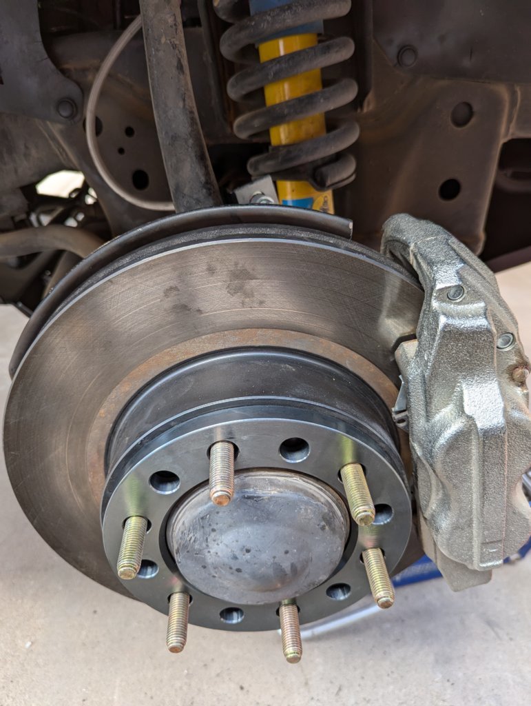

    Took off the 1 inch wheel spacers that I had put on to clear the Tundra brakes. They were causing tire rub issues. Left the backs completely off, fronts I switched to 1/2 spacers and they clear the brakes fine. Had to put in extended studs, which actually wasn't to hard a job with a big honkin impact. Gained me some extra clearance that I really need.

    Dont these make the wheels lug centric now instead of hub centric?

    Essentially, yes. But when I drove it there was zero difference.
    It should also be noted that I don't have stock wheels and need to use tapered seat lug nuts.

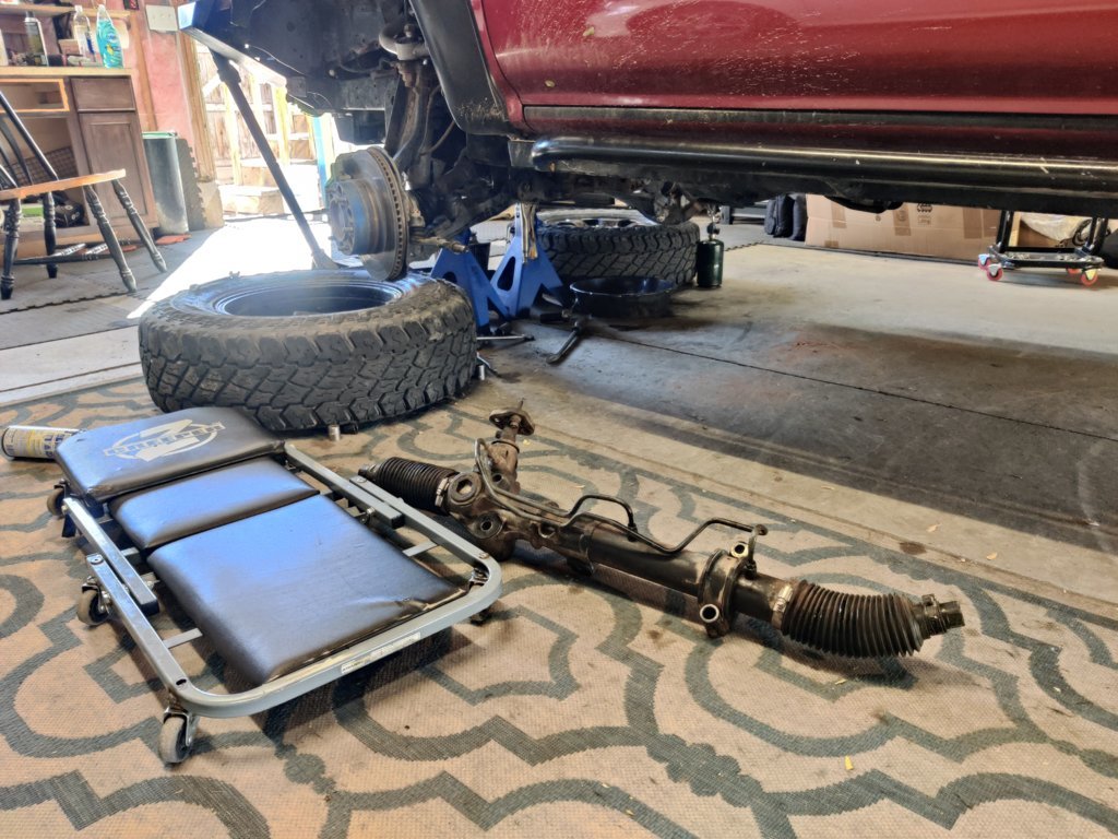

    IMG_20241020_141420.jpgstarted the ruff job of replacing the steering rack and cleaning out the reservoir screen.
    I've got the rack ready to come off except the high pressure line into the rack doesn't want to come off.
    I broke the nut lose from the rack but the nut doesn't want to spin without twisting the hose. I sprayed it with a bunch of WD-40 and even tried to hit it with a little torch action but didn't want to get crazy with that.
    Side note the passenger side boot had about 7 gallons of water in there.
    Canadian Caber and Tour991 like this.

    Ended up putting a pair of vice grips on the crimped portion of the high pressure hose to hold it in place and was able to get it off

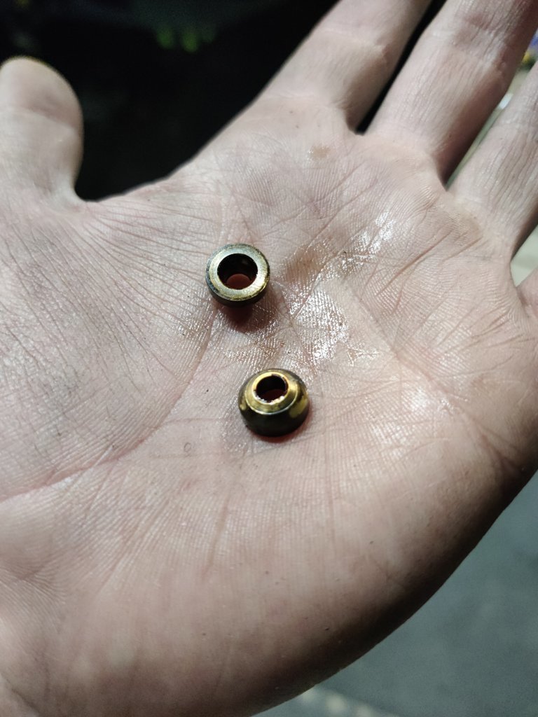

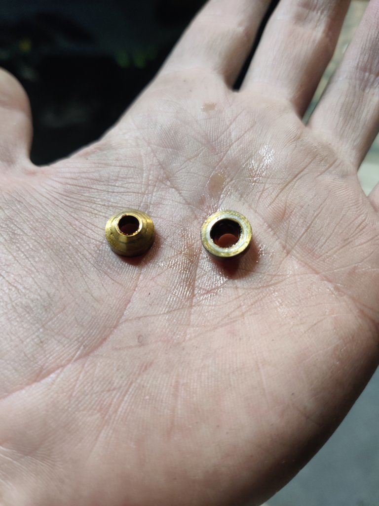

    Got the rack all buttoned back up and eyeballed the alignment, went to put my oil catch can away and found 2 small brass pieces and I have no idea where they came from.
    Anyone know what these came from? My first thought are some sort of reducer or crush gasket for the hard lines but I'm at a loss with that one.
  14. Oct 22, 2024 at 6:48 PM
    m3bassman
    m3bassman Well-Known Member
    Jan 16, 2011
    #49376
    17,138
    Green truck
    That's a shitty feeling. It was part of the catch can?
  15. Oct 22, 2024 at 7:42 PM
    unstpible
    unstpible Well-Known Member
    Aug 16, 2012
    #84909
    3,844
    Derek
    Cedar City, Utah
    03 4x4 boosted V6 Auto 341k miles
    CX Racing Turbo kit. TransGo shift kit. All Pro Apex bumper and skids. Smittybilt XRC 9.5 winch. All Pro Upper control arm's. Bilstein 6112's with 600lb coils. Eimkeith's lower control arm reinforcement plates. Perry Parts bump stops. All Pro spindle gussets and alignment cam tabs. All Pro standard 3" leaf springs. Bilstein 5125's rear. Extended rear brake lines. Rear diff breather relocation. MagnaFlow catback with resonator. Bluetooth stereo. Memphis 6x9 door speakers. Diode Dynamics SS3 Pro Amber fog lights. Single piece headlights. aftermarket grille. Anzo taillights. LED 3rd brake light. 4runner sunglass holder and dome lights. Master Tailgaters rear view mirror with 3 directional cameras, G shock sensors, and anti theft system. Honda windshield washer nozzles. Stubby antenna. Scan Guage II. 2nd Gen Snowflake wheels powder coated black. Cooper Discoverer ST Maxx 235-75/16 Denso 210-0461 105 amp alternator. Speedytech7's big wire harness upgrade. Aeromotive 340 fuel pump. Haltech Elite 2500. Tacomaworld sticker. Tundra brakes with Adventure Taco's hardline kit
    No it was in the bucket I used to collect the power steering fluid. Sorry for the confusion.
  16. Oct 22, 2024 at 7:53 PM
    Tour991
    Tour991 Supplier of used parts
    Nov 24, 2011
    #67616
    10,793
    James
    South Reno/Tahoe
    97 2/4wd, 2014 DCLB 4x4, 99 T4R Limited (sold) 2024 4runner TRD Pro
    I'm 99% sure they go on the rack where the high and low pressure lines connect. I think the hard lines that run along the rack have them as well. If these are off the old rack than the new one should have them on it already.
  17. Oct 22, 2024 at 8:33 PM
    unstpible
    Aug 16, 2012
    #84909
    3,844
    Derek
    Cedar City, Utah

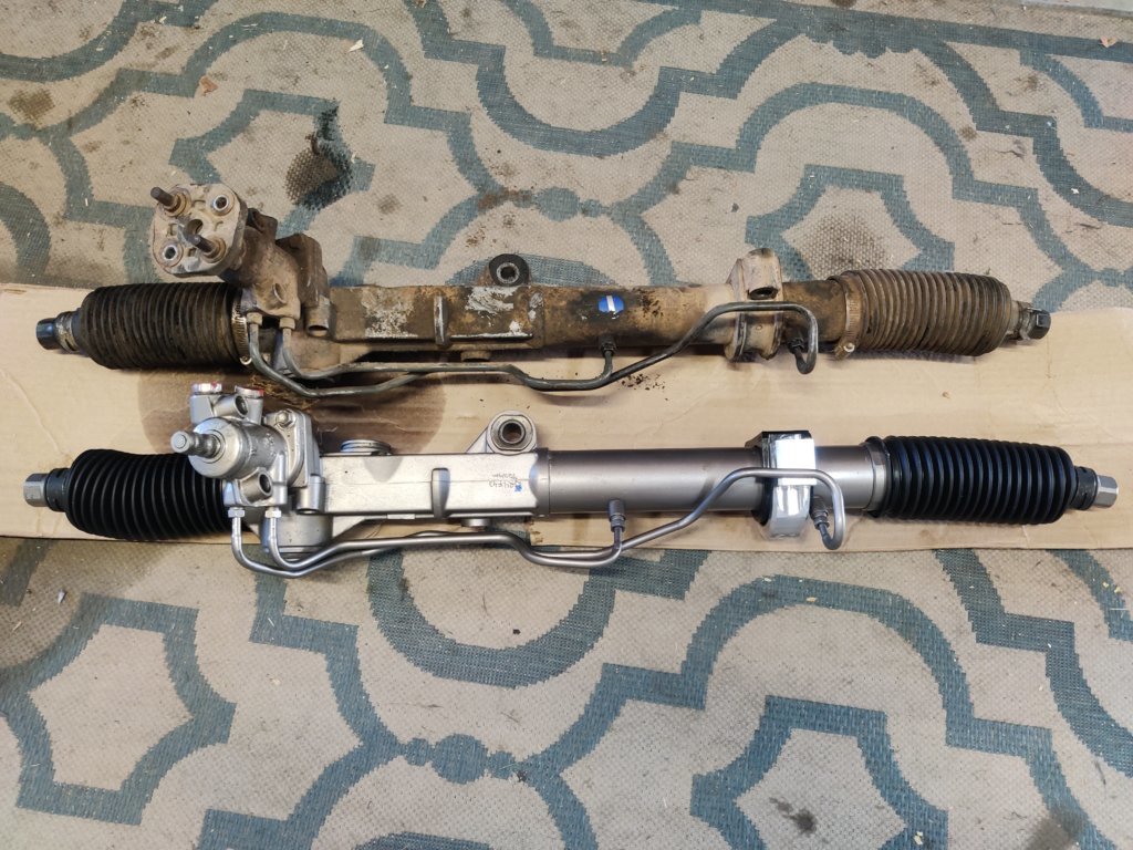

    I'm hoping they fell out of the hard lines on the old rack. I don't recall seeing them in the high pressure or return lines coming into and out of the rack. If you look at the picture side by side the new lines aren't screwed in very far but the old ones are screwed almost all the way in and i think it was even leaking a little bit still so a missing brass seal makes sense

  18. Oct 22, 2024 at 9:15 PM
    Tour991
    Nov 24, 2011
    #67616
    10,793
    James
    South Reno/Tahoe
    Yeah definitely looks like they are from the hard-lines.
