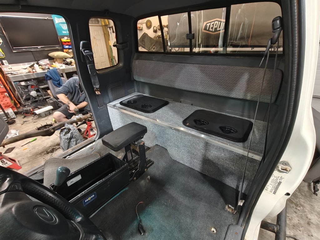

    What's going on with that center console?

    It's a Havis console from a police cruiser, I cut it down to the proper width and I've been 3D printing face plates for it. I have a face that holds my switch board, one that holds a GMRS, one for some 12v and USB ports... the rest are blanks for now. Maybe make one into a cup holder haha

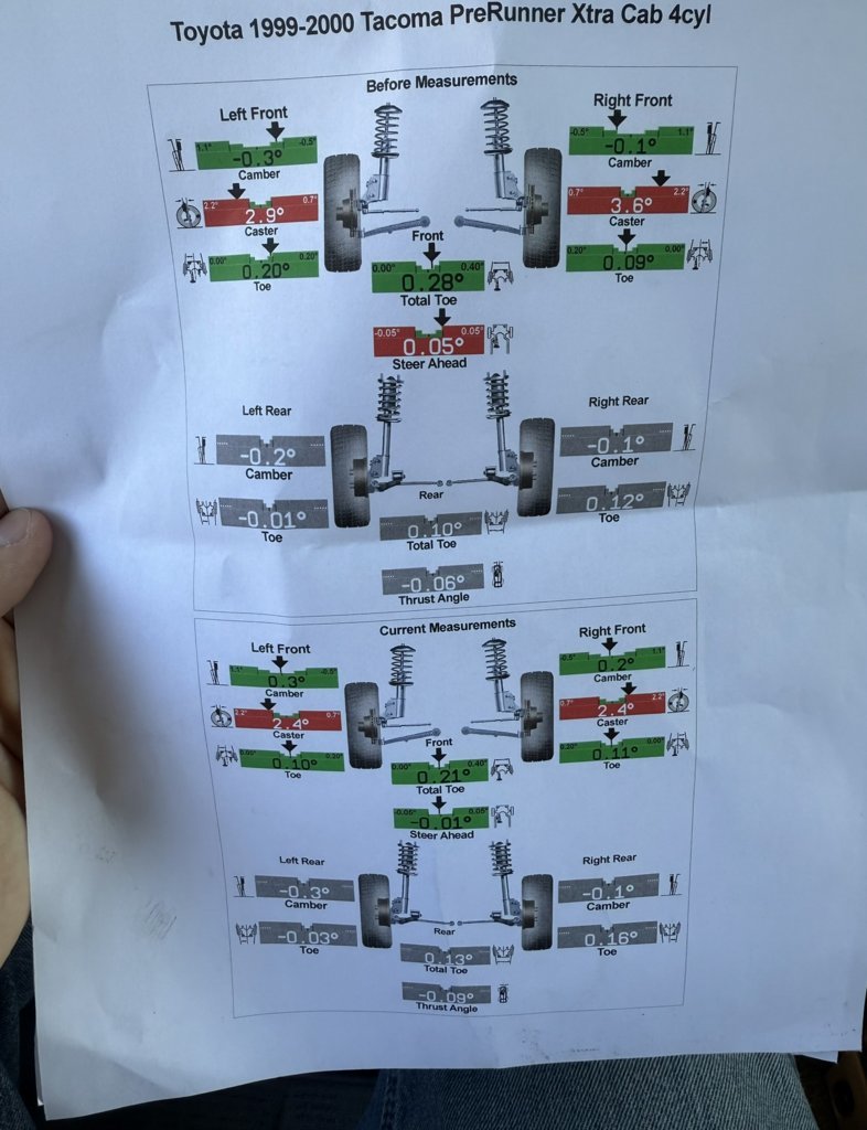

    Another year another alignment. Feels good to have a steering wheel that isn't tilted anymore.

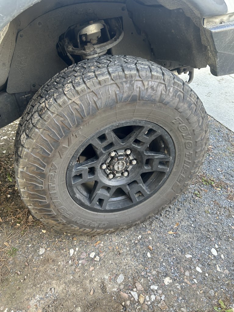

    In other news, I've got spinney dials for my front axles now!

    Hey do those wheels require spacers to not rub the calipers? And are they genuine Toyota TRD pro/off-road wheels? Or an aftermarket replica?
    I've wanted to run those wheels for some time now, but read their backspacing wouldn't work with a 1st Gen without spacers (which I currently run but want to do away with).

    I believe they are genuine TRD rims. They came on the truck when I bought it last year (one of the only things left on the truck at this point hah) and I think they look real sharp on a 1st Gen. They clear my Tundra calipers no problem and also allows me to run 255/80/17 tires.
    Red_03Taco[QUOTED] likes this.

    Nice, glad to hear they work without spacers
