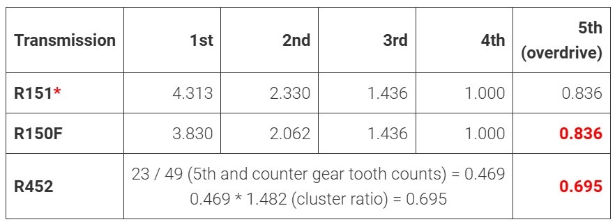

    I've got this in the step-by-step, but since I found it interesting, here it is:
    Thus, by installing the R452 5th gear into the R150F, the overdrive will increase from 16.4% to 30.5%, or approximately 500 rpm at 65mph.

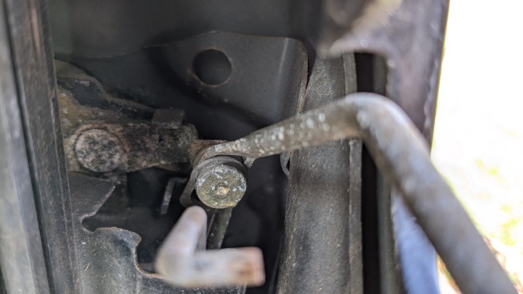

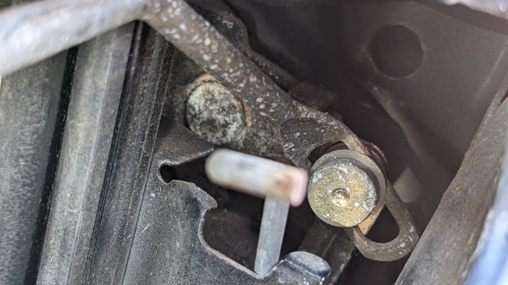

    Replacing my door handle, anyone know if this linkage is supposed to be bent like this for some reason or did I bend it trying to get it off the handle? I'm fairly confident I bent it just wanna confirm

    Put new door handle in and also redid the vapor barrier, old one was torn up and falling apart. Used 3 mil plastic sheet and put butyl rubber strips in areas that it peeled off or wasnt adhering well.

    Nice, I did the same thing with 3 mil a couple years ago too. Helped a ton with condensation in the winter

    Did the same a while back. Also used it as an excuse to put soundproofing on the door. Made a huge difference.
