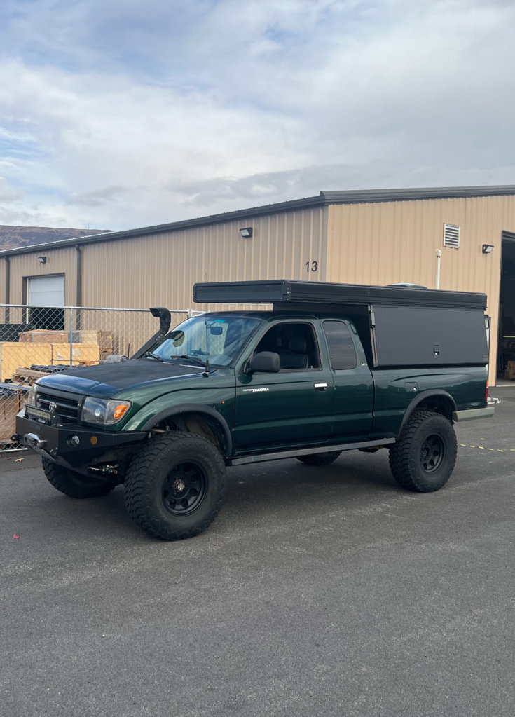

    IMG_3408.jpg After ordering it last December, finally got my Lone Peak installed, very happy with the finished results. Fit and finish is very clean, a lot of smart design, I’d definitely recommend- wait times are down considerably now

    Congrats my green twin! Can't wait to see more pics of it in action! :cheers:

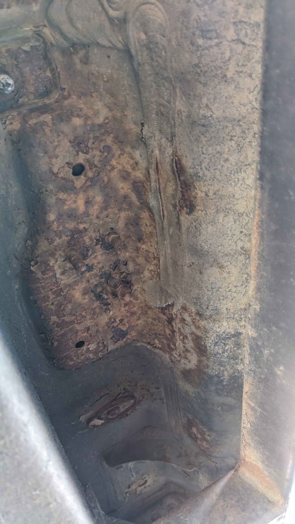

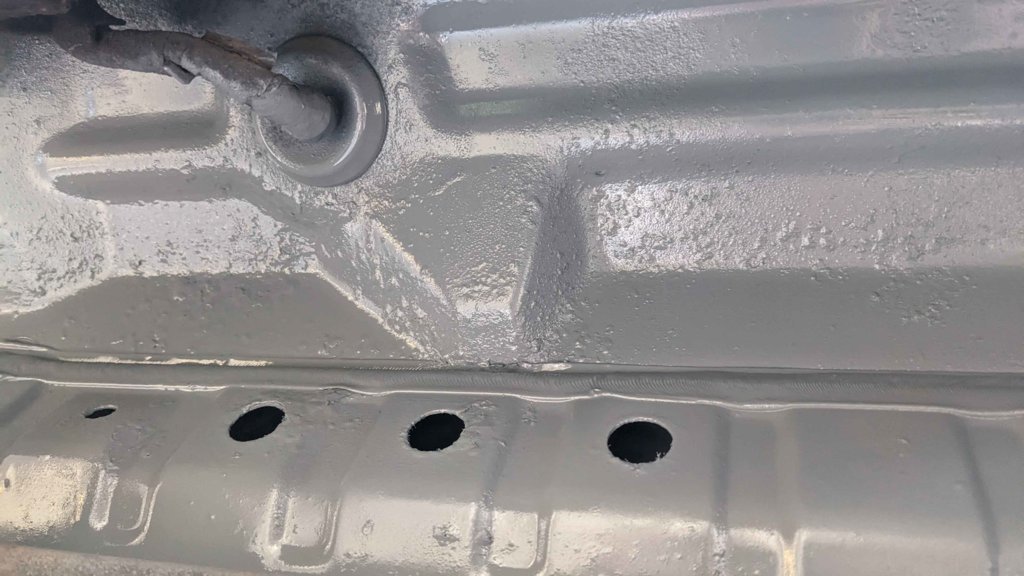

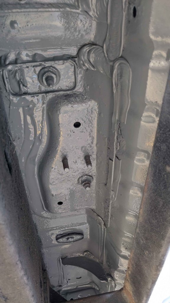

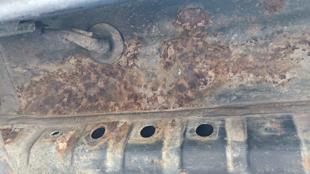

    Wire brushed and primed/painted a bit of my cab. Went with light gray so its easier to identify issues in the future. Going to fluid film it tomorrow after the paint dries. I wanna do the entire underside of the cab but going to chip away at it. Crawling around under the truck is the absolute worst.

    Looks great!

    Do your back a favor and get a creeper to roll around on
