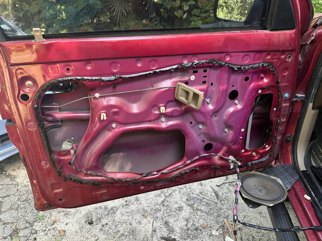

    Replaced my flimsy plastic door handles with the nice metal ones and put in a new vapor barrier while I was at it

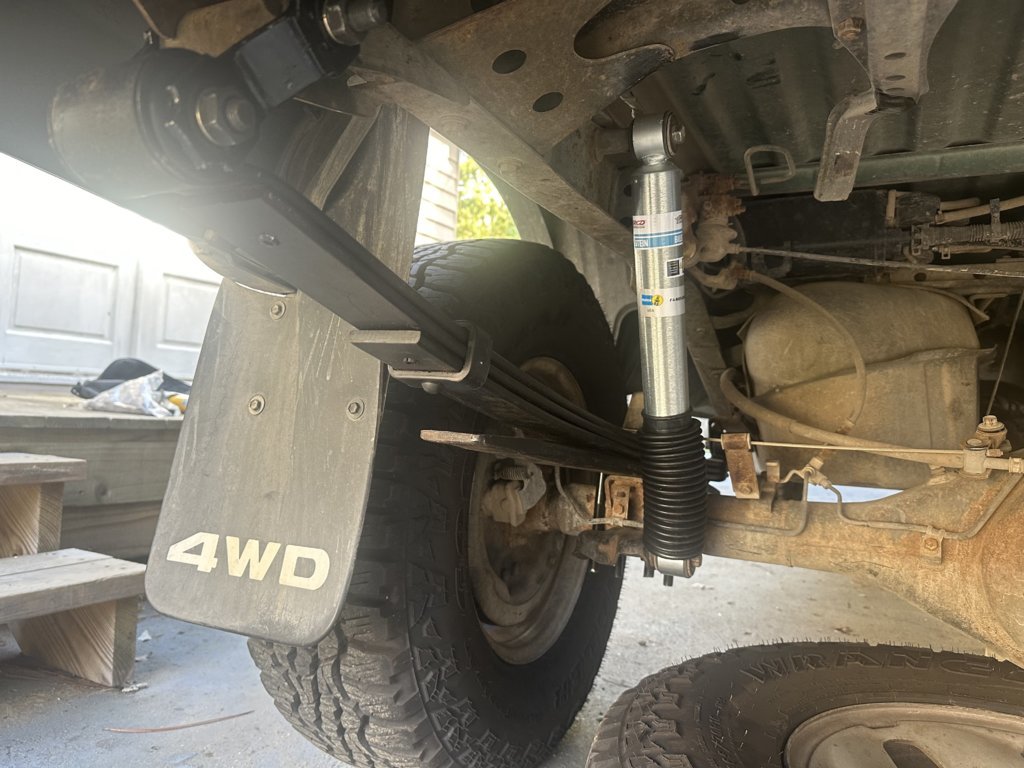

    Swapped out my 24 year-old springs for General HDs and added 5100s. What a difference! Probably didn't need to change out the shackles but, hey, in for a penny...

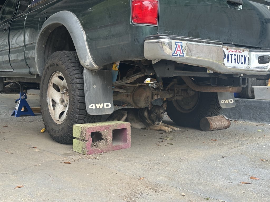

    Alright, break it up, boys: he was just complimenting the license plate that I dreamed about as a 9 year-old.
    (Full disclosure: I thought I'd removed that photo. The dog likes to use my truck as a blind for squirrel hunting and caught three the week that I was doing LBJs and springs/shocks.)

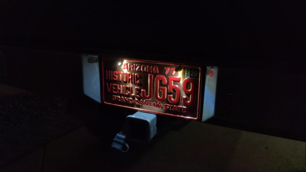

    Historic plates and 2 bar
    IMG_20241101_180912_429.jpg 25yr plates

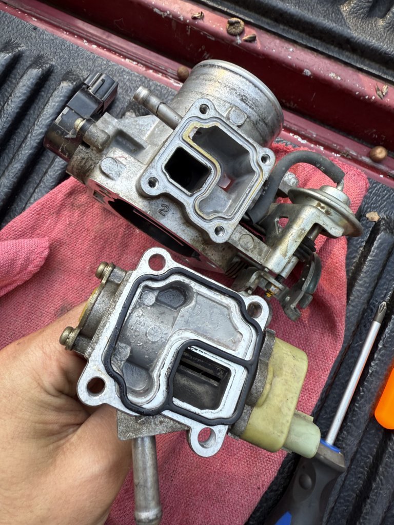

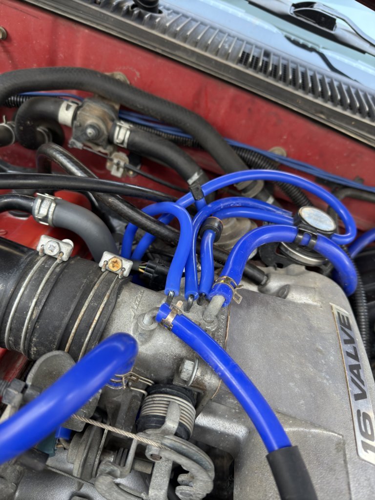

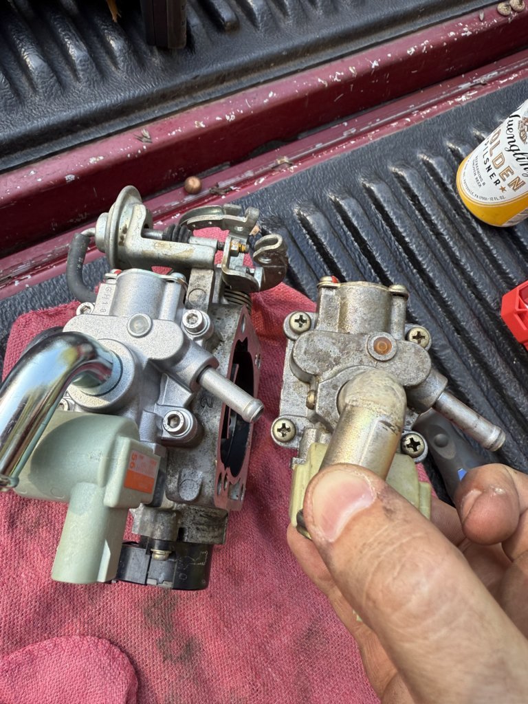

    Replaced the IAC as well as the remaining vac lines. New coolant lines for the IAC as well. Didn’t get to replacing the EGR gasket or harmonic balancer with it getting dark so early now.
    Noticed a huge difference in idle with the new IAC. I was chasing a really low idle around 620 for a while, this corrected that. Probably could have cleaned it but figured if I’m gonna go in there, just gonna replace it.

    Did you replace with new OEM? When I went to do mine, new oem price was outrageous

    Yup it stung. $245. I’ve noticed parts availability decreasing for our trucks so thought it was well worth it.

    I may do this for the same reason. Mine seems to idle low. I cleaned mine a few years ago and it didn’t really do much.

    I order from Ourisman along with associated hoses/vac lines/gaskets. Whole thing was under $350. If you do it, I used a #2 Phillips in an impact screwdriver set on '1' (Milwaukee) and the screws came out no issue. I replaced with allen head from Ace though.
