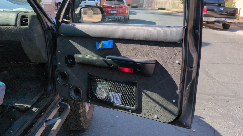

    Damn I love your door card setup. Good idea with the net.
    What kind of material are you using for the main part?

    It's an automotive grade fabric (UV resistant) that I have in other places in the interior wrapped over 3/4" MDF. Stiffens the doors quite a bit and adds noise isolation

    Was that on top of the stock cardboard or completely replaced it

    Completely replaced. Used original as a template. Tbh it's a very tight fit, 1/2 would give more leeway and still provide benefit, but not available in my area
    Since I have 3rd party mass backed carpet also I had to remove my kick panels for now until I can trim it or the door has too much resistance without slamming it closed

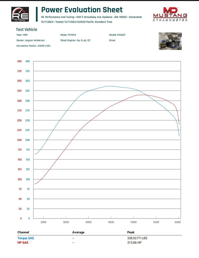

    Ah heck looks like I guessed low... :p
    That's what the turbo 2RZ @2RZNoShi1 has did this last Saturday @CoWj That's power and torque at the wheels
    and here's mine from this trip back to the dyno for funzies because we could
