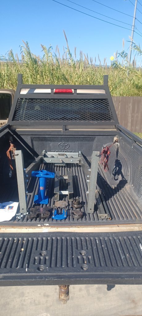

    12 ton. I got it to do the rear bearings on my 01 truck and the bearing tool is a 12 ton specific rated tool also. The guy I purchased it from sent me a link from who he purchased it from. Press tool Kit only for rears.
    https://www.ebay.com/itm/193637211065
    It even gives a reference and link to Timmy the tool man's video for rears on the listing.
    I did my fronts 2 yrs ago. I pulled the knuckles and took them to a local shop to press w/timken bearings and all the trimmings.
    I believe it's less likely for a screw up by a shop letting them do the fronts than rears, I'm thinking due to specifics of the rear repair. I want my control on that one so it's done for sure properly

    The guy I got it from drove a 1st gen tundra which he said he used the tool for. The bottom floor support was removed on press??? For longer axle, maybe he put it on some blocks or something to get the distance.

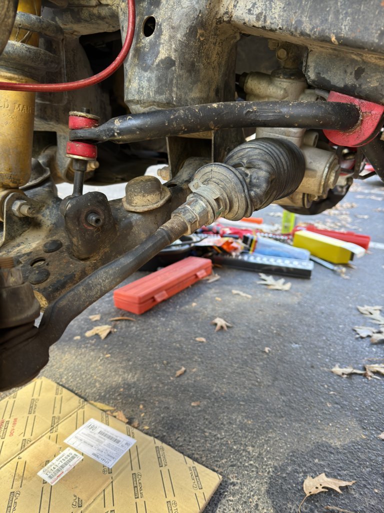

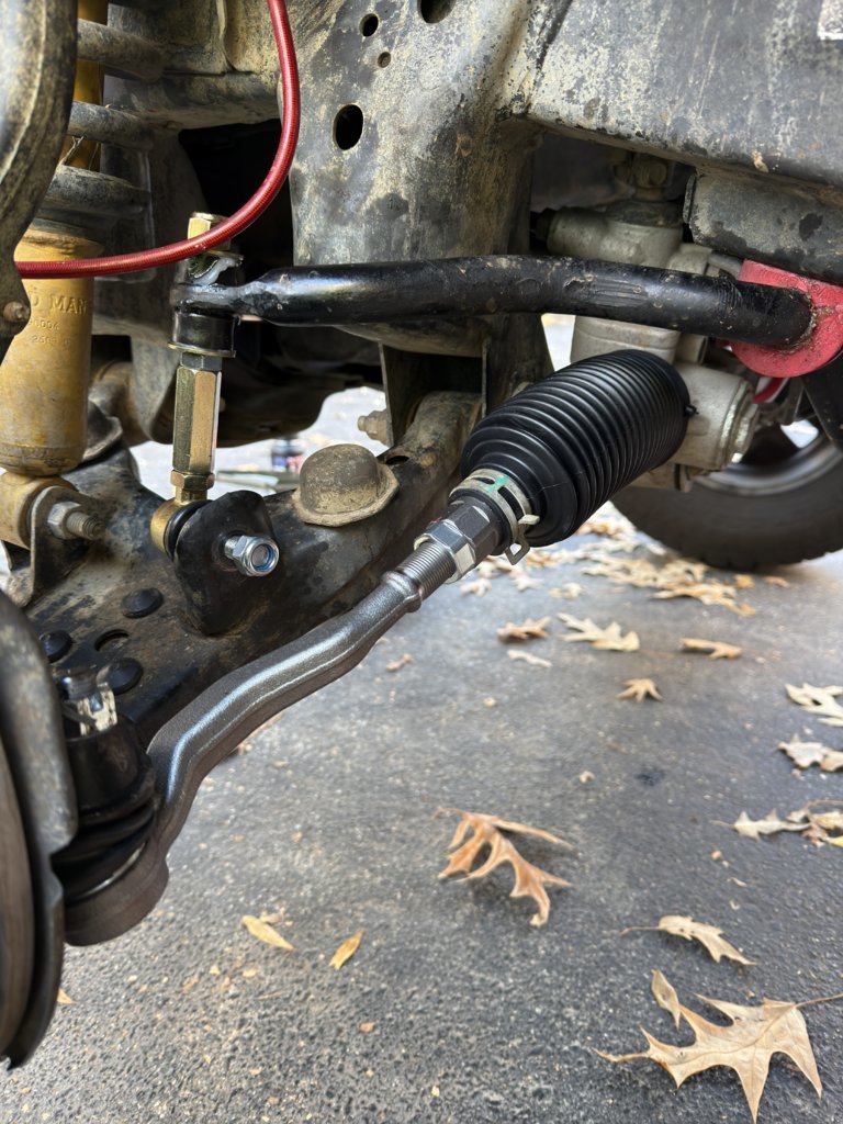

    Passenger side tie rod end was clunking for a while. New inners + outers on both sides. The 555 ones. My rack is different than the videos there was no place to put a 32mm wrench to help remove the inner so I just took a breaker bar to the inner with a 42mm end. Also no place for the lock washer, so Loctite was used instead. Eyeball alignment is what it is, it'll go in Monday for one. Alignment shop just twisted the inner last time and it destroyed the boot... lazy work.
    Also put on new sway bar links hopefully the last ones I'll ever need, seems like I go through stock links every 3 months. Adjusted to the lowest setting. Tomorrow is mini header exhaust to replace my LCE one.

    Have both a Tundra and Taco so was holding out for the 20 ton that is taller. Looks like the 12 ton can work but may have to put it up extended on blocks. Nice find there for $120 if it included the press and the tool! Did the rear on the Tundra and grease tested depth. You should be fine if use toy seals and test correct depth for seal on retainer.

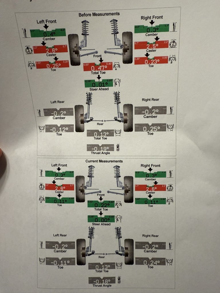

    Alignment after replacing the tie rods. Steering feels so much better now and I wasn't *that* far off by just guessing the toe. No more horrendous clunks and being able to shake the tie rod. Took 30min but of course was charged the full amount.
