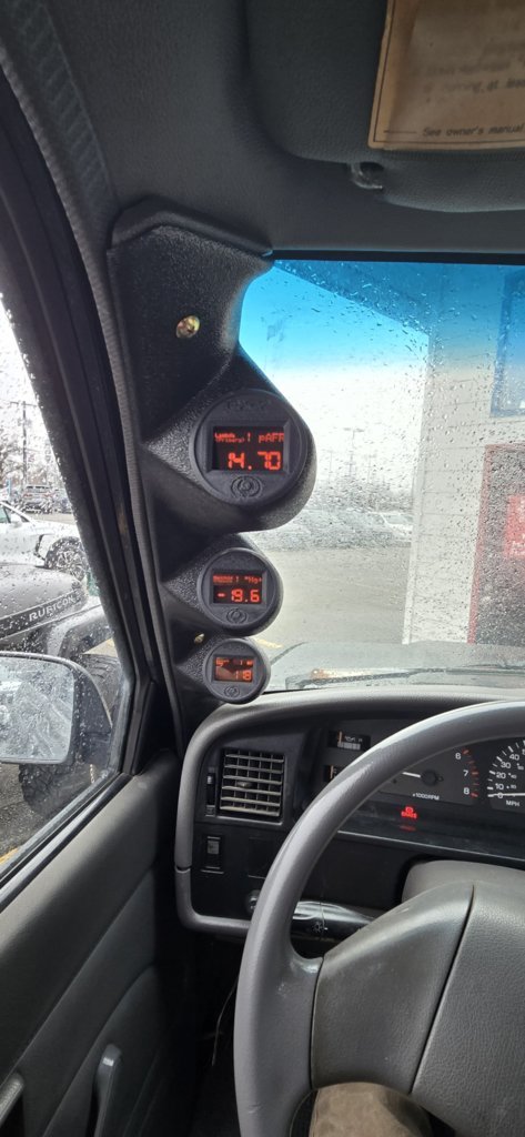

    The ones in my truck (don't have a pic on hand at the moment) look a lot like positioning of yours and are a standard single DIN height and width with four OLEDs. I currently have them set for AFR(petrol), Coolant Temp, Manifold Pressure, and Intake air temp, but they can be just about any PID on the CAN stream.
    Here's the other set I assembled for my buddy's truck, they're naturally white OLED displays but I've put a tinting skin of orange on them to match cluster colors. The little standard 2" round gauge faces are just 3D printed PETG, takes like 4hrs to make a whole build plate of them with any design you could want on the face. Single arduino can control up to 8 displays, @treyus30 did all the software research and development for the Arduino and decoding the Haltech CAN stream.

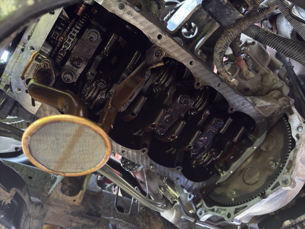

    Oil pan leak, not a terrible job on the prerunner but I don't want to do it again. Also noticed what looks like the start of a front crankshaft leak or oil pump leak... after doing all of this 3 years ago when I replaced the timing cover.

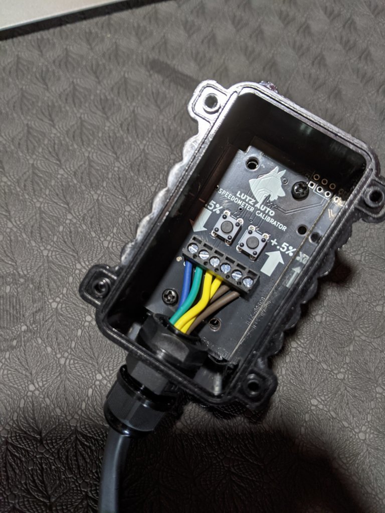

    Got some time off work for the holidays so going through the list.
    - 30k service: engine oil and filter, diffs, transmission, and transfer case fluids, coolant, thermostat, air filter, MAF sensor, spark plugs, etc.
    - Installed seat trim reinforcement reinforcements
    - Added a strip of weather stripping to the dash-windshield connection to hopefully deaden the rattle

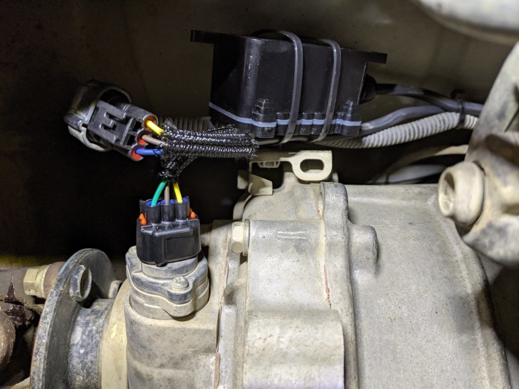

    - Installed the Lutz Auto speedometer calibrator
    - Installed the Switch Pros 9100 switch panel
    Question for the speedometer calibrator math: I checked my door tag and the OEM tires on my xtra cab are 225/75r15 or 28.3in tall tires and it came with 4.10 gears. I am currently running 255/85r16s or ~33in tall tires and 4.88 gears. This would mean a (33-28.3)/28.3=16.6% increase for tires + a (4.88-4.10)/4.10=19% increase for gears thus a 35.6% total increase from OEM that I need to offset. I feel like thats going to put me way under.

    I wouldn't base your selection solely on the door tag. My truck also has a 225/75r15 door tag with 4.10 gears, but I think it actually came with 31" tires from the dealer. I say that because I had a 265/75r15 (31") spare with a 1997 DOT code and my truck was manufactured in 1997 for the '98 model year.
    Anyway, @turbodb says a 33-tooth speedo gear is perfect with 255/85r16 and 4.88 gears: https://adventuretaco.com/replacing-the-speedo-gear/

    Yep. 33-tooth is what you want with that combo, for the ODO to be correct. Or, you can use a device like the Lutzauto (see link below), if you want something that is adjustable for any combo. (Full disclosure - I didn't love how mine worked, so I uninstalled it. I would be happy to let it go for a good price :); PM me if interested.)
    Also, note that when the speedo is correct (according to a GPS), the ODO is not. They differ by 5-6%, so you need to choose which you want to be correct. I wanted the ODO to be correct, since I care more about service intervals than some "random" speed on the highway.
    Details here: https://adventuretaco.com/lutzauto-speedo-correction-device-issues/

    Thanks for the advice 6P4 and turbodb. I actually already bought and installed the Lutz Auto tool and calibrated it to negative 35% trying to match OEM spec but now I see that "OEM spec" is in heavy quotes and may not mean anything. I'll follow your advice and calibrate to get my ODO correct which I agree is more important than the speedo.
