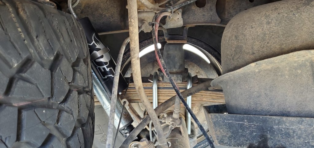

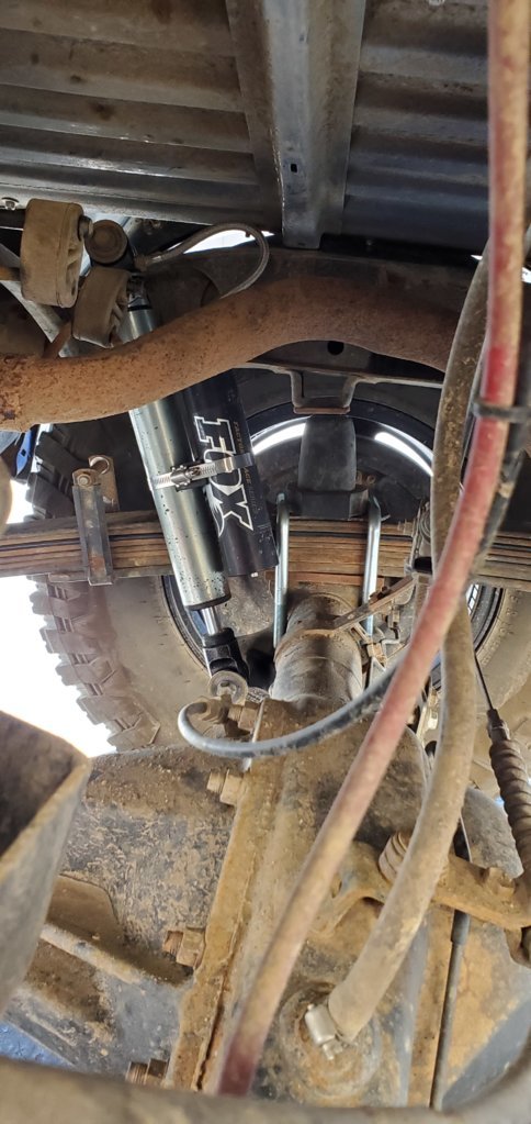

    those should definitely do the trick for you. They worked great and didn't act as limit straps when I had both OME leafs and Alcans with the them in the factory location.
    And I actually meant 4.25". Only say that because I had the durobump ones that are that tall. Any shorter and I think the shock would become your bumpstop on full compression. You can see how close the driver side is with a 1/4 extension added.
    You could just make the strike pad taller to compensate as well which is what I did until I relocated them.

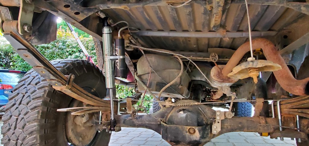

    Drop bracket lift and booger welds
    Looks like shit. :luvya: Really though I may be copying your design. I *may* have cracked the welds on my 4x rear side swiping a tree at 50 mph getting a little too rowdy. Took out the tire, rear bumper got tweaked and took some body damage but still drove away fine.

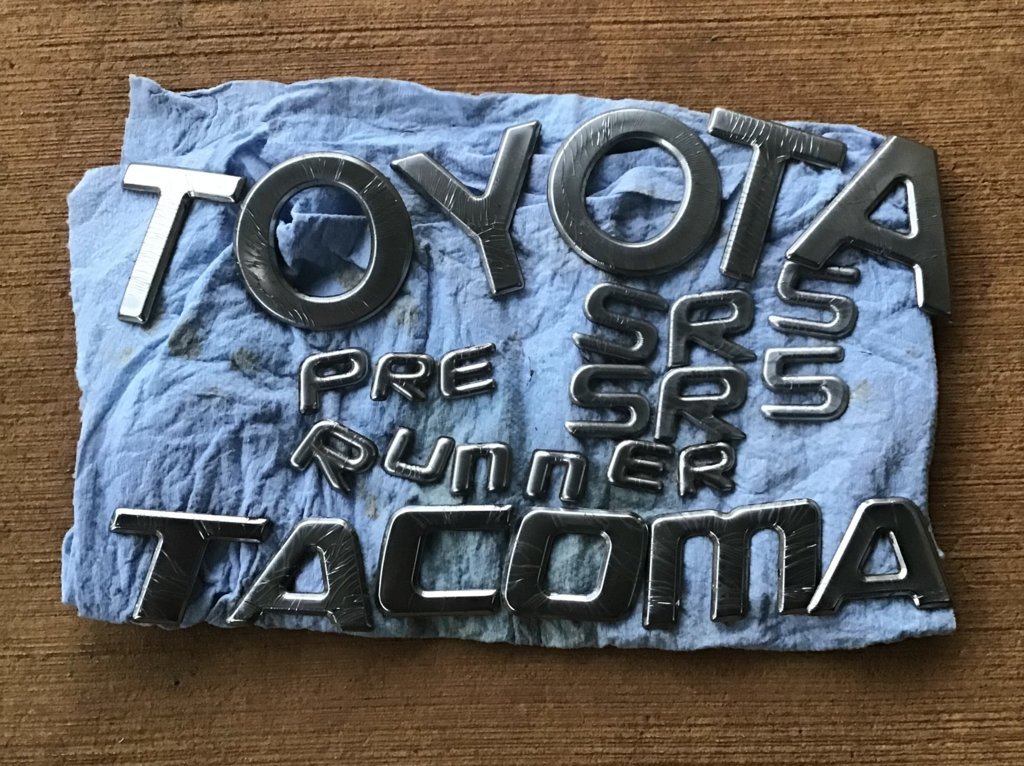

    Mostly cosmetic but she ain’t stock(looking) anymore.
    Finally got around to removing my 20yr old tailgate/pillar badges, never liked the look of ‘em.

    You could def get a few bucks for the SR5 badges since those aren't made anymore

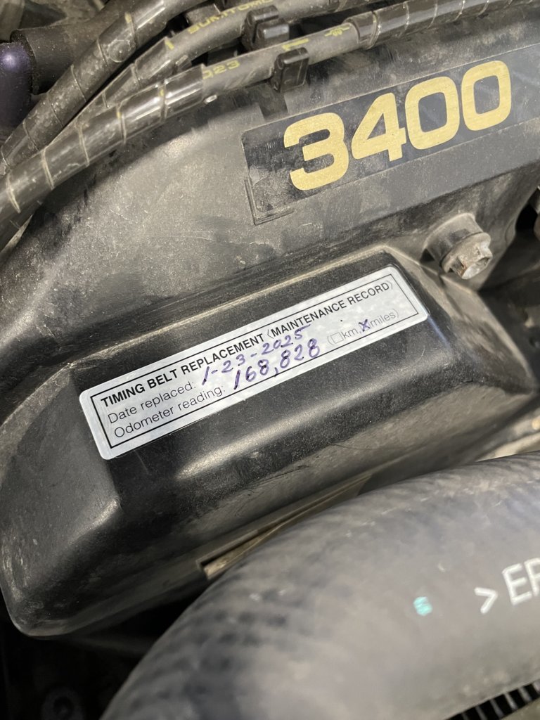

    Finished up my timing belt/water pump/radiator job and my truck fired right up. A little nerve wracking for the first time.

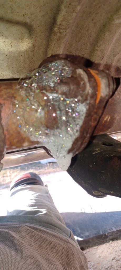

    Last week a p0420 code showed up, today I found this leak around back of cat. Its the pipe weld to flange on cat assembly. Hope that's the cause. Off to a buddy's to mooch a quick weld with his welder. Shop vac dish soap worked great!

    I thought that was a folded Tshirt at first

    Bro is sitting on his retirement right there

    1st gen 401k
