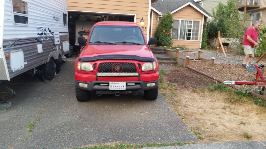

    I had that Curt front mount on my truck (04) for a while. It uses the 2 existing mounting locations for the stock tow hook/tie down hooks, and the rear hole is drilled into the bumper brackets behind the hooks. You don't really need to put the tow hooks back on, but I think they might still fit with the stock hardware.
    The biggest issue is for some harder core offroad use is the bar hangs a few inches below the frame so the receiver tube would hang below the bumper plastics. It isn't bad for logging, and fire roads but it is down there.
    This pic is from 2017, before I switched to an ARB, and several other mods.

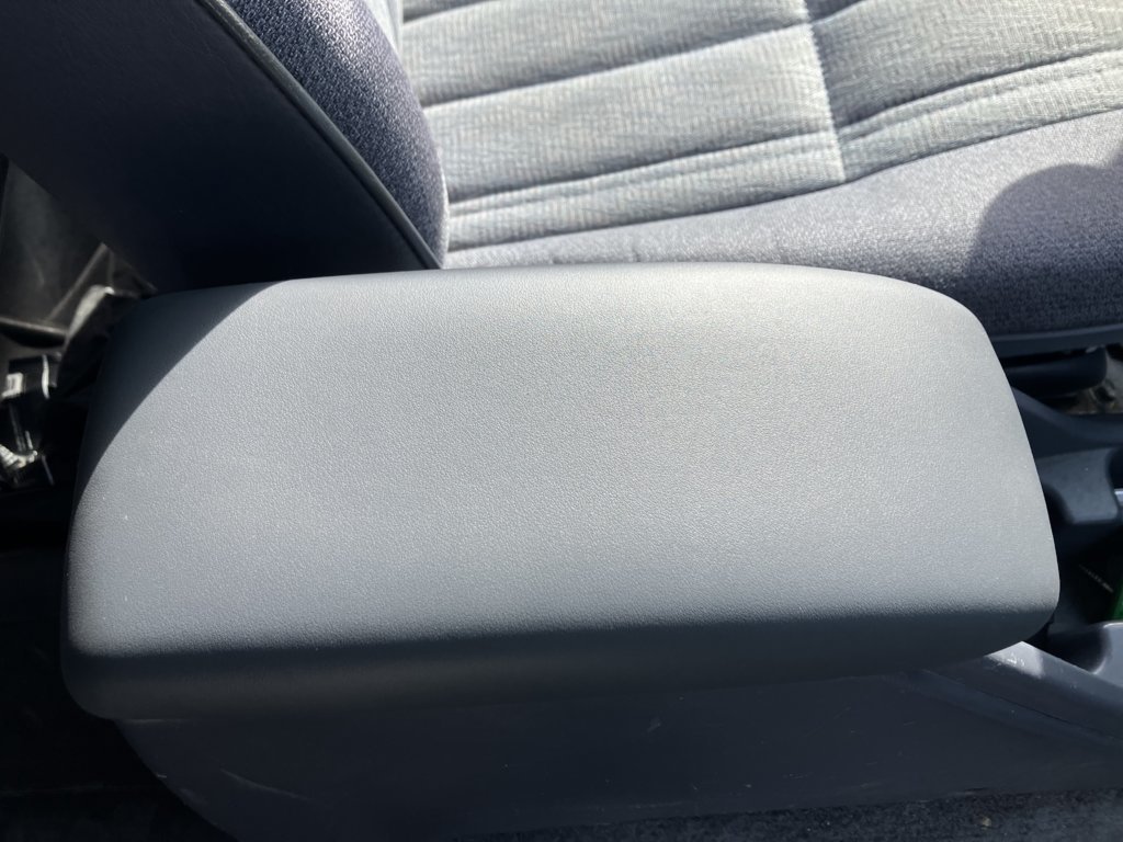

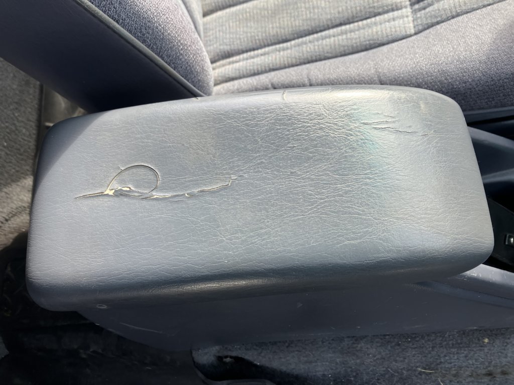

    Finally replaced that cracked, 26 year old armrest with a new $15 ebay version.IMG_3331.jpg IMG_3332.jpg

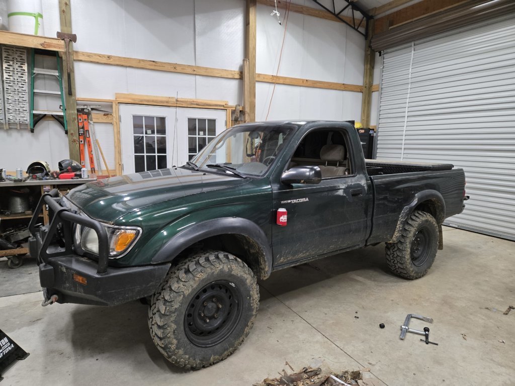

    I installed bilstein 5100s with ome 880 springs and couldn't be happier. My truck is a 01 reg cab short bed 3rz and a couple months ago I put a arb bumper and 9500# winch on which sucked the front end down alot. Alot more than I liked, I like a lil rake but not as much as I got. So after searching lifts, levels from different manufacturers, yes even the rough country junk. I decided on bilstein 5100 and the ome 880 springs. So speaking for my self this set up sat the truck at 36" in the front to the fender flare and the rear is factory leafs shocks which sets at 36.5". I am happy with the outcome. In the near future itl have bilstein rear shocks as well.

    That green truck looks great man. The height worked out and you got the bigger of the 2 shock jobs done. Rear shocks are a piece of cake. Cheers
    Is that a magnetized koozie, nice!

    After having the new springs on the struts it only took about 15 mins per side. Longest part was finding the 14mm for the top nuts. And yeah magnetic coozie for the win! No more loosing beers lol.

    Those are quite easy to reupholster too
