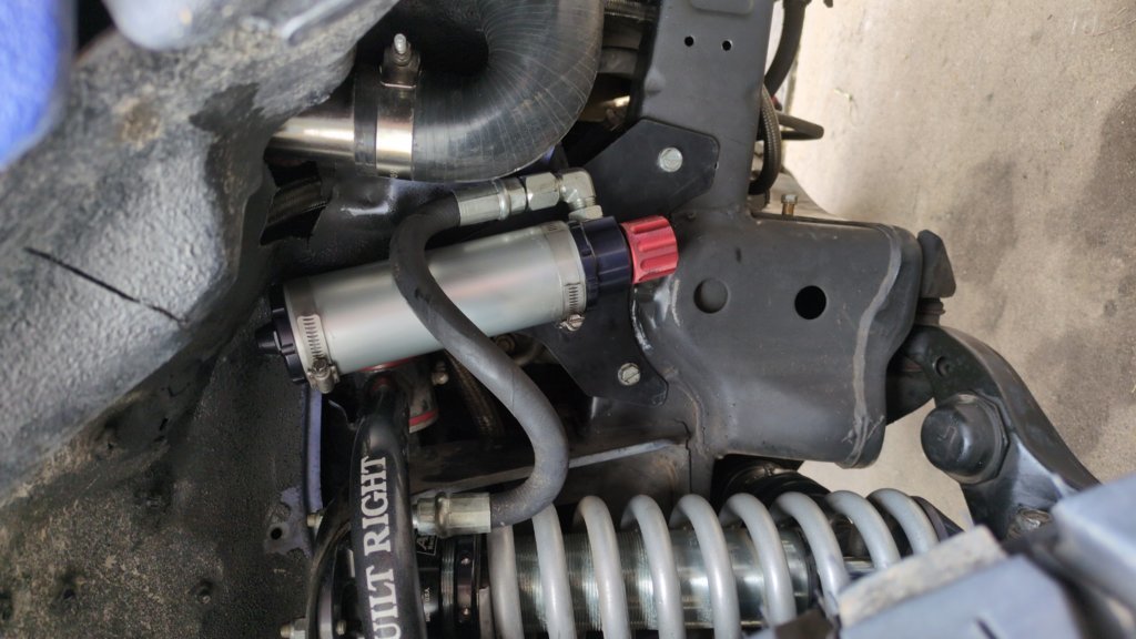

    Probably between a teaspoon and tablespoon per side. It does feel a little squishier but maybe I can use the clicker to harden it up again. Sucks, and annoying that they clearly revised this and didn't inform their previous customers. I sent this info to ADS today so we'll see what they say.
    They still won't fully clear my tires at full compression, doesn't look like.

  2. Jan 25, 2025 at 7:07 PM

    They shouldn't necessarily feel squishier at a standstill. But they may perform squishier because as nitrogen pressure lowers the possibility for cavitation increases

    yeah those hoses are too long. They re did them so they are shorter with the clickers. That way they can be on the same side as the shock and angled toward the engine away from the tires.
    I see you're in AZ. So probably could just drive there and ask them to fix it. Should just be a hose swap and you can get oil topped off and a recharge while you're at it.

    Are they long enough to route down to the front crossmember? That's where I have my fox DSCs mounted.

    IMG_7066.jpgYeah, I had a hell of a time getting my Fox resi’s mounted, ended up making a mount and had to zip tie the hose tight to the frame to clear the tires, couldn’t find a better way that cleared everything

    No, they aren't long enough to clear the corner

    Not sure what Fox was thinking with their mount location. I've got the same ziptie pulling the hose in.

    Looks like a prime spot to get crunched up on rocks and debris. Is there no room in the engine bay to mount these?

    Way better than the spot they want you to mount it with the bracket they provide. Hangs lower to the ground and isn't protected by the skid plate

    I feel like in the end it might just be best to get a shop build the hoses to the length you need. Of course then you are stuck recharging yourself though.

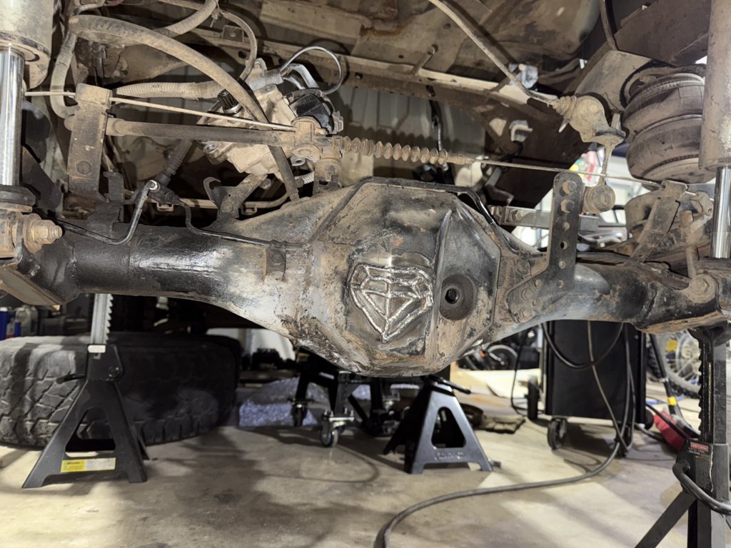

    Fixed my diamond, shouldn't have tried to draw while the gummy was kicking in. :anonymous:
    [​IMG]Untitled by MJH Creations, on Flickr
    More importantly I skinned the bottom of the diff with 10g to level it with the drain hole bump. So went from this:
    To this smooth bottom with a little extra beef.
    Should last another 2-3 years of dragging before I can slap a FF in.
