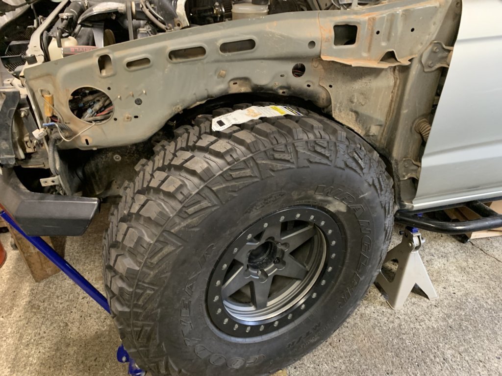

    How has fitment been with the Solo LCA's?

    Sheesh. Is that full bump? How are you not into the fender apron yet?

    I was gonna say that CAN'T be full bump.

    They help, I have a pretty deep tub but still it’s right up against them.
    I have adjustable hydro bumps up front, they’re set about 1/4” before the LCA crashes into the frame but no, that photo isn’t quite at full bump. I’ll probably need to adjust the bumps down a bit, or cut out more of the inner fender. I’ve cut out some since that photo was taken, especially in the front to allow full lock steering.
