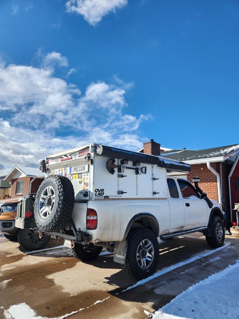

    LT255/80R17 Toyo Open Country RT Trails

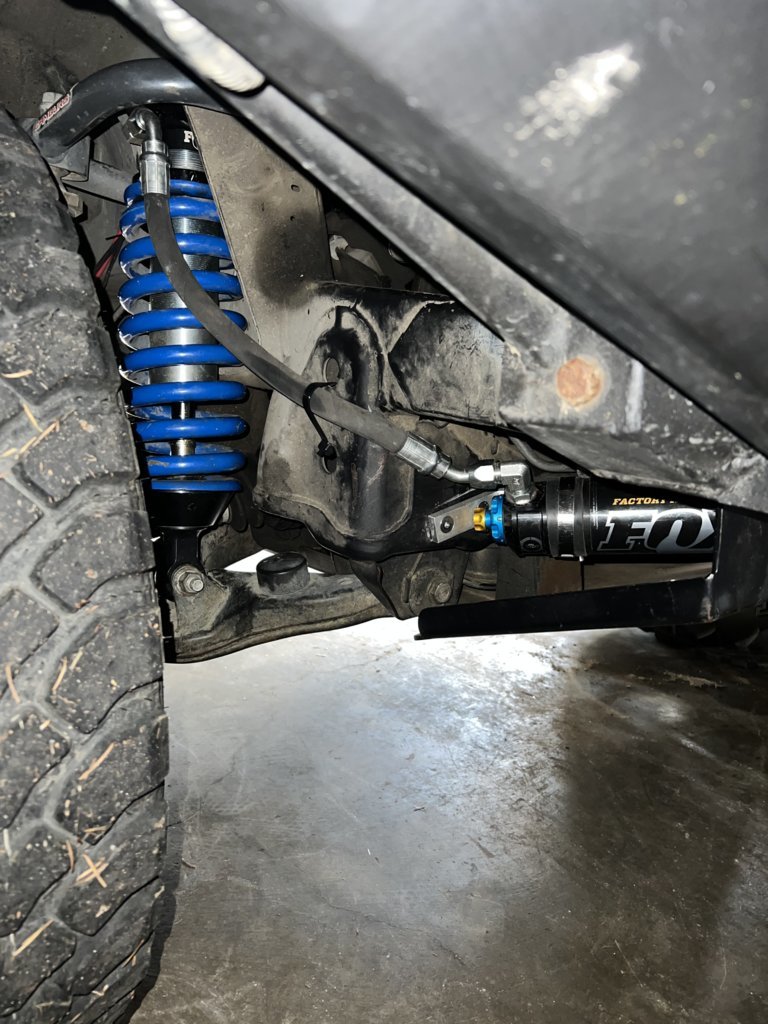

    My plan is to have my shock guy add them to my ADS's as well as do custom length hoses to hide them under the skid instead of the current spot they are now:

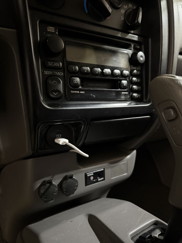

    where did you get the outlet itself? Or do you have a part number for it? I love how clean this looks!

    PU5T-19J211-BA for the usb plug
    WPT-1822 For the pigtail

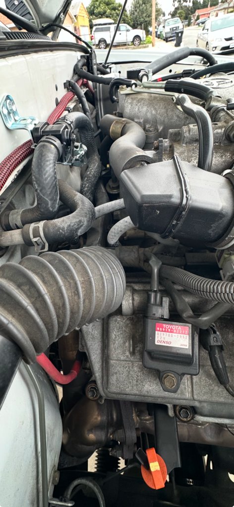

    Any thoughts as to what is causing this white residue buildup on these hoses? I have replaced the heater control valve and did clean up the residue but it has since returned with a slight coolant smell after the engine has been running. The valve does not appear to be leaking either.

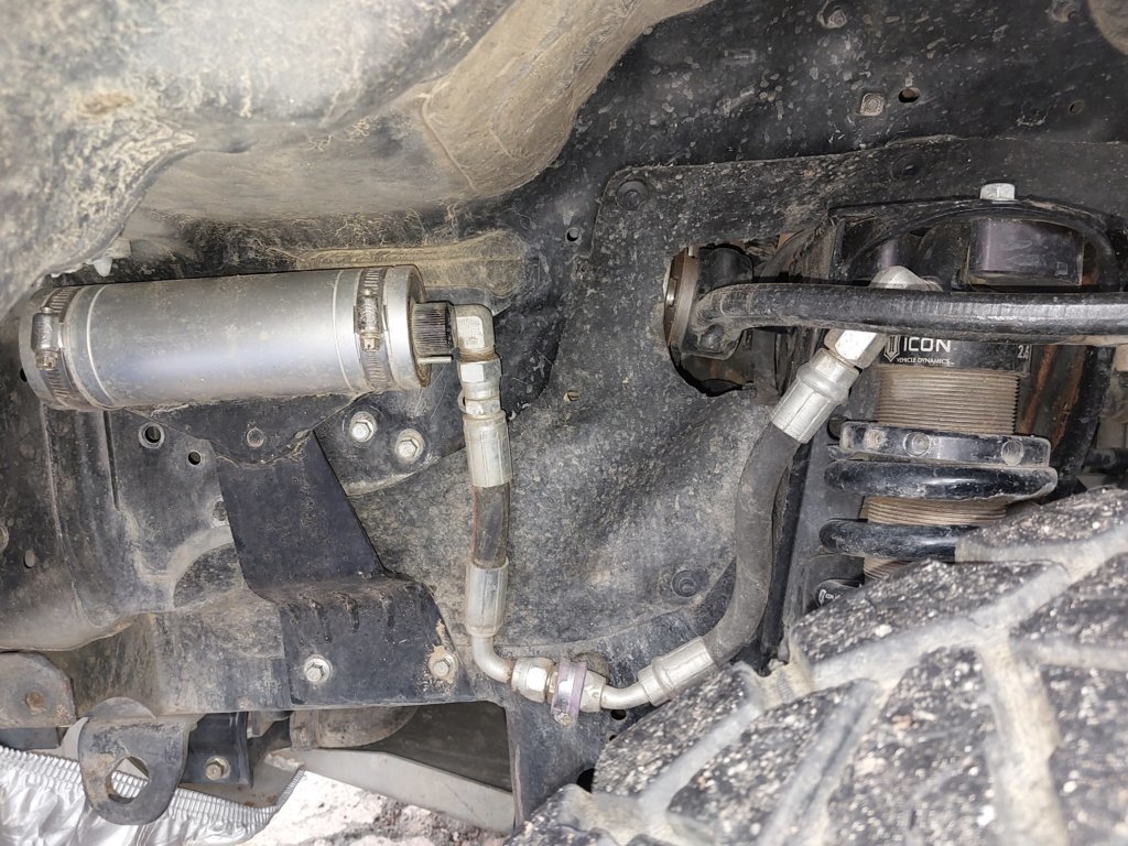

    My stock location reservoirs would rub the tire really bad while backing up and articulation. Like when turning around on a trail.
    I went to a shop that made replacement forklift hydraulic lines and came up with this.
    I may see if custom bent hardlines are available to get rid of the center fitting.

    This one also works (BlueSea 1045 USB charger), and you can just use the existing OEM cigarette lighter plug on the tabs. It's USB-A, so gives a bit more choice on connectivity, and still 60W of charging across both ports.

    Mine have worked well, and I like them protected by the skid, not having them in the wheel well means not getting sprayed by crap as much. I’ve got Solo lowers ready to go on which’ll move the lower ball joint forward an inch, so it’ll increase the clearance around the hose. The dark spot on the hose where the tire rubbed is from before I zip tied the hose in, there’s no contact now, I checked articulation/clearance without co’s mounted and cycled the suspension at full lock, everything clears
