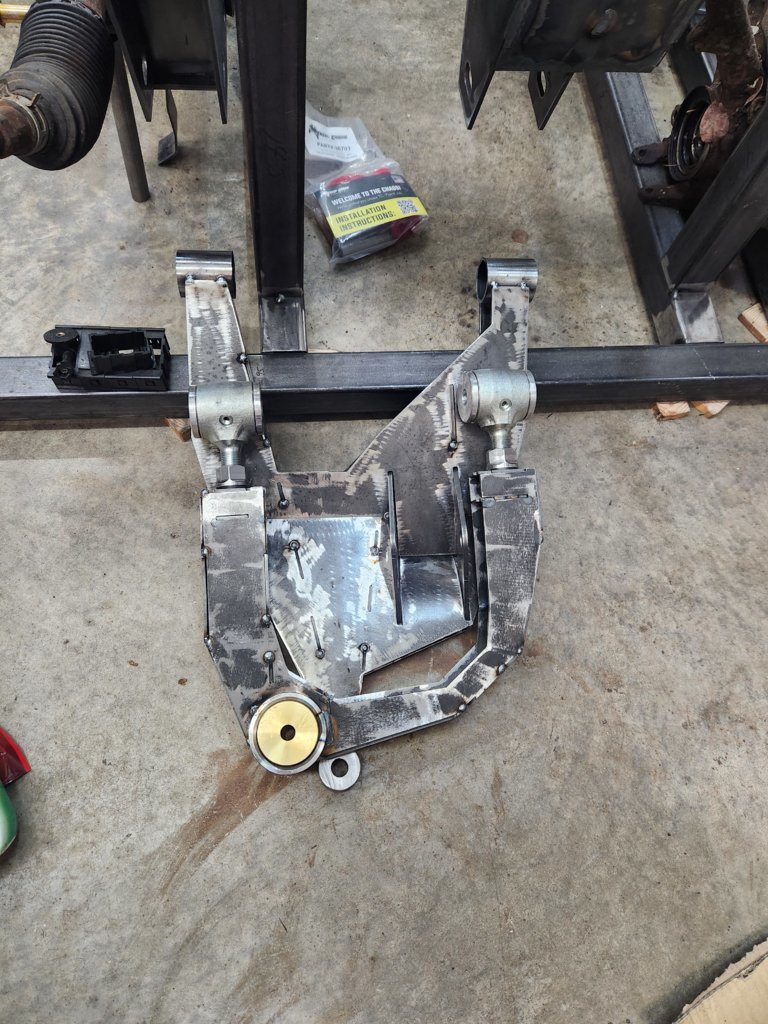

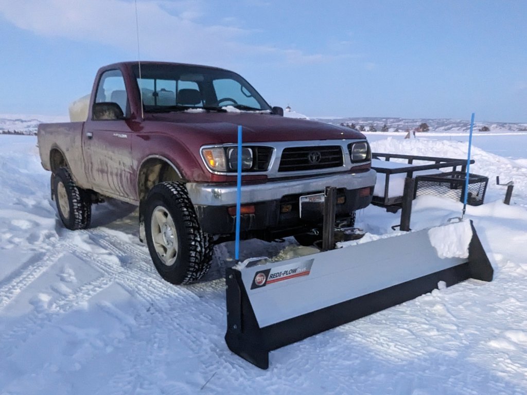

    Ready for the next round of snow tonight.

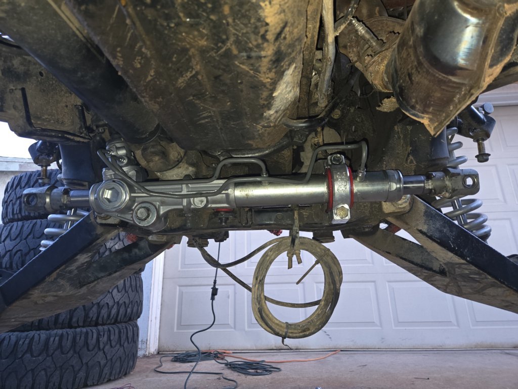

    New steering rack installed with 333 Fab rack clamp and Total Chaos bushings.

    Which heim adapters are those?

    TrailGear

    What’s your thoughts on the 333 clamp? I’ve been looking at those.

    WAY beefier than the original one.
    I can see why some people say they had a problem with getting it to fit with some bushings. I had to bevel them a little at the corners, inside, nearest the bushing it's self. That way the corners didn't catch on the bushing.
