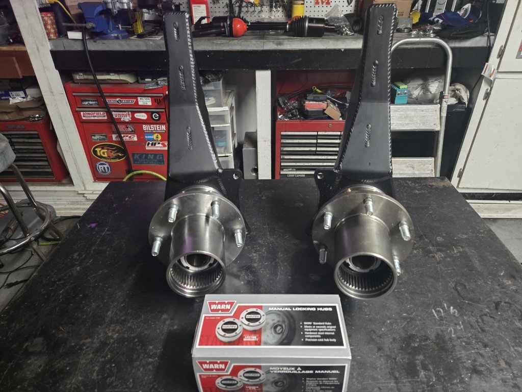

    You get the fabbed spindles too?

    Yes... I have to assemble them tomorrow. I was pretty much done after getting the rack back in. It's kind of a PITA.

    It really can be, especially if you like having a straight steering wheel.

    EXACTLY.
    Was just glad I had @essjay helping. Trying to do that by myself, I would have said fuck it and my steering wheel would have been, like, 94° off.

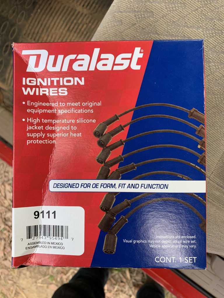

    Pulling a trailer. Stop at a light, turns green and the truck starts missing… limp it home cylinder 2 misfire. Swap coil packs. Then swapped the wires and it moved to cyl. 4 misfire…Praise The Lord. Picked up a cheap set and it runs smooth. I love easy fixesD79FD98B-EB8A-408F-A4BC-7B15D81AE897.jpg

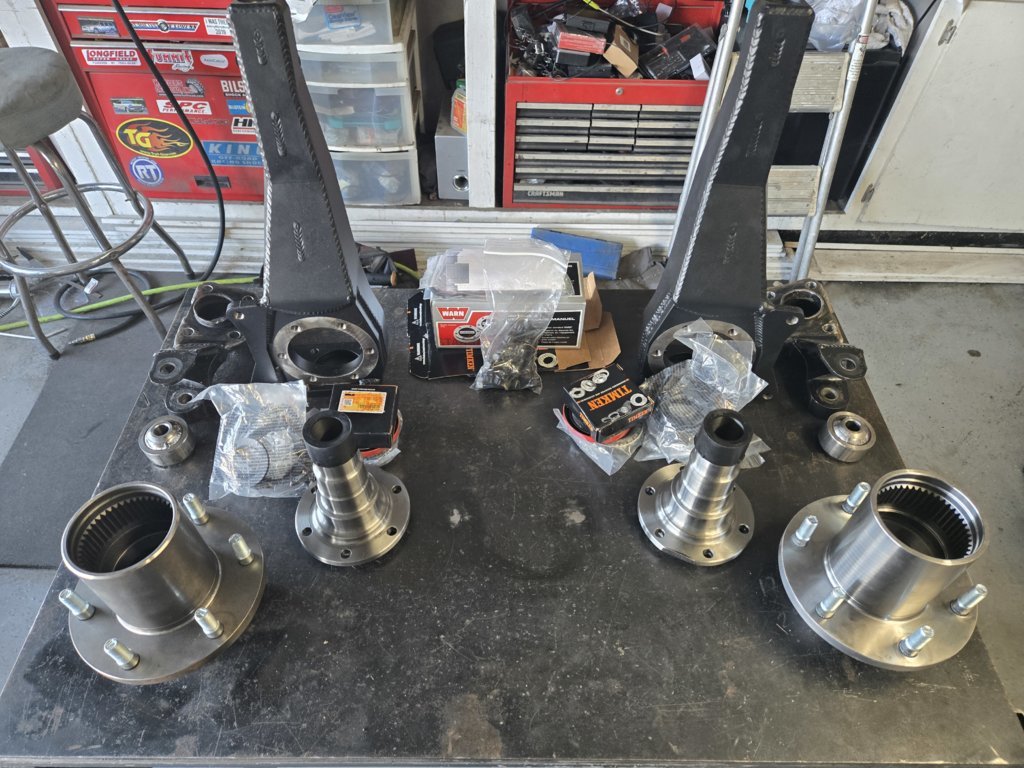

    Well... let's see if we can make all this go together with no extra parts.

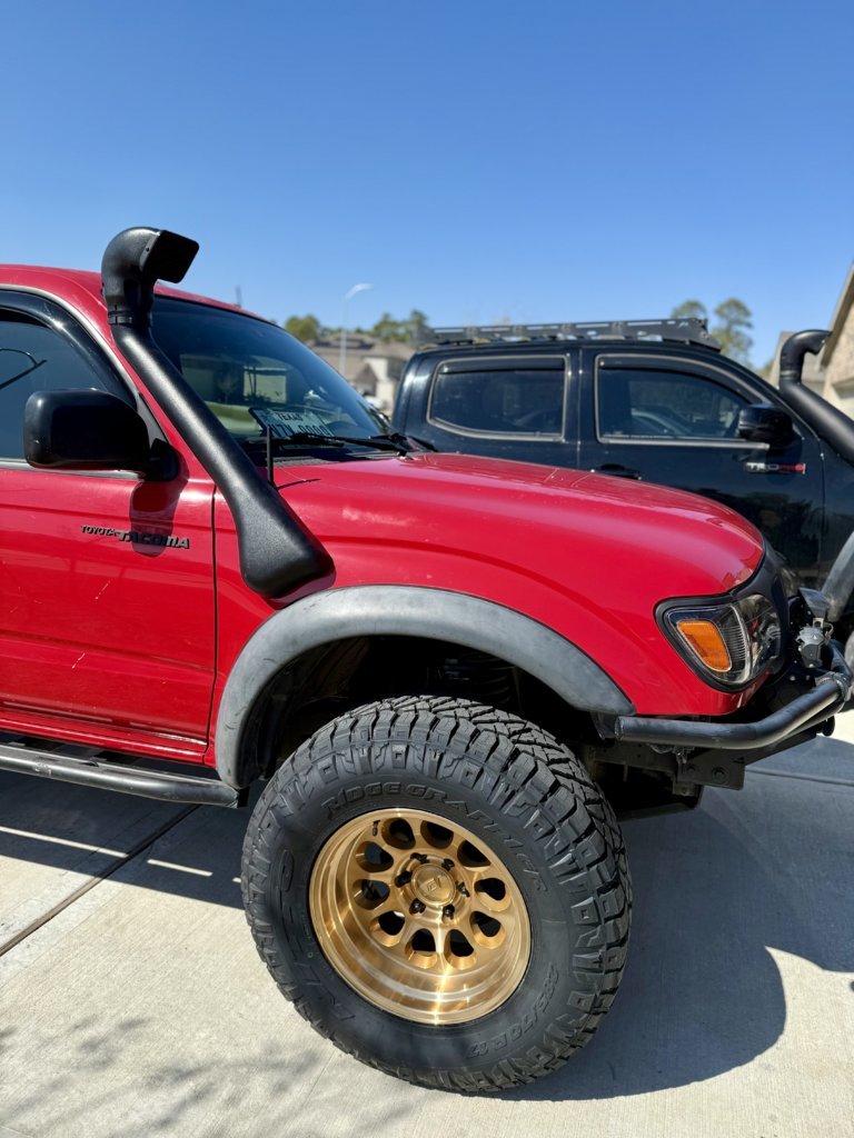

    Installed spc ucas and got a lifetime alignment at Firestone

    Welp... next hurdle.
    Total Chaos Lower Ball joints do not fit Solo Motorsports fully fabricated spindles... in case anyone was wondering.

    For some reason I always thought the fully fabbed spindles eliminated that failure point.

    They were required to run solos LBJ to spherical bearing conversion that's probably why

    Which failure point?
    This issue isn't a failure point. The problem is the double shear on the TC LBJ is at too much of an angle to mate up with the spindle.
    I would either have to bevel the bottom of the spindle... more than I'd feel comfortable. Or cut part of the double shear bracket on the TC LBJ and re-weld it.
