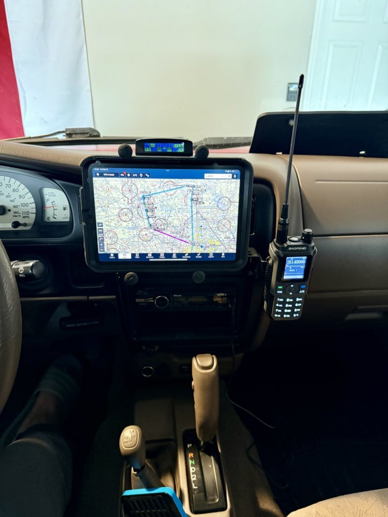

    The what?

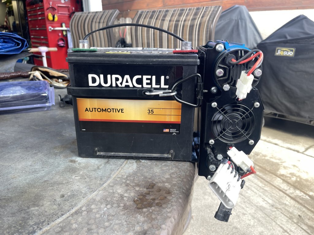

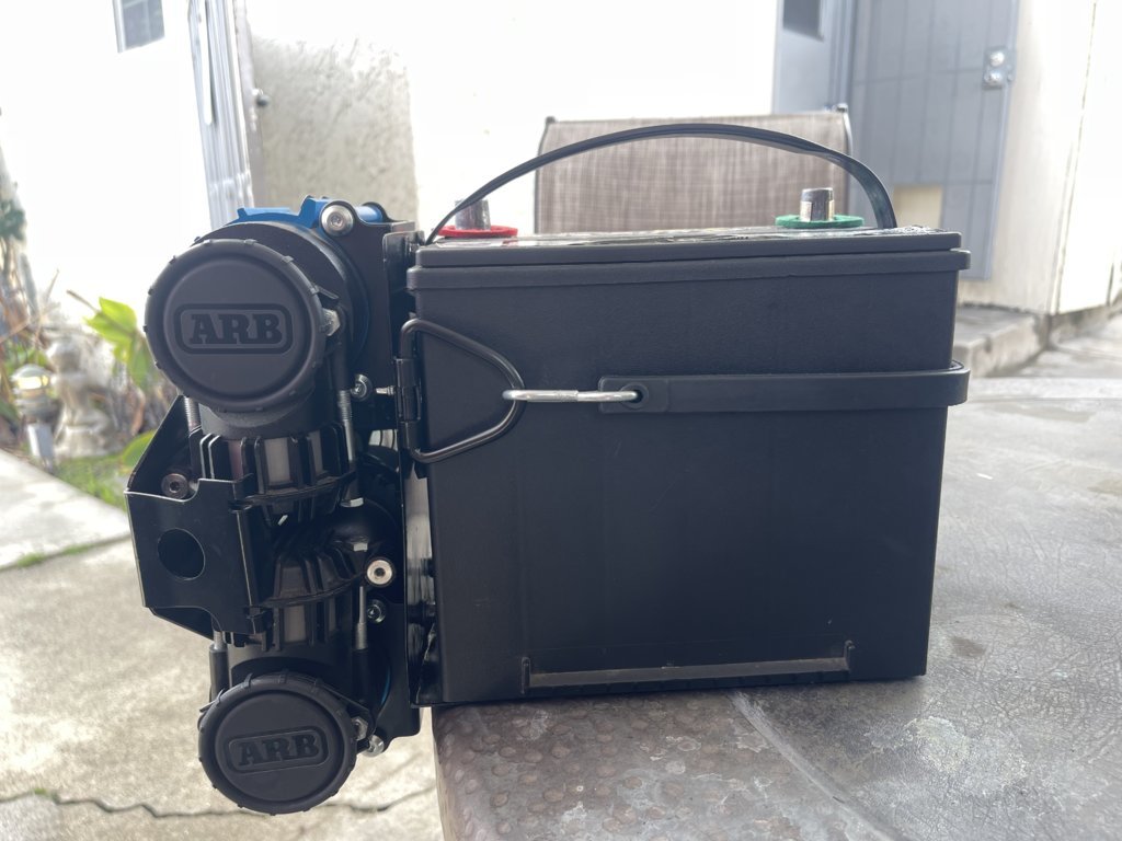

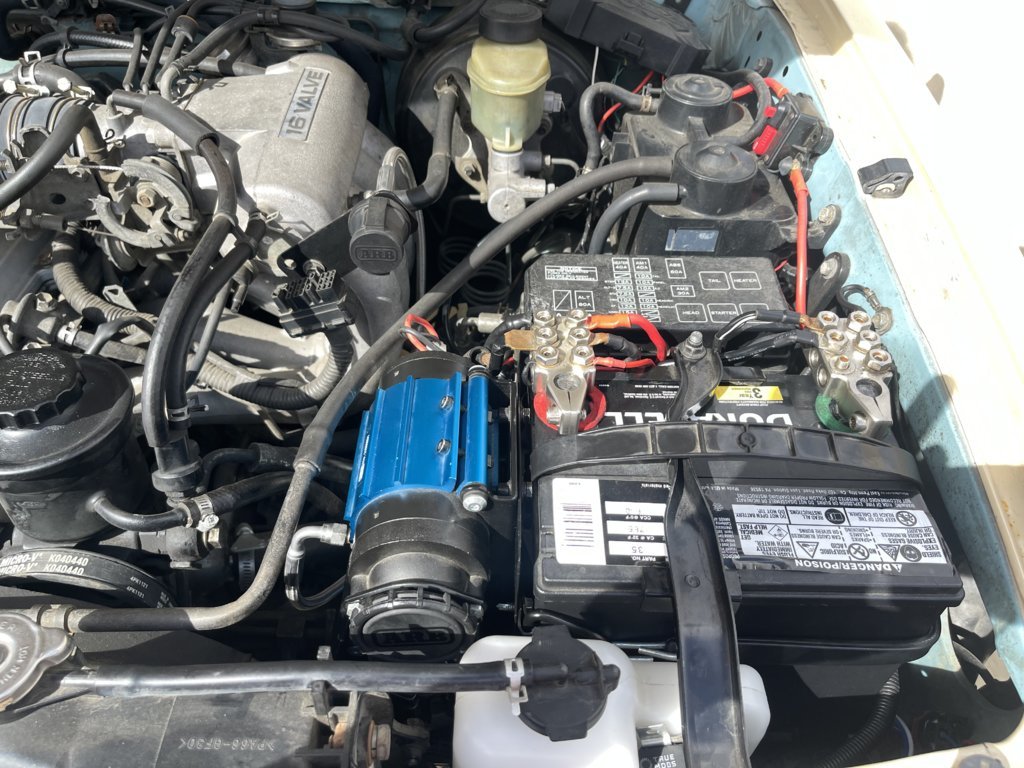

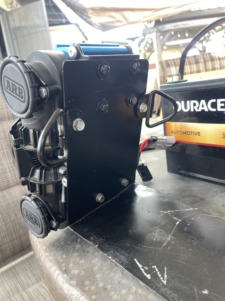

    I made a bracket for my ARB twin air compressor. I bent some sheet metal, drilled the mounting holes, and added anchor ties to keep the top heavy part of the bracket from moving as much while it running. I have a few other designs but since I can’t weld, this will have to do for now. Works great.

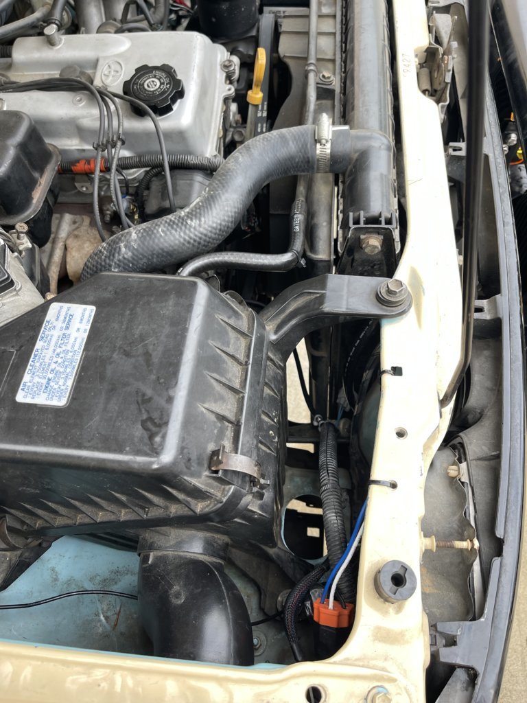

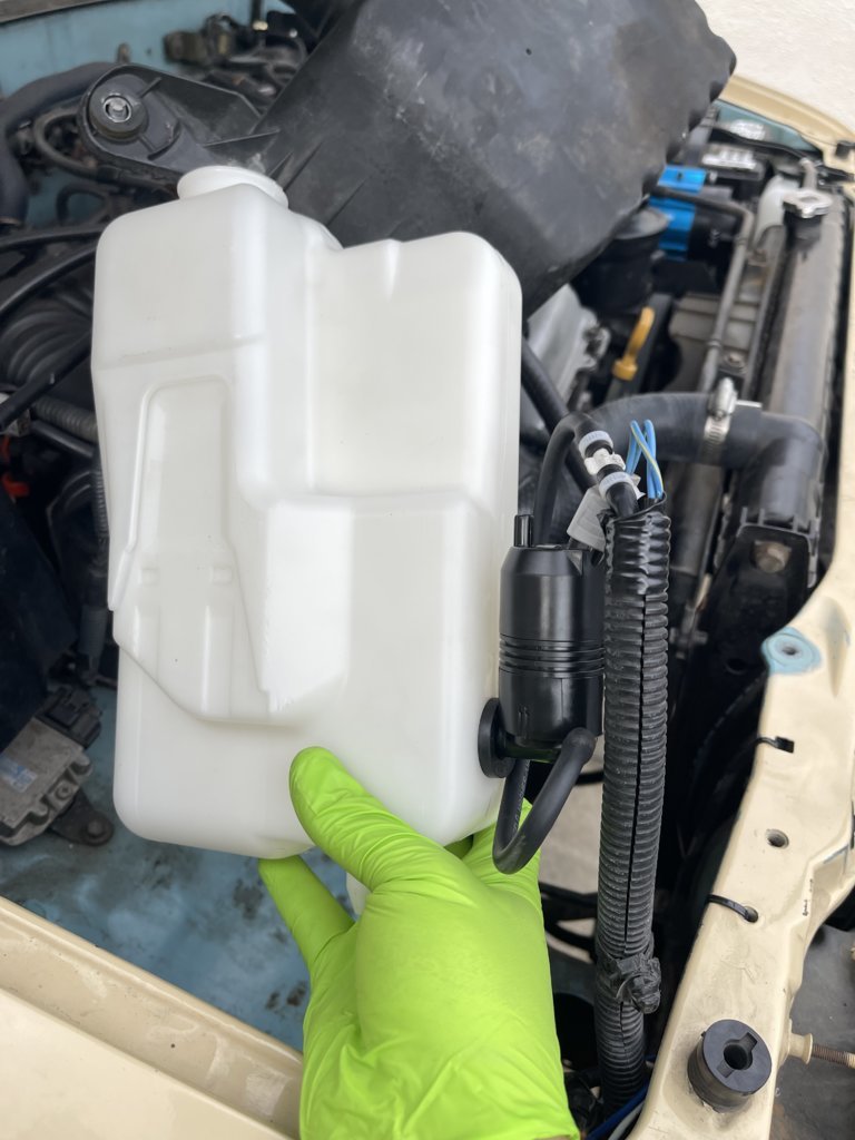

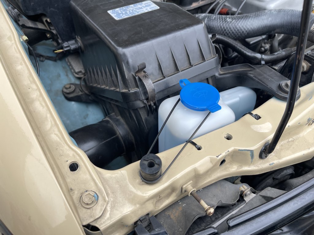

    I had to remove my large washer fluid tank to make room for a winch controller under my hood. The stock location was empty, And I noticed the coolant reservoir tank had the exact same shape I needed to get Get under the airbox mounting bracket.
    I ordered an extra coolant expansion tank and drilled the half inch hole and mounted the Toyota grommet and washer fluid pump near the bottom. It worked out really great, I’m going to 3-D print some sort of bracket for the filler neck area, but a zip tie works great for now.

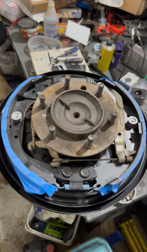

    Drums are easy when the axles are out :bananadead:

    Oh it's foreflight. Its got better ariel imagery

    I figured that's what it was. That's pretty cool.

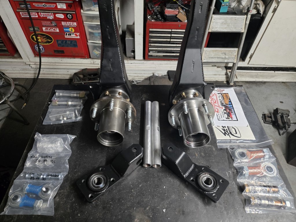

    Well, the rest of the steering arrived.

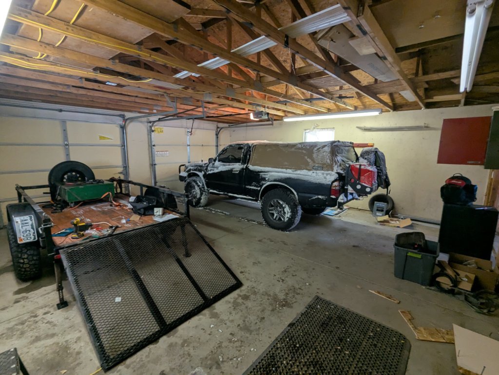

    Took the rent and rack off, put on the soft topper for moving into the new house. I'm very excited by the garage space with space that will be my fabrication shop.
    This also is probably the best this truck has looked in my opinion.
    Tons of work to do one the garage and new house.
