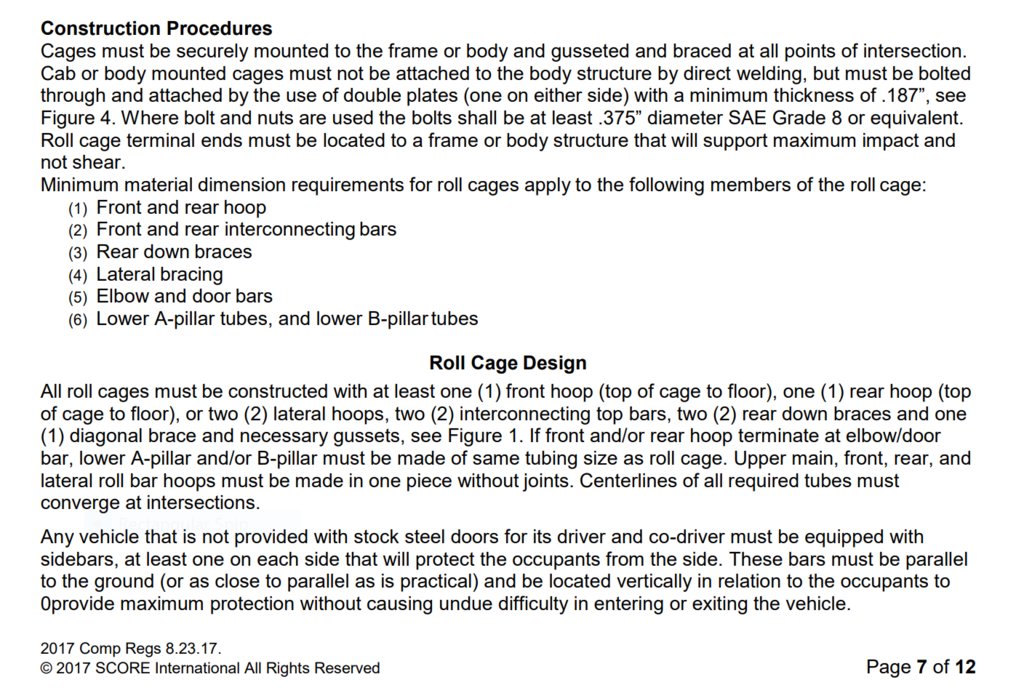

    The plan is to do the cage, then add in bars. I would do kicker bars at the door sills and gusset (or corner tube) from the kicker to the B piller. And run a cross bar from the B piller to the C piller. I'd also add in a dash bar, and a bar behind the front seats, with down tubes from the top tubes to the added cross bars. I'd also add in a few ceiling bars (the kit does have a center ceiling bar).
    It would actually get pretty close to sanctioned by the time I'm done. The reason for it is A) practice B) possiblity of high(er) speed roll over in the desert.
    As far as the Poly mounts go. Hammers, for example, will allow body mounted roll cages with just sandwich plates to the floor. (Not even directly mounted to the frame). Poly bushing frame tie ins direct to the frame are FAR stronger than that.

    Hammers rule book is based heavily off of SCORE. SCORE has, basically, the same rules applying to sandwich plates.
    If you comply with SCORE on safety tech, you pretty much comply with all offroad safety tech.

    The S pillars would have to go, and the 2 piece B and C pillars would have to go as well.
    You can make 2 piece pillars safe. You can't make them compliant. At that point, it would be better to just build from scratch, because over half the kit would have to be done over. And a bunch of cross bars and kickers would have to be added.
