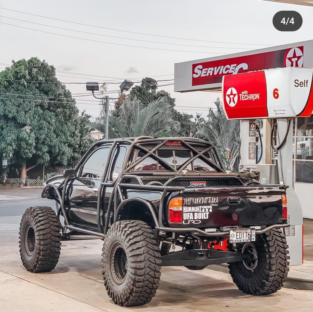

    Or you could be like this guy, but I think I'd rather just have an internal cage at that point lol

    That is the first exo I actually like, fucking bravo.
    Faztec1 likes this.

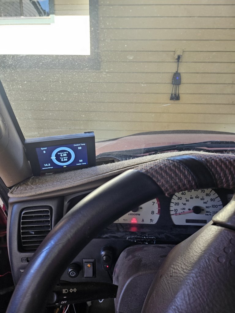

    926
    SC3 replacing a SC2, now i have an alarm in case my thermostat fails again.

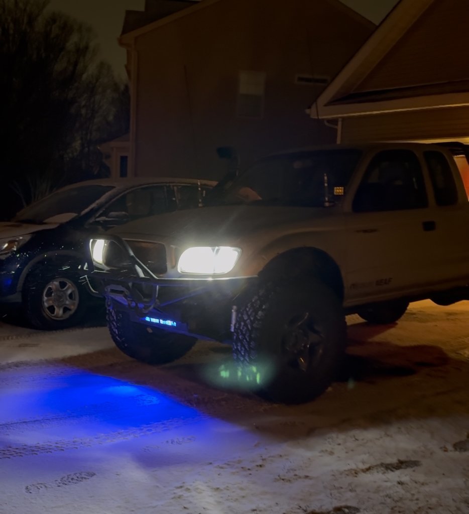

    Did this. 2003 SR5 2.7 4X4 5 speed extended cab. Original owner, won’t be able to add a whole lot more because I am old and retired. So there’s that.
