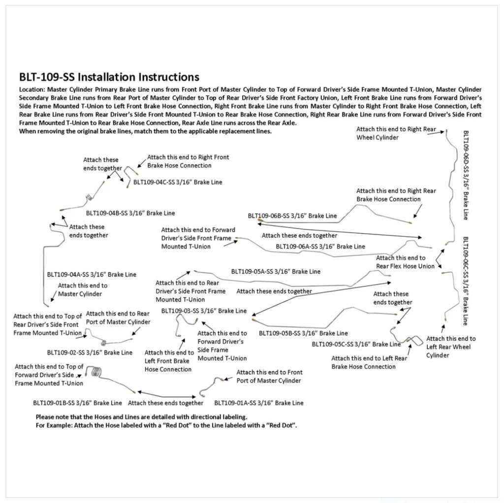

    Just doing a bit of searching. I may just do this.
    https://www.linestogo.com/products/...jyV7SSTB9LzldE835bUrc-EK3VNlEWEhoCk8kQAvD_BwE
    Basically, it's all the lines for a 3.4 Tacoma DC w/o ABS. Sure, there are a few lines I wont need, but this should cover all the hardlines I would need. And then just run them the same way as the truck. I'd probably add a manual proportioning valve, like the truck, while I'm at it.
    In some of the other reading I've done, the master cylinder may also need to be changed. But, I think I'd need to do that anyway. This will get Lexus front brakes and 4th Gen 4 Runner rear, also like the truck.
    I want to go bigger with the MC in the truck. I just haven't spent the time to figure out what bigger MC I should go with. (same would apply here.)

    I tried a larger MC and all that as well. Might be in that same post(again it's long). I did not like it. I went back to the 13/16th with single diaphragm booster. Much better pedal feel(more pressure) vs the larger one with dual diaphragm which is more volume(less pressure).

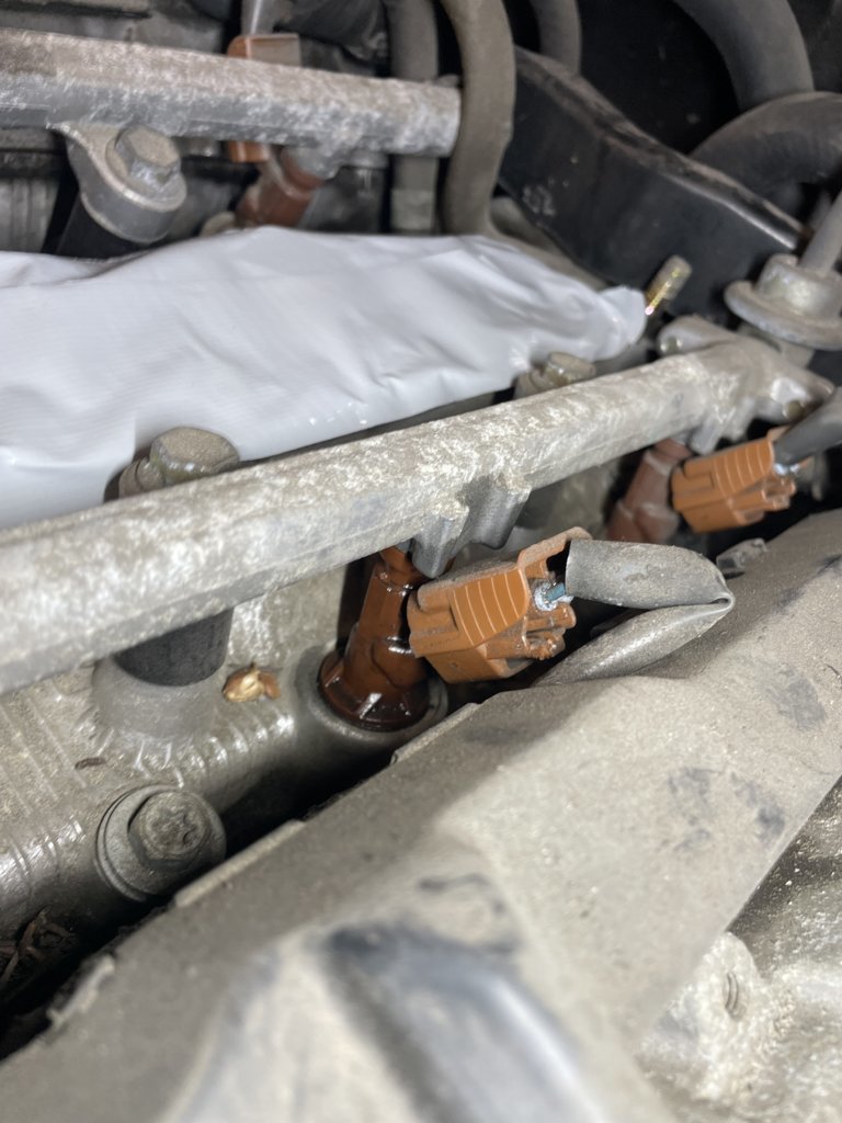

    Doing valve cover gaskets and I believe I caused my fuel injector to leak when I was wiggling the electrical connector free. Struggled to get this one off. Not positive that it wasn’t already leaking and not related to me though. Really don’t want to touch the fuel lines if I don’t have to. Anyone ever ran into this before? Can I check if this might leak somehow?

    I pinched a couple of the O rings when I swapped new injectors in. If you turn the key on it'll pressurize the fuel system and you should be able to see if it's leaking
