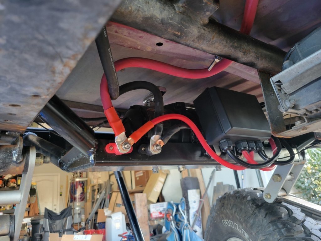

    When I ran 2/0 to my rear winch, it was 20 feet. (Well, it ended up more than 15 feet, so I was glad I bought 20 feet).
