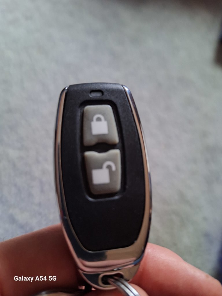

    I added keyless entry for less than $20.

    What’d you install? Or was it just a key fob that worked with your security system?

    It's just remote keyless entry. My security system is the manual transmission .
    My door lock on the driver's side sticks every now and then. Usually spraying a little graphite powder fixes it, but now that I've got the remote, I'll no longer have to walk around to the passenger side to unlock the door the next time the lock gets stuck.

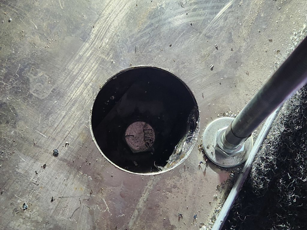

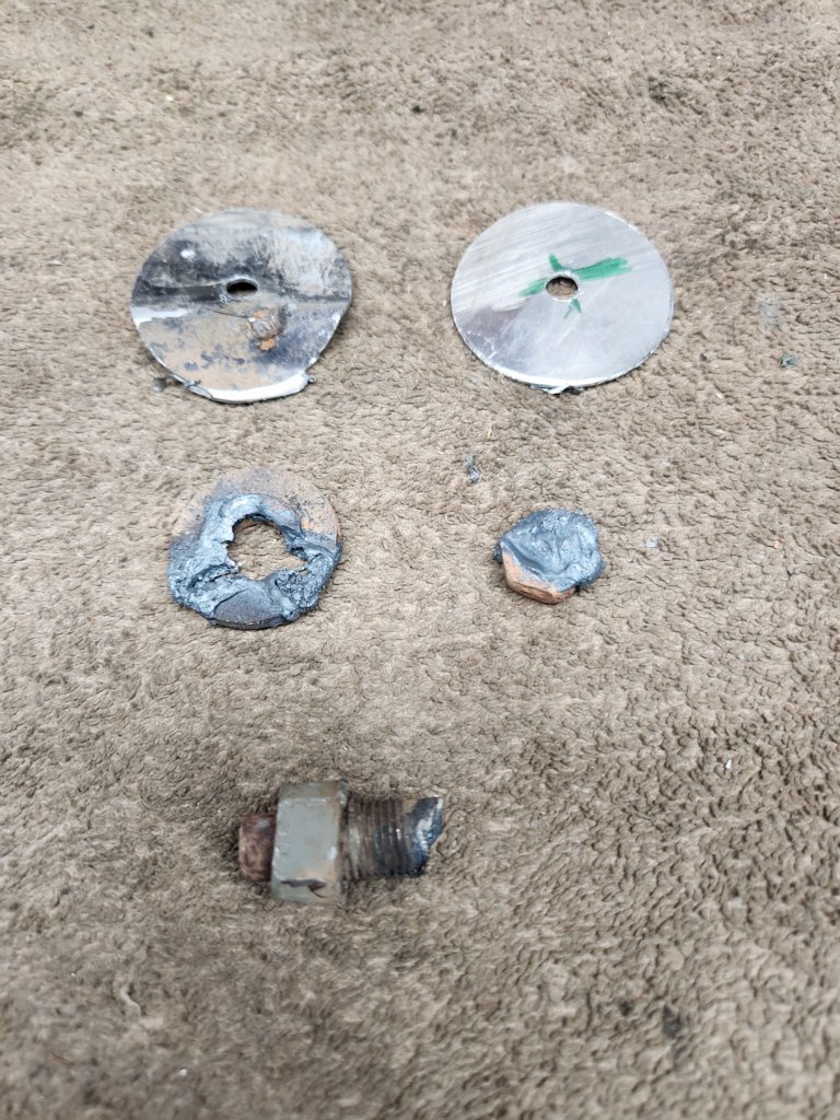

    I did this today.
    Added a wind deflector to my camper, I had this laying around and decided to use it.
    Also noticed that my bed and cab were moving differently. Crawled under my bed and found one bolt missing, and another one loose. Tried to tighten it, and the captured nut broke off the channel plate.
    So out came my house battery, and drilled a hole through the bed. I had to torch off the old bolt and installed a new one. This was not a fun project.

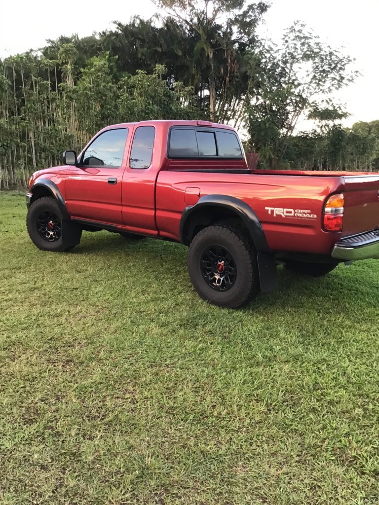

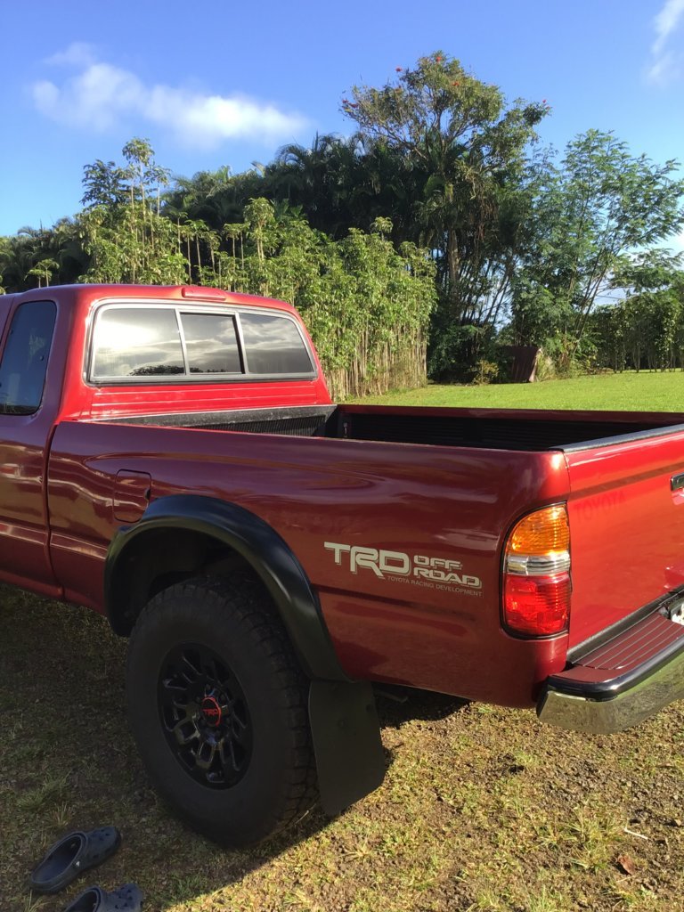

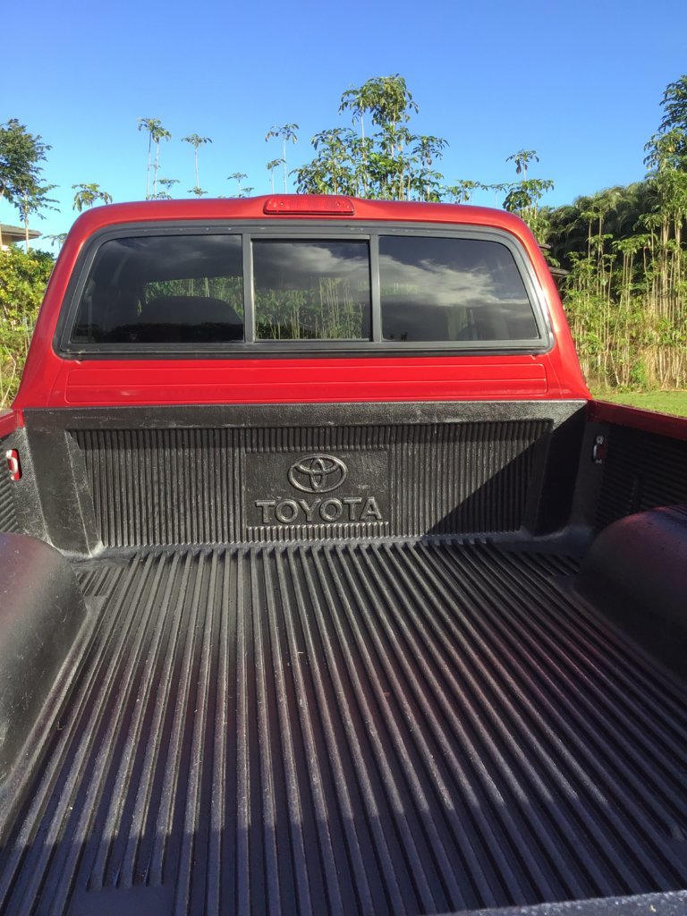

    Mostly cosmetic but she ain’t stock(looking) anymore.
    Removed my Leer topper and bed liner for the first inspection and cleaning since I’ve owned her. Fortunately no damage found and everything cleaned up nice, was wanting a spray on liner but just don’t have the money right now so had to change plans. Feels great to get that weight off the rear, drives like a truck now!

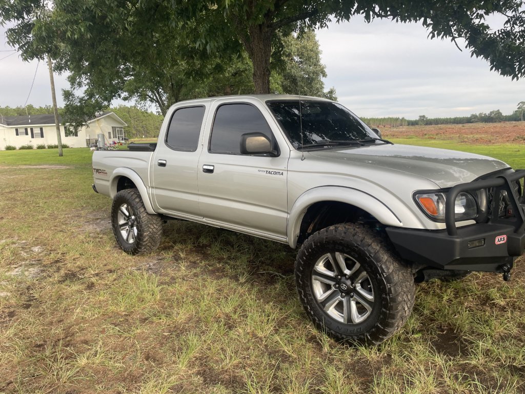

    Can anyone lend me a hand to figure out how big of a wheel spacer i would need? Running these 3rd gen Tacoma wheels with 33x12.5 MTs. They’re 7.5” wide and 18 or 25mm offset (I’ve found conflicting info). Already have a 1” spacer and I run the frame horrible and I’m barely clearing the UCA. I’ve also realized my camber is off. The tires are sitting with the top out ever so slightly, so to get it correct I know the tires will be hitting the UCA. I keep going back and forth between a 1.5” and 2”. BORA has an option for 1.75” but the price for a full set is steep not knowing if it would work 100%. Trying not to have the tires super far out of the fender well. I’ve already been down that road with my other truck.

    Don't go over 2 inch spacers. I've never run more than 1.25. And only use reputable spacers.
    You really ought to consider getting aftermarket wheels. Stock Toyota wheels have trash offset. They're really no good for 33s.
    People do it. I don't understand why. The only Toyota wheels that have ever actually looked good are the 4 Runner TRD pro wheels. (And they aren't very good for 33s either).

    Newer gen tacoma wheels are inset about 1'' more than OEM 1st gen wheels. So your 1'' spacer gets you back to close to stock offset. That said with a 12.5'' wide tire, stock offset is not enough.
    You'll probably want 1.5'' spacers. I ran those for years on 33x12.5r15s without issue. Helps to get ET thread lugs to hold the spacers on especially the fronts as the studs are short. use a torque wrench. Never had one ever come loose. I wouldn't go bigger than 1.5'' though.

    I’m finding that out about stocks and 33s. Wheel and tire set up was already on the truck when I purchased it. Just making do with what I have for now while I tend to other more pressing matters on the truck.
    Thank you blackdawg! This is the insight I’ve been trying to get.

    yeah you might be better off just getting different wheels. But can try the spacers first. They are cheaper after all. I ran 33x12.5r15s with 4'' Back spacing but they were on 8'' wheels. Since yours are 7" they might not be offset enough even with the spacers.
