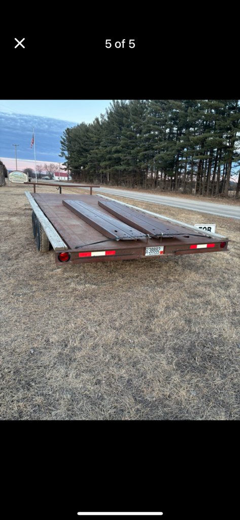

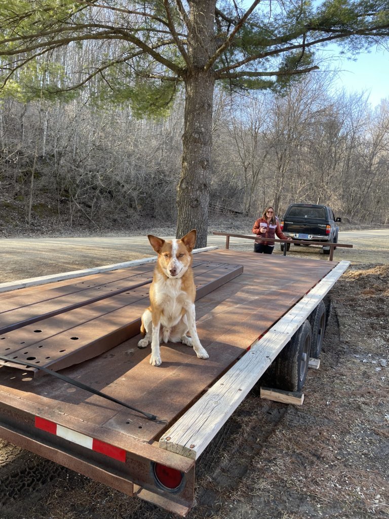

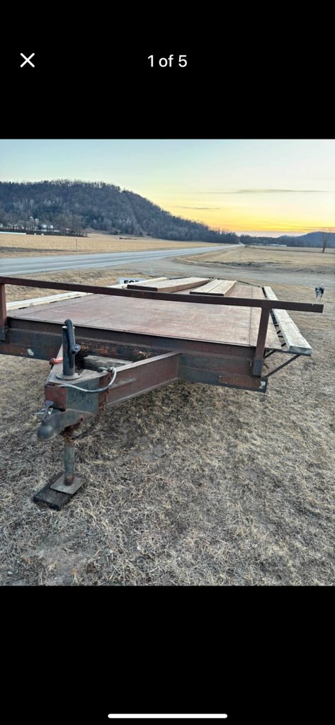

    You guys think I can pull this empty 20’ x 8’ steel flat bed trailer with my 04 V6? Not totally sure how much this thing actually weighs.

    It's less Tacoma and more mod
    That looks quite heavy, but I doubt it is over 5000lbs unloaded so probably

    Did you have the heater on full tilt during this process?
    Yeah be fine. Don't expect to go 65+mph with it. But should pull it empty. If you have an auto transmission watch your temps on hills

    Pulled it with ease. Probably in the 2,000 -3,000 lb range. Using this thing as a bridge to clear a creek on our property.

    When I pulled nearly 4,000# total of granite and 9x8 U-Haul ramp trailer at Interstate speeds of 70mph I tripped the A/T Fluid Temp light. And I had an auxiliary tranny fluid cooler up front. Slight grades and taking the tranny out of O/D seemed to exacerbate the temp issue.
    After this experience, I put an actual temp gauge on the aux cooler line so I will know EXACTLY what my tranny temp is.
    I do not consider the 5,000# tow rating to be applicable for highway speeds, but that's just me.
    ztwatson[QUOTED] likes this.
