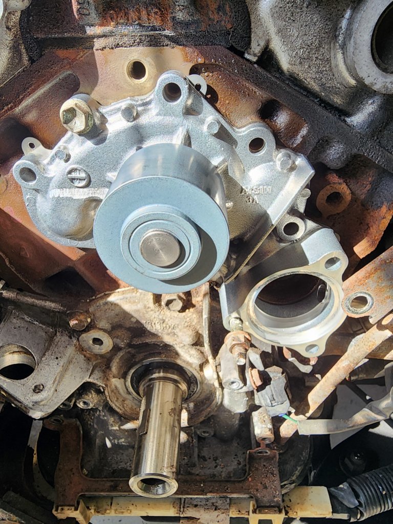

    Things are going back together on the timing belt/water pump. Used my tap/die set to clean the rust from the threads on the bolts, nuts, & mounting holes before reassembly as best I could. Hopefully it helps next time this job comes around. Or if I somehow screwed up something and need to redo.(Not too worried about the latter possibility.) Had an amusing realization looking at the old & new water pump side by side - I suspect they use the same casting & grind off the "Toyota" logo for the ones being sold as Aisin brand as opposed to Toyota pumps.

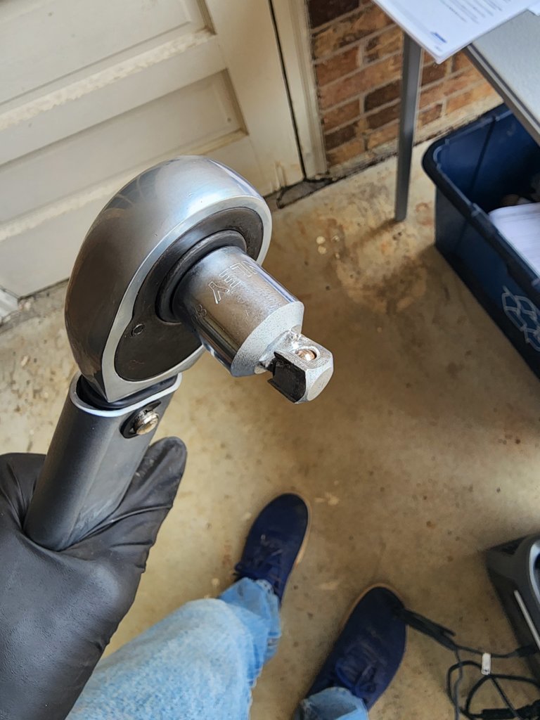

    Most of the way through reassembly on the timing belt. Pretty much need to put the radiator back in, and once I bleed it I should just need to do final tension on the alternator and PS belts. After I take it for a couple drives, I'll take it in to get the R134 evacuated and start on the compressor at my leisure. (Sooner rather than later, it heats up fast here in the Carolinas). Might need to take the AC tensioner assembly off the truck & either replace or completely strip off the rust & repaint it, I tried to adjust the idler by way of experimentation and it is STUCK, even with several applications of penetrating oil + plenty of swearing. Also gonna need a new lock nut for the AC idler, the old one's threads are completely gone.
    On a slightly more amusing note, the crank pulley bolt needs more torque than my 1/2 (F):3/8 (M) adapter could take. This was not on my list of things I was worried about breaking with muscle alone.20250315_144541.jpg
    Oops.

    Slightly happier for me - finally finished this timing belt, so truck is back on the road... with one less fastener than it had at the start of the job (Deliberate. It just holds in the drivers-side marker light, and it was a crappy aftermarket one that didn't really fit right. The screw securing it to the grille, which was doing most of the work anyways, will have to do.)
    Casualties are the aforementioned 1/2 to 3/8 adapter and an OEMTools version of the Lisle spill-free funnel. It worked until things seem to have filled basically all the way up, at which point it stopped maintaining the seal and started spilling its contents all over the front of my truck. Thankfully the air seems to be entirely out of the system, and I'm keeping an eye on the expansion tank fill level. I'll probably daily this for the week just to make sure everything's hunky-dory with the coolant, but everything was good on the test drive.
