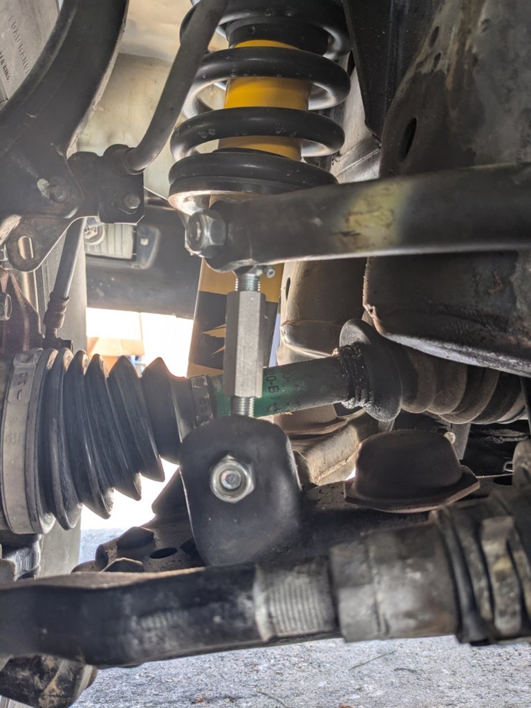

    I did a 1.5" OME lift with a 1.5" Icon add-a-leaf out back and have been waiting for some universal clevis pins to show up so I can put on new adjustable endlinks, finally got tired of waiting for the backordered clevises so I picked up some m12 hardware and got the things installed.

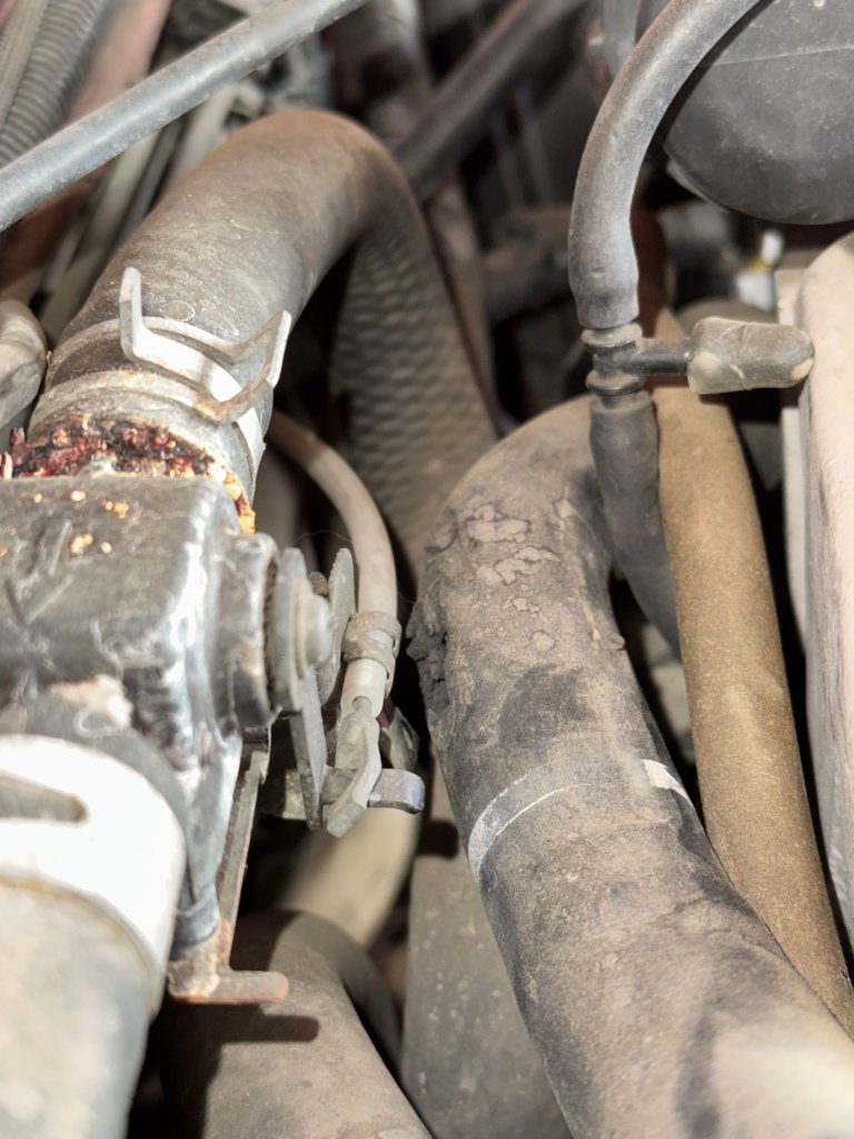

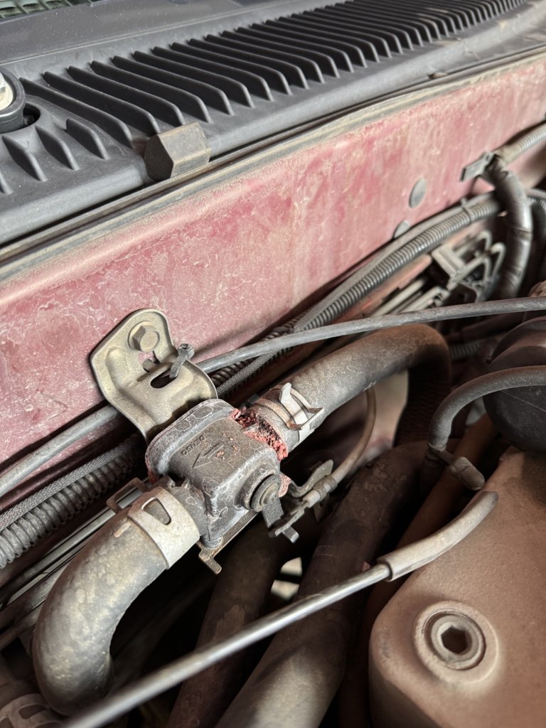

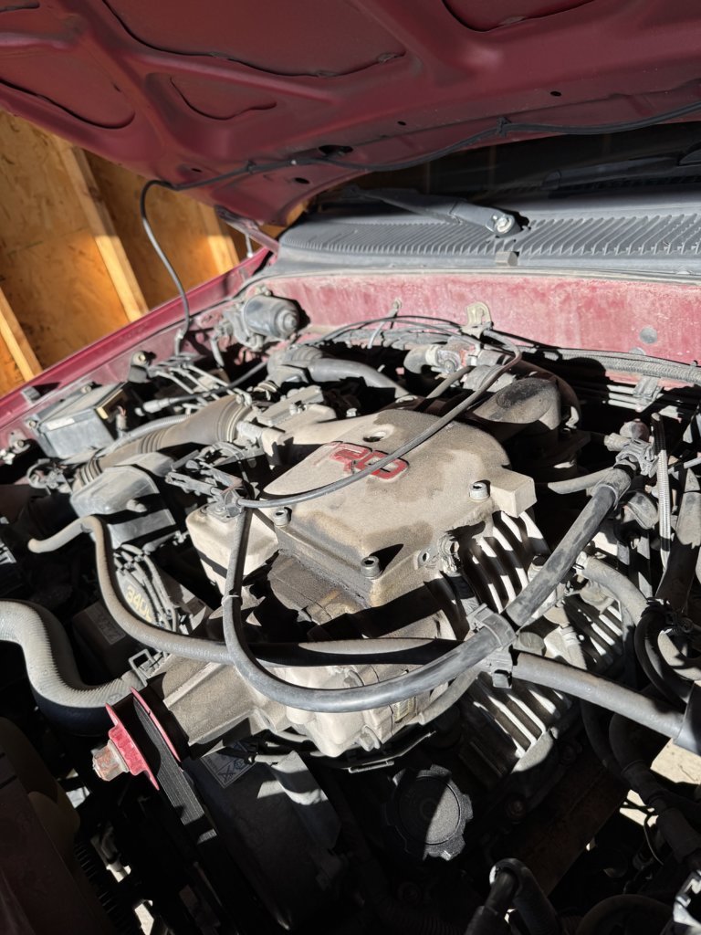

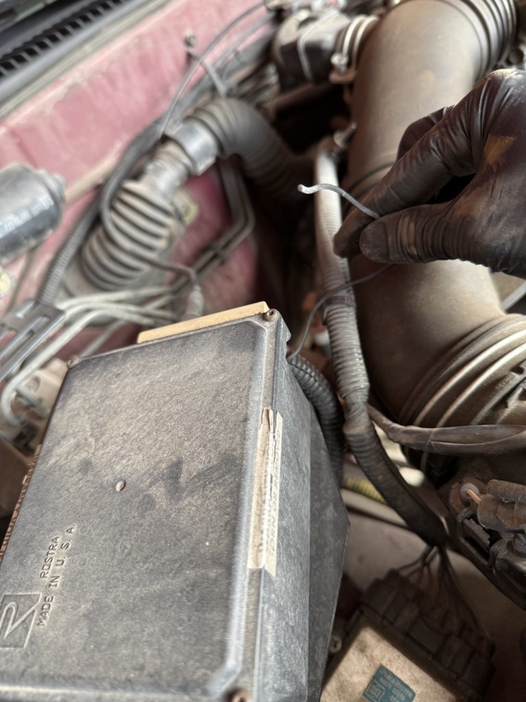

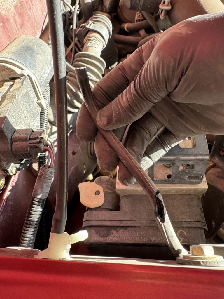

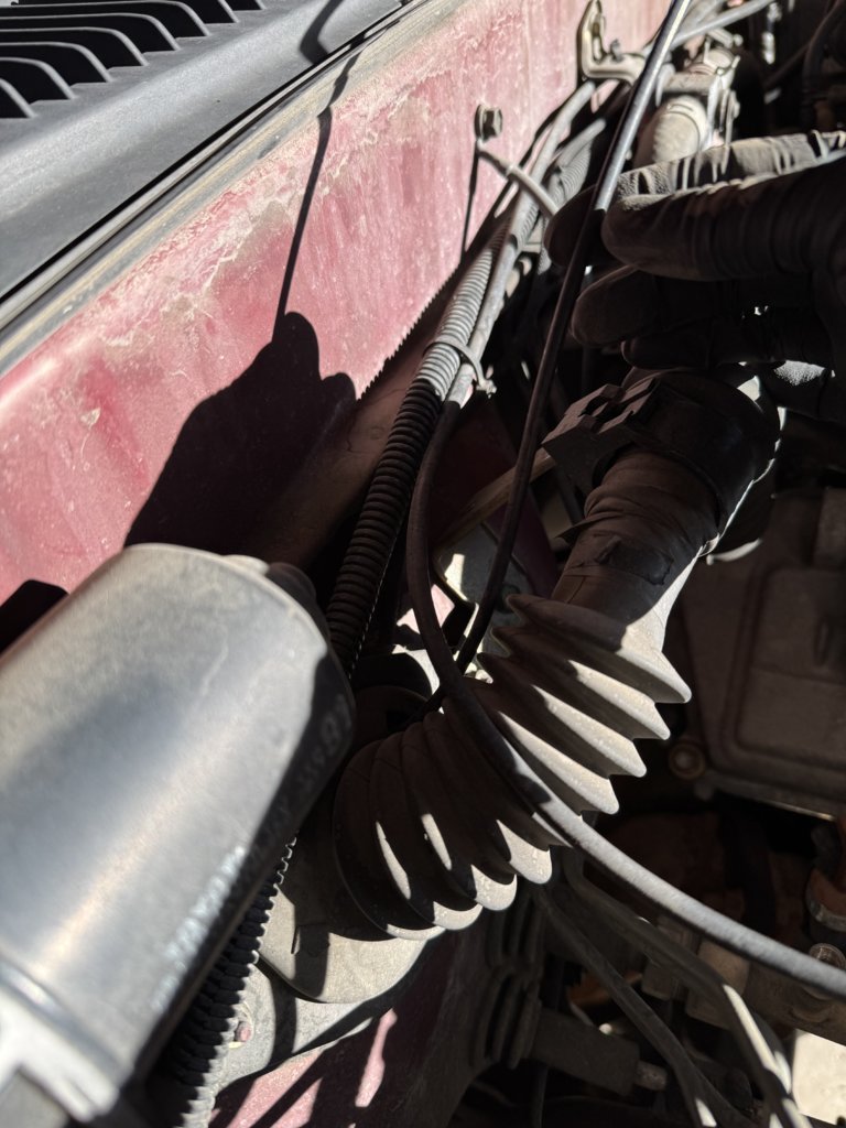

    Giving the Tacoma some more attention lately and looked at some deficiencies. Hoping some of the other experts here can help me out with some insight.
    Anyone have any idea what this hard line goes to? It’s not a silicone/rubber line, moreso a hard plastic. It’s been cut.
    Not too radiator inclined, for what reason would this cake up?
    If anyone has this part # for this soft hose that’d be much appreciated, don’t know what its purpose is. Found a large crack and might be the reason for my intermittent p0171.

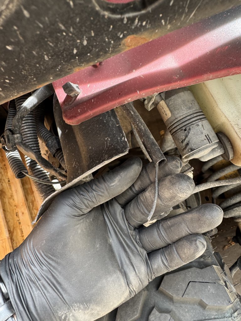

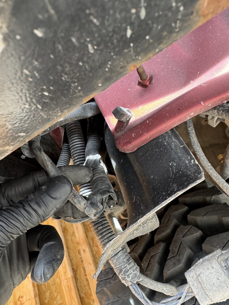

    This one has stumped me for the longest time. What is this possible ground to? It is down by the washer reservoir and turn signal/parking light harness. It is found in this sleeve.

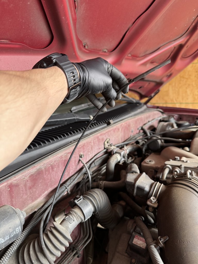

    The same for this possible ground/wire, are these related? I did not install my 7th injector kit myself so perhaps that’s intentional? By this cruise control unit.
    Unrelated but looking for this size line for the windshield washer if anyone has that.
    Finally, shameless s/c plug. Will need to reseal with perma at some point.

  15. Mar 22, 2025 at 6:44 PM
    benson winkleberry
    benson winkleberry Well-Known Member
    Mar 20, 2023
    #420588
    139
    ‘00 taco 2.7 4x4 MT

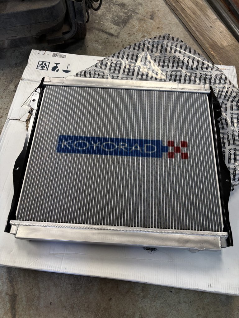

    Front end rebuild and koyorad upgrade complete
  16. Mar 22, 2025 at 6:55 PM
    Tacoscar-the-grouch
    Tacoscar-the-grouch Well-Known Member
    Mar 22, 2019
    #287551
    331
    Josh
    North Idaho
    2001 Reg. Cab Tacoma
    OME kit 4.56's 235/85/16
    that’s the valve to adjust coolant supply to the heater core, and therefore control the amount to heat in the cab. Looks like the inlet side is weeping and as the coolant dries it leaves that red precipitate.
    If it was me I’d replace the hose and hose clamp, or maybe just throw a new hose clamp on if you want to be a really cheap to see if that solves the problem with the hose sealing. If it keeps leaking the valve may need replaced.
    That amount of gunk is a very small leak. Could wash it off and check at the next oil change to see how fast it accumulates. If your heat works it might be a non issue.
    Others may have more insight. For example, there is a chance that your heater core is getting clogged and leading to pressure in the valve. I’ve not had issues with my heating system so don’t have a lot of experience there.

    That’s the boost reference for the 7th injector, it’s not cut that’s just the coupling to attach it to a barbed fitting on the back of the SC. Ideally it is connected to the fuel pressure regulator and the boost reference is T’d in.
    I would imagine without that hooked up, your 7th injector isn’t doing a whole lot in boost.

    Thanks for the response, very interesting as I don’t have a heat issue but actually an A/c issue as of the past 6 months at least. The truck has no issues heating in the cab but no cool air.
    With no boost gauge nor afr it’s not conclusive enough for me to butt dial. However I have noticed a lack in power. Thanks, I will look into the routing.

    I see what you’re saying now after looking at the URD instructions. Any reason this would be capped off on the T?

    Was the SC removed, like for a rebuild or something? Maybe that was capped while it was off and the stock intake manifold was on. Although I guess that wouldn’t really be necessary if the 7th injector controller was just unplugged.
    I’d hook it back up, you might find that lost horsepower.
