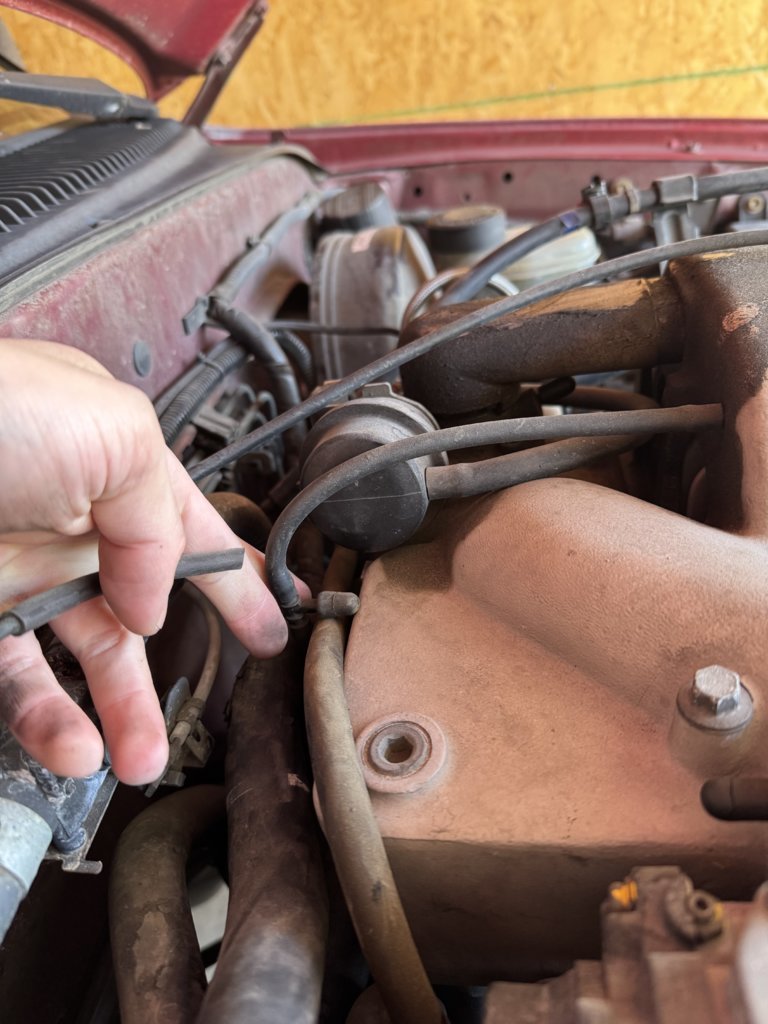

    Yeah I went ahead and remarried the fitting. Went for a test drive after and the butt dyno was happy. Thanks for the input man.

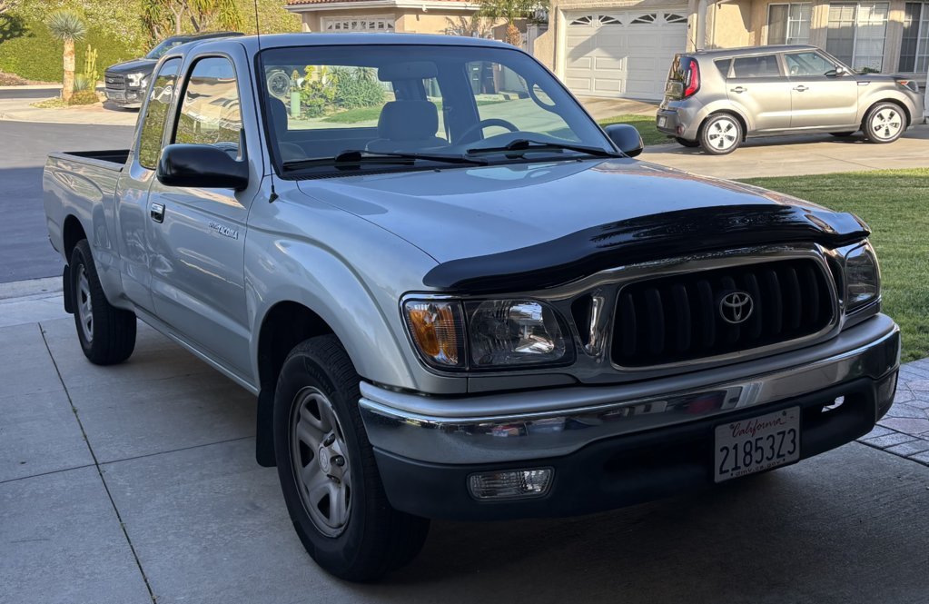

    Added new AVS Bug Deflector and went back to original side mirrors

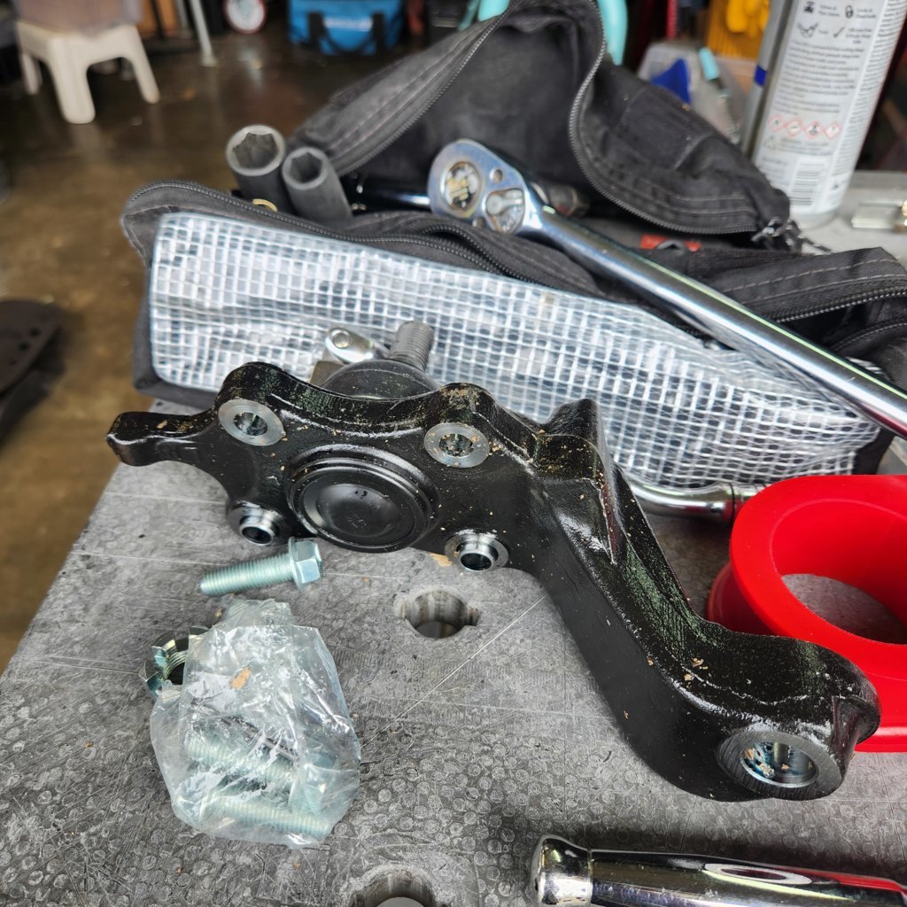

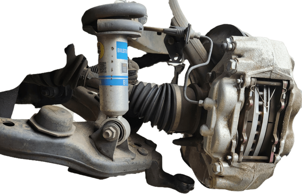

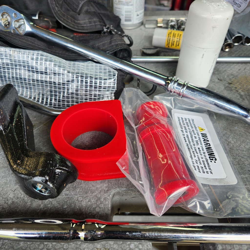

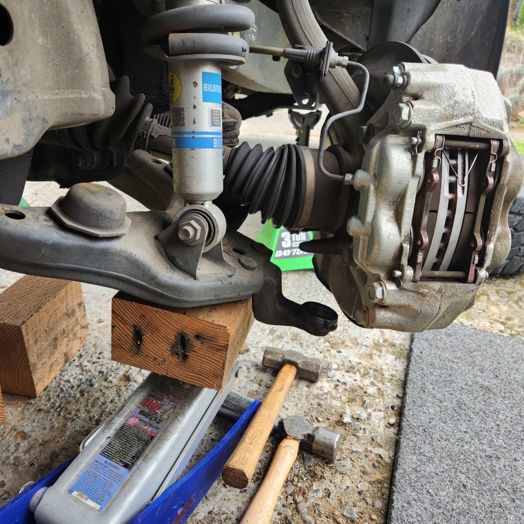

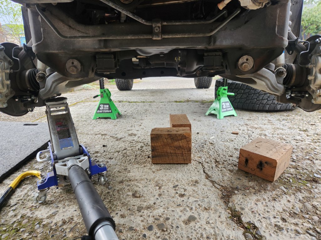

    Longish day of Tacoma-work.
    • Lower ball joints - went well, glad I had a joint puller because the driver side was a bear to break loose, as well as , the outer tie rod end.
    • Replaced rack bushings with Total Chaos - alignment shop said there was play. Weird as I had Toyota replace the steering rack (not cheap). Oh, well.
    • While everything was apart did some maintenance - oil & filter, gas filter.

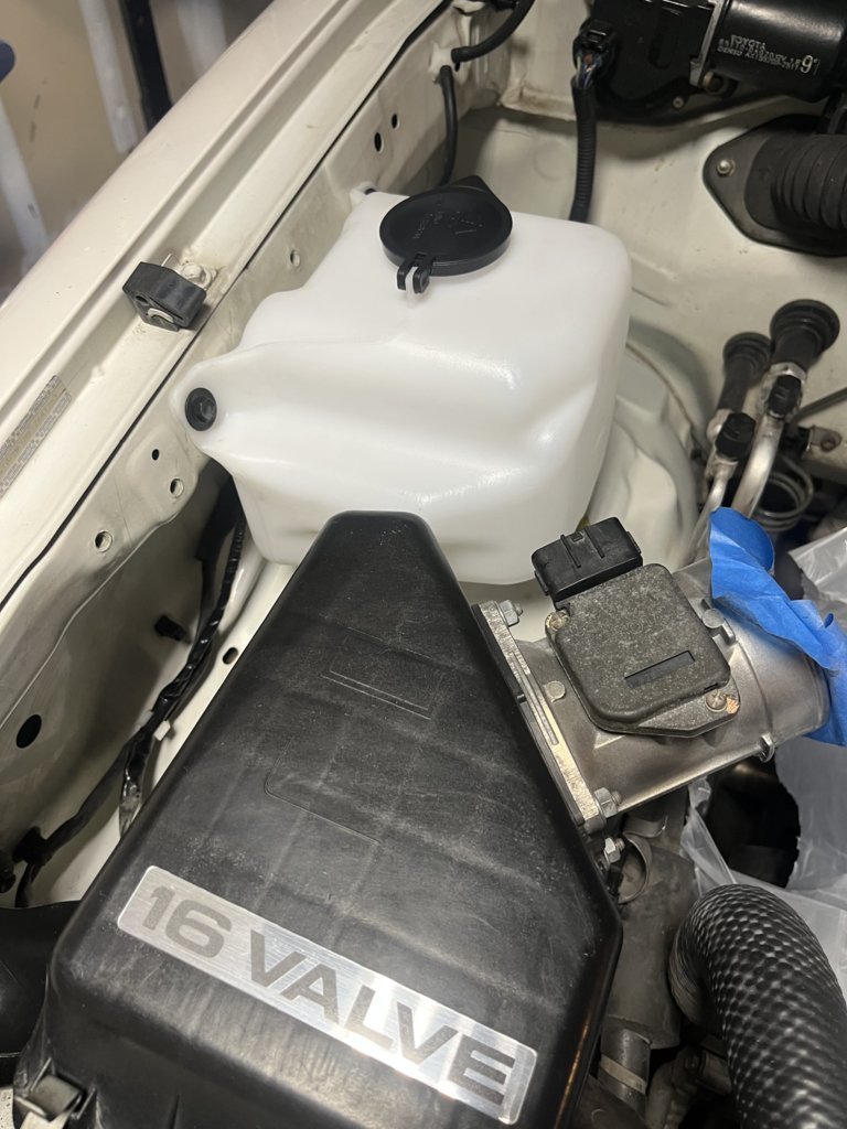

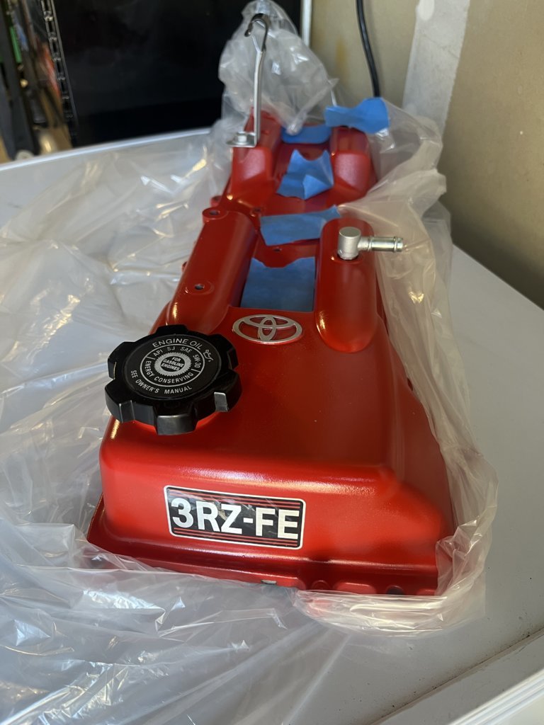

    Freshened up Valve cover with my favorite color scheme (Sante Fe warbonnet) + 3rz-Fe emblem, cover gasket, cylinder seal gaskets, plugs, coils, wires, etc
    Wiper reservoir relocation + getting rid of low fluid sensor
    OEM mini-header + Y pipe ceramic coated with new o2’s, studs, nuts

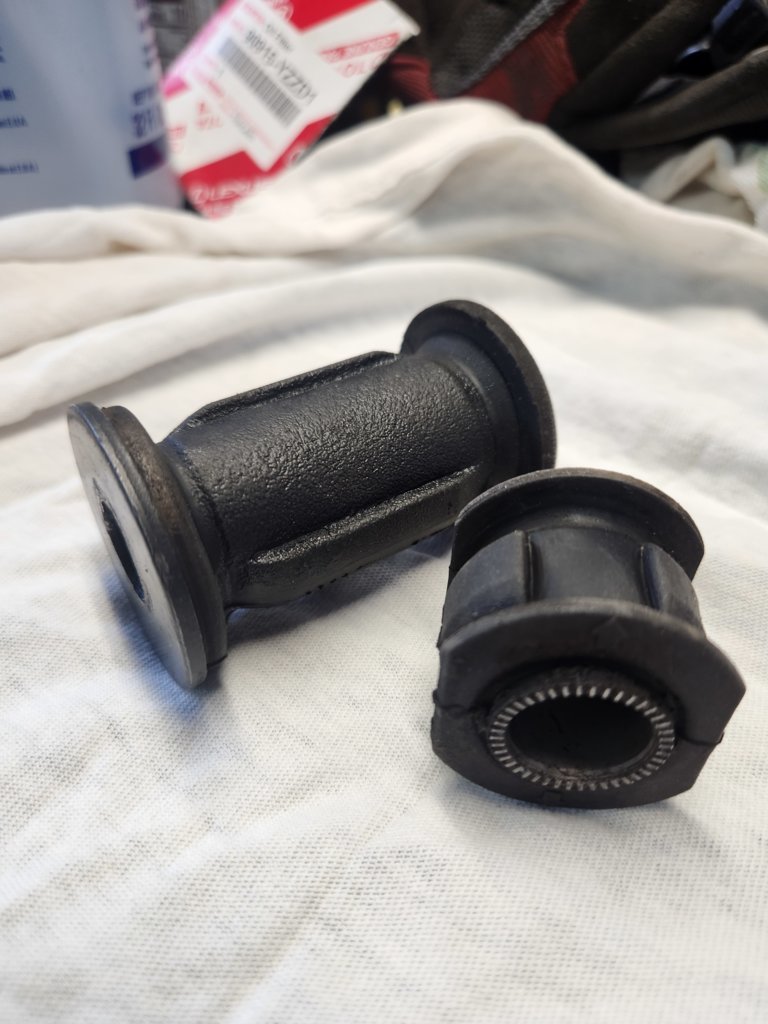

    Speaking of quality ... the steering rack was replaced by Toyota dealer, new and expensive, early on after I bought the truck.
    When I was dropping the rack down I noticed the DS had 2 inner washers. Strange. One was "stuck" to the bolt and I had to pound the bolt to get the washer loose so I could pull the bolt out.
    Anyway, what I found after figuring out how to push the bushing out is there is a fixed washer pressed onto the bushing sleeve. (What a bugger to figure out how to press it out!)
    Seems dealer mechanic should not have installed the original (but thankful he did so I had a washer for new bushings), which means my steering rack was not as flush as it should have been.
    Also, doesn't look worn, but oh well, had the Total Chaos sitting on the shelf for a while. You can see the fixed washer.
