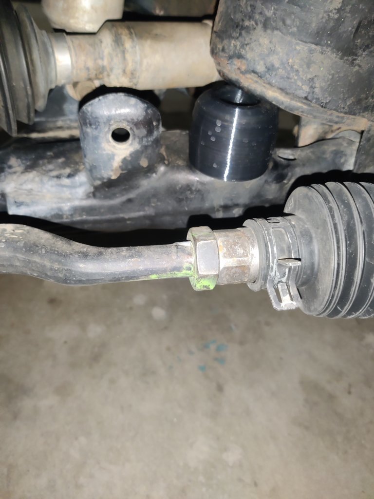

  3. Apr 9, 2025 at 11:54 PM
    unstpible
    unstpible Well-Known Member
    Aug 16, 2012
    #84909
    3,931
    Derek
    Cedar City, Utah
    03 4x4 boosted V6 Auto 341k miles
    CX Racing Turbo kit. TransGo shift kit. All Pro Apex bumper and skids. Smittybilt XRC 9.5 winch. All Pro Upper control arm's. Bilstein 6112's with 600lb coils. Eimkeith's lower control arm reinforcement plates. Perry Parts bump stops. All Pro spindle gussets and alignment cam tabs. All Pro standard 3" leaf springs. Bilstein 5125's rear. Extended rear brake lines. Rear diff breather relocation. MagnaFlow catback with resonator. Bluetooth stereo. Memphis 6x9 door speakers. Diode Dynamics SS3 Pro Amber fog lights. Single piece headlights. aftermarket grille. Anzo taillights. LED 3rd brake light. 4runner sunglass holder and dome lights. Master Tailgaters rear view mirror with 3 directional cameras, G shock sensors, and anti theft system. Honda windshield washer nozzles. Stubby antenna. Scan Guage II. 2nd Gen Snowflake wheels powder coated black. Cooper Discoverer ST Maxx 235-75/16 Denso 210-0461 105 amp alternator. Speedytech7's big wire harness upgrade. Aeromotive 340 fuel pump. Haltech Elite 2500. Tacomaworld sticker. Tundra brakes with Adventure Taco's hardline kit
    Replaced 3/4 LCA bumpstops.
    The 4th one yeeted the internal welded nut that holds it in place so I'll be looking into a rivnut tool
    I've been Super happy with my @perryparts Bumpstops and I'm stoked to try out the new version being released. Patrick hooked me up after I abused the original design for a couple years
    Check these bad boys out here
    https://www.perryparts.com/product-page/ab4f-tacoma-1st-gen-front-bump-stops-1995-2004
    Thanks again Patrick :hattip: seriously awesome customer service

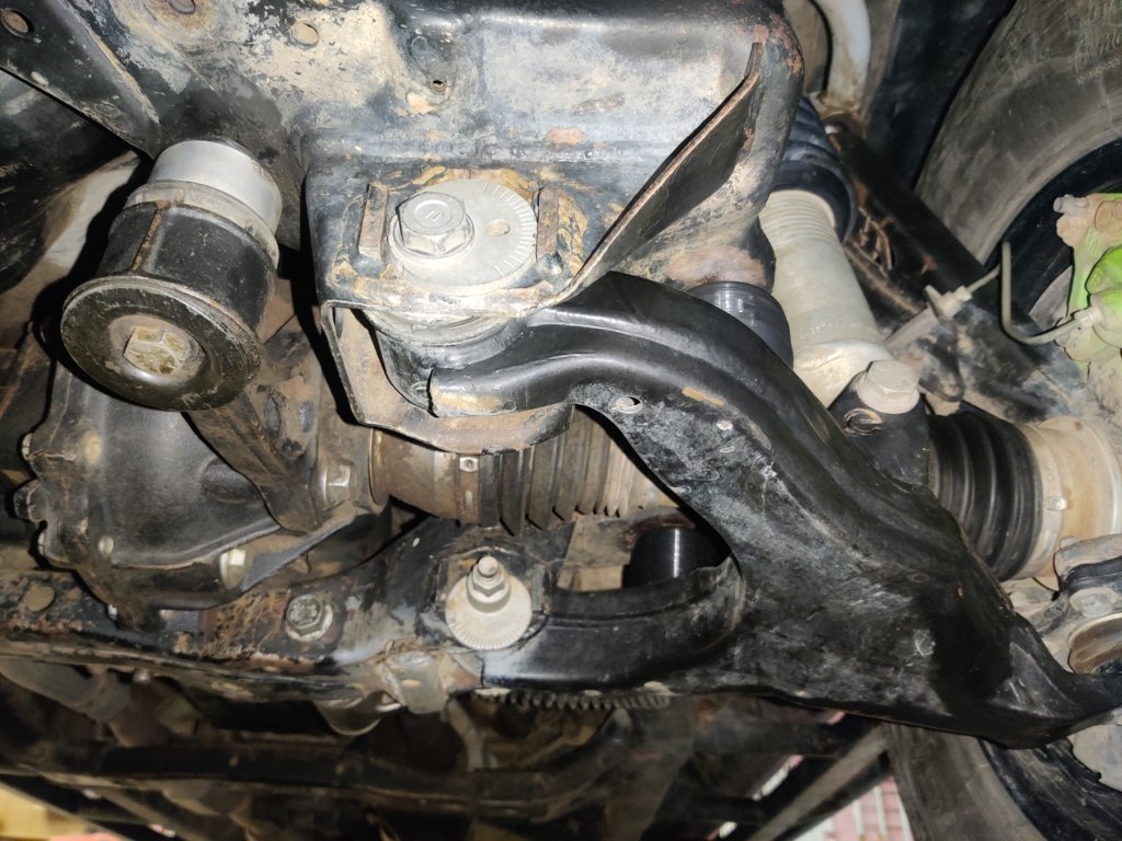

  4. Apr 10, 2025 at 4:20 AM
    cynicalrider
    cynicalrider #NFG
    Jul 25, 2012
    #83399
    17,196
    Jersey
    01 SR5 TRD 4x4, '23 Bronco Wildtrak, 2017 HSQV FE350
    Drop bracket lift and booger welds
    If you have a welder you can do my solution:
    [​IMG]Untitled by MJH Creations, on Flickr
    I probably went overkill but since you need to grind it flush to have the bump sit flat I cut into both sides so the weld could then grab the nut from the side as well.

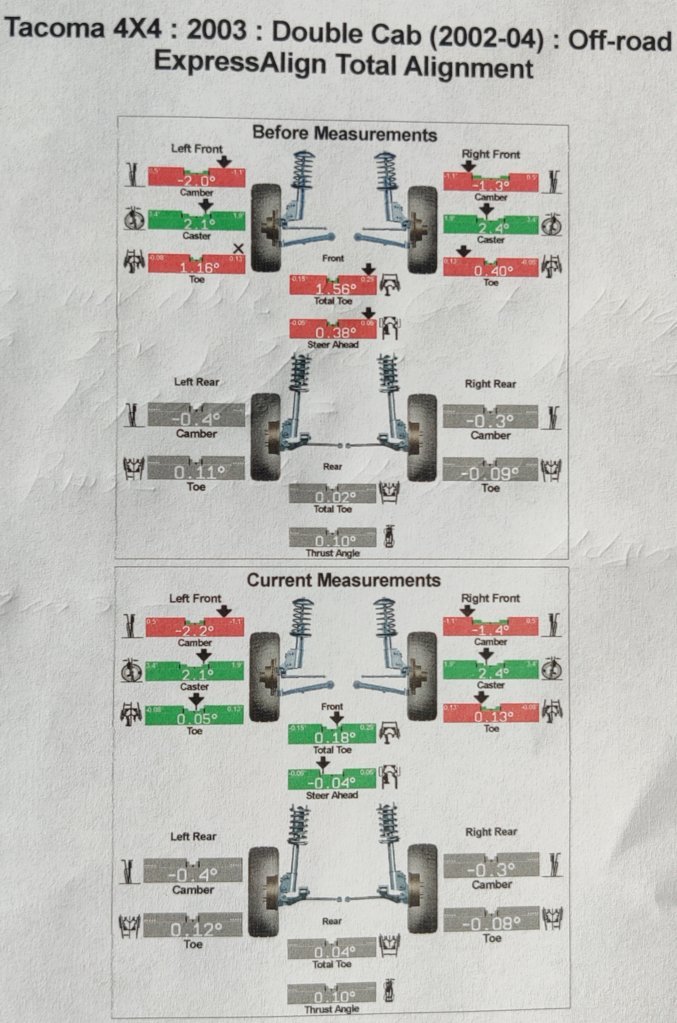

    Update with spec sheet

  12. Apr 10, 2025 at 11:10 PM
    Digiratus
    Digiratus Adventurer
    Mar 26, 2010
    #34006
    23,855
    Roaming the PNW
    The RedHead
    2002 XtraCab TRD 4x4 SCv6 AutoTrans With Lots of Mods ADS COs w/Compression Adjusters Camburg Uniball UCAs Whiteline Lower Control Arm Bushings Kartek 7" Limit Straps Plastics Guy Front Bumpstops Total Chaos Sprindle Gussets Custom Alcan Springs +800 lbs +3" ADS 10" Stroke Triple Bypass w/Resi Rear Shocks Custom Rear Shock Relocate All-Pro U-bolt Flip w/Timbren Bumpstops 4.88 Nitro Gears ARB Front Locker ARB Twin Compressor Black 17x8 Konig Countersteer Type X 285/70r17 Falken A/T3w Gunmetal 16x8 SCS Ray10s 255/85r16 Maxxis Bighorns Limited Edition (Relentless) Elite Front Bumper Smittybilt X2O 10K Winch Diode Dynamics SS3 Sport Selective Yellow Fog Lights in the Bumper Diode Dynamics SS3 Pro 4,000 Kelvin SAE Driving Lights with Clear Lenses on the Bumper Morimoto D2S Projectors XB35 Ballasts + 4300K Bulbs Badland Sliders FrankenFab Tire Carrier Swingout bumper w/kitchen BudBuilt Front & Bellypan Skids BAMF Rear Diff Skid Dometic CFX 55im Fridge/Freezer Alpha II Hardshell RTT Badland Custom Bed Rack Denso 210-0461 105 amp alternator Dual Northstar 24F AGM batteries BlueSea 7622 ML-ACR Battery controller Peak DBI Dual Battery Voltage Monitor Haltech IC-7 Display with Mako Dash Insert Haltech Elite 2500 Standalone ECU Magnuson MP62 Supercharger w/URD 2.2" Pulley Doug Thorley Headers Denso 650cc Fuel Injectors Aeromotive Stealth 340 Fuel Pump TransGo A340F Reprogramming Shift Kit OEM ECU Delete Full A340F Trans Control with the Haltech 2500 ECU 2.5" Magnaflow Hi-Flow CAT Magnaflow 18" Muffler w/Vibrant Resonator 13WL Brake Calipers with OEM Rotors & Pads Braided Steel Brake Lines Kenwood TM-71A Dual Band Ham Radio STI-CO Flex Whip VFH/UHF 1/4 Wave Antenna Midland MTX275 GMRS Radio w/Roof Mount Antenna Pioneer DEH-P9400BH HU Alpine Amps & Type R components (F) and coaxials (R) Wet Okole Seat Covers Weathertech Digital Liners Deck Plate Mod 1" Diff Drop Carrier Bearing Drop
    I would not be happy if they gave it back to me like that. Doesn't look like any effort was made on the LCA cam adjusters. Are your adjusters frozen?
    Also, Toe is not great. Better than before but still not great. Especially on the passenger side. Likely to see tire wear from that. A little positine toe is ok but needs to be close to symmetrical from side to side.
    turbodb likes this.

    Well it's been a long work in progress with little progress.
    The first time I took it in for alignment the cams were seized. After that I did new LCA's and had the Wheelers cam tabs welded in before adding new cams and outer tie rods from Toyota then took it back but still didn't have great numbers and it was still pulling to one side. even had a buddy at Big O in St George try it and didn't get great results from them either (but at least they didn't charge me because they couldn't make it any better).
    Then I took it back to the local shop for the 3rd time for after I replaced the steering rack and those are the numbers you see above.

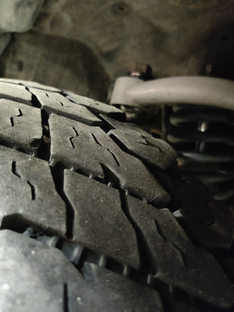

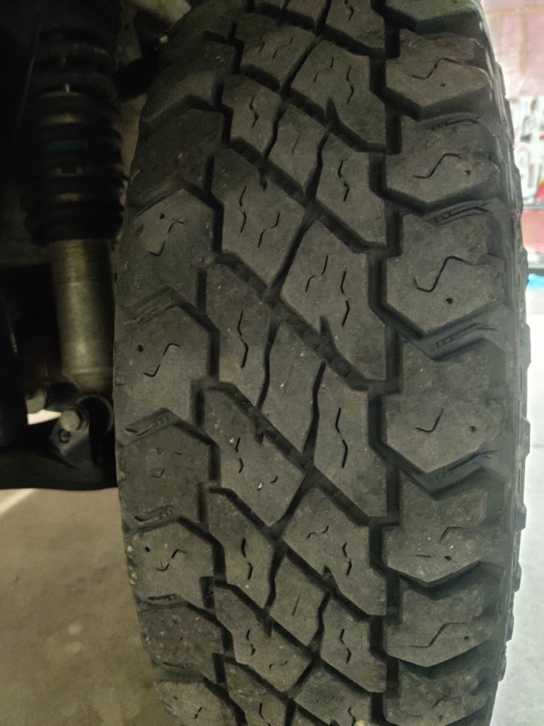

    A picture is worth 1000 words so let me paint you a novel that is my current alignment (also the steering wheel is probably off by one spline from when I installed the new rack so it's not perfectly straight either).
    drivers side tie rod is maxed out
    Passenger side tierod has some wiggle room
    Front drivers side cam is maxed out
    Passenger side cams have plenty of adjustment left
    And the poor tires being eaten alive by the alignment more so than having fun
    Photos aren't great but you can see the uneven wear that almost skips every other lug on the inside
    Lighting isn't great for quick photos at 1am in the garage but it's pretty obviously bad

  14. Apr 11, 2025 at 5:11 AM
    cynicalrider
    cynicalrider #NFG
    Jul 25, 2012
    #83399
    17,196
    Jersey
    That scalloping also happened to me on my st maxx's
  15. Apr 11, 2025 at 5:54 AM
    Reh5108
    Reh5108 Well-Known Member
    Feb 18, 2013
    #97832
    5,802
    Idaho
    2004 SR5 4X4 2.7L Extra Cab
    OME lift, 4x sliders, Demello rear bumper, custom front bumper, Engo 9000lb winch
    Looks to me like they prioritized castor over camber. Should be able to adjust the rear cam to get better camber numbers.
    When I ran Maxx they wore similarly too.
    unstpible[QUOTED] likes this.
  16. Apr 11, 2025 at 6:37 AM
    jubei
    jubei would rather be doing something else
    Mar 17, 2016
    #181549
    6,066
    Jason
    NoCo
    White 2002 XC TRD and Yellow 1971 JEEP CJ5
    Stuff. Also things.
    Same.
    unstpible likes this.

  18. Apr 11, 2025 at 8:16 AM
    turbodb
    turbodb AdventureTaco
    Feb 9, 2016
    #177696
    8,573
    Dan
    PNW
    2000 Tacoma Xcab 4x4 SR5 V6 TRD
    AdventureTaco
    I had a little bit that you could feel, but nothing like that... and only when I got down to the wear bars. Mine were always overinflated though, b/c I wore the center of the tread more quickly than the sides.
    Edit: and on mine, it was only on the outer lugs, not the inners.
    unstpible and Reh5108[QUOTED] like this.
  19. Apr 11, 2025 at 8:31 AM

  20. Apr 11, 2025 at 12:07 PM
    unstpible
    Aug 16, 2012
    #84909
    3,931
    Derek
    Cedar City, Utah
    I've been over inflated for a while @50psi, we did lots of hwy miles recently and was hoping to eek out a few MPG. Was expecting to see more center wear and less wear on the edges but haven't noticed much change. I did bring it back down to about 40 though.
