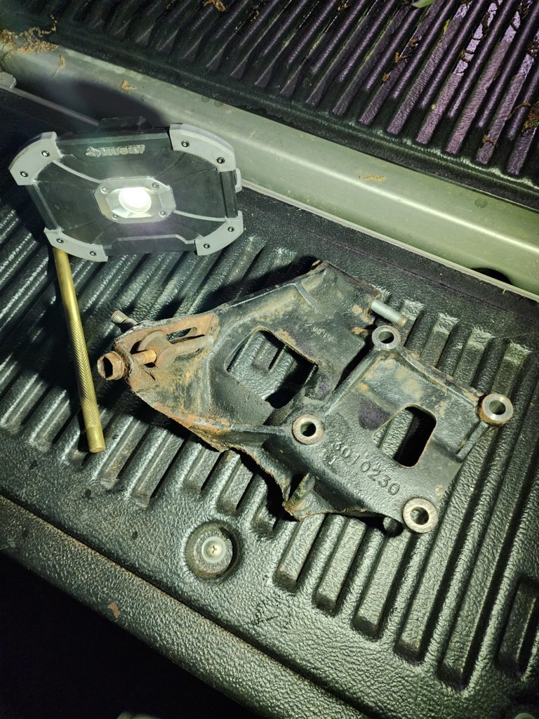

    Pulled the compressor bracket. It's nastily rusted - the bolt turns with some effort, but the idler only moves if encouraged by a brass drift + a firm tap with a hammer. Debating if I should strip it down to bare metal and repaint before it goes back on the truck, or if I should just go junkyard/partsouq raiding.

    If your local junkyards are anything like mine engine parts will be hard to find. Every Tacoma engine that isn't seized is taken immediately.

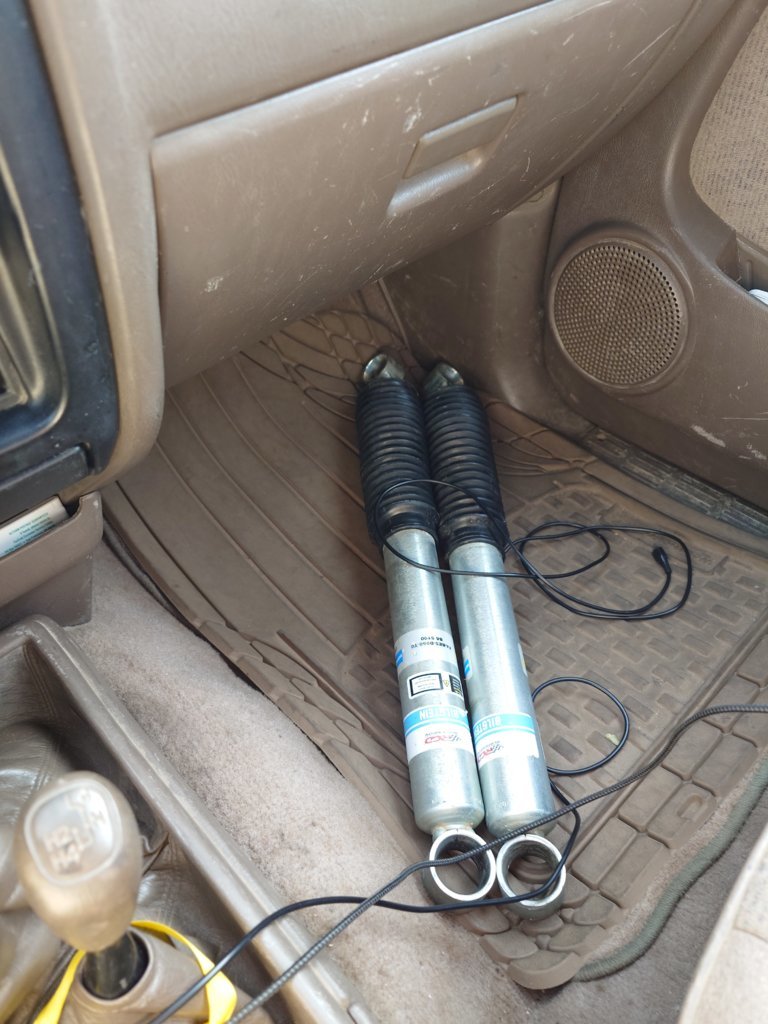

    Got these for 150, and installed them 40 minutes after. Earlier in the week I also replaced my fuel pump, it had kicked the bucket at 409k Miles.

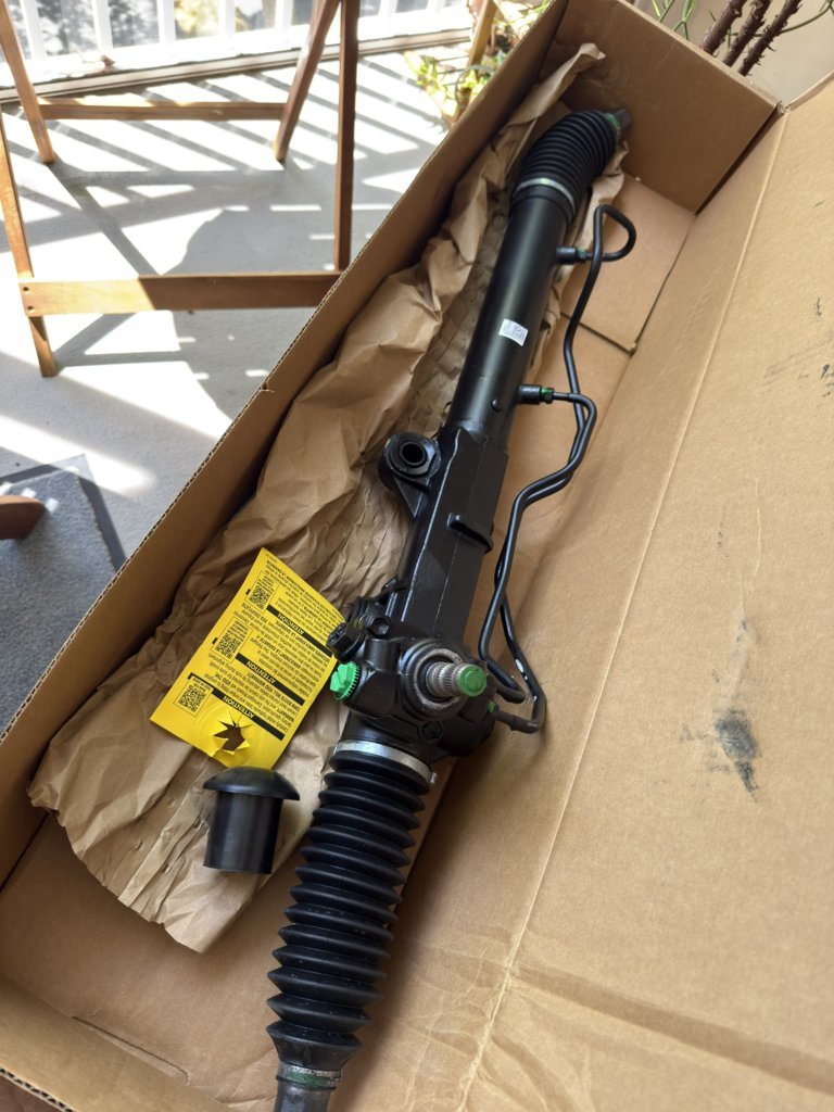

    Picked up the replacement rack today - this weekend is new rack to replace the one (4 years old) that is leaking already. "Lifetime" warranty but man it feels even cheaper than the first one from NAPA.
    Recently put 555 inners and outers on the current rack so will be swapping those over. Here's to hoping it lasts more than 4 years. New lines as well going in. Best part, there are no centering marks on the rack so have to find it manually with a marker. Have a feeling next time I will eat the cost and go OEM.

    My reman from the dealership didn't have marks either. Turned it all the way back and forth a few times counting rotations and then cut the number in half got me decently centered.
