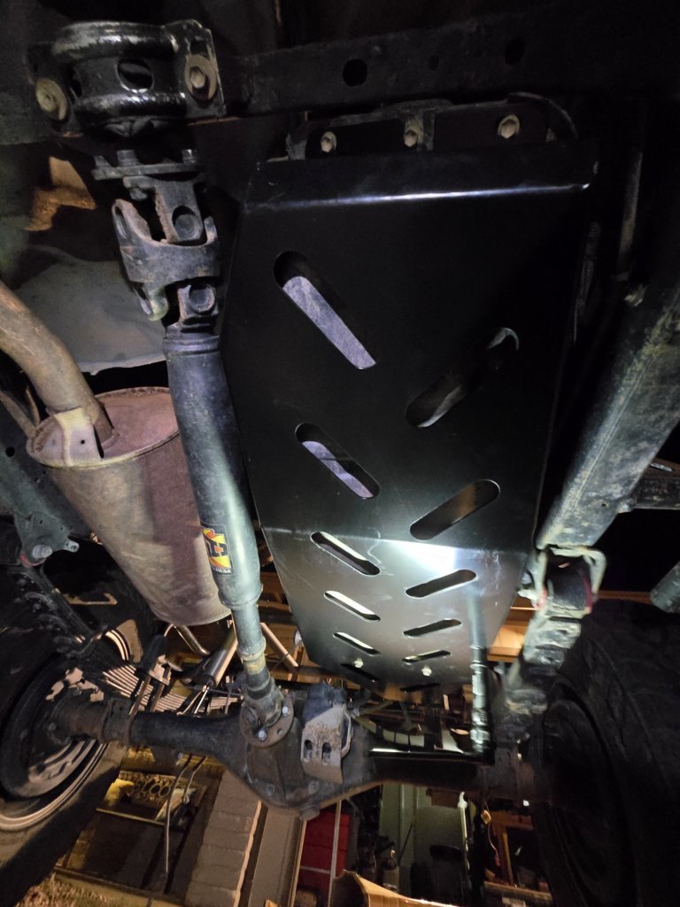

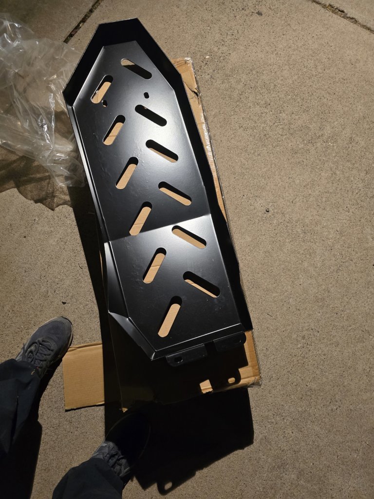

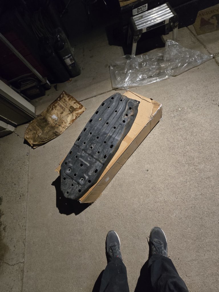

    Sorry what are you asking?
    The stock tank held up pretty good tell it didn't. Luckily I don't do a ton of rock crawling , but the one time I smacked it good it crumpled .

    Sorry stupid iPhone, was the fit decent?

    Lol I was trying to figure it out. The fit was good. I did have to losen the rear strap and give it a few taps forward and then it was good. The strap looked like it was to far back but who knows , I have had work done to my rear frame so..
