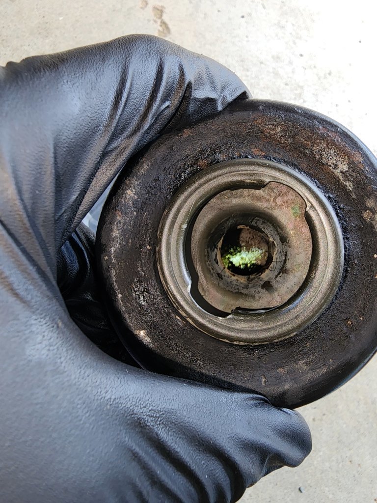

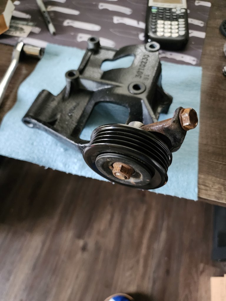

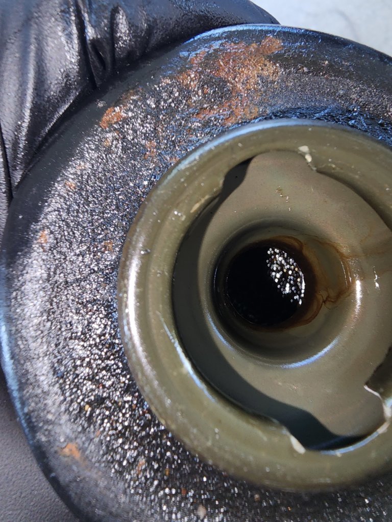

    Mounted the new idler pulley, and... did what I could for the filter on the power steering pump. A can and a half of brake cleaner in, it's a lot better than it started but nowhere near what I would call "clean".
    Look how shiny and new it is!
    Not a bit of light shows through. I'd apologize for the atrocious photo angle, but... this ain't an easy thing to photograph.
    Not sure if I should keep pumping brake cleaner through it or give it up as bad money after good. The fluid pouring out was a nasty brown color, but this is a lot better already, and I'm not sure how much better I can manage without prying the reservoir open.

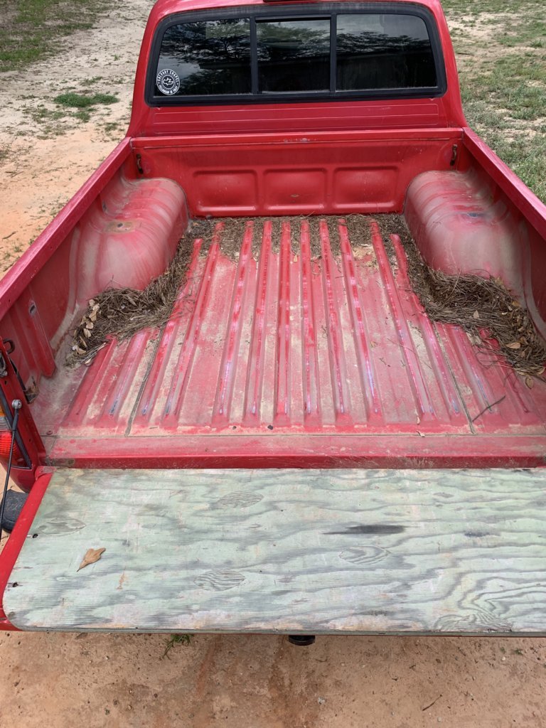

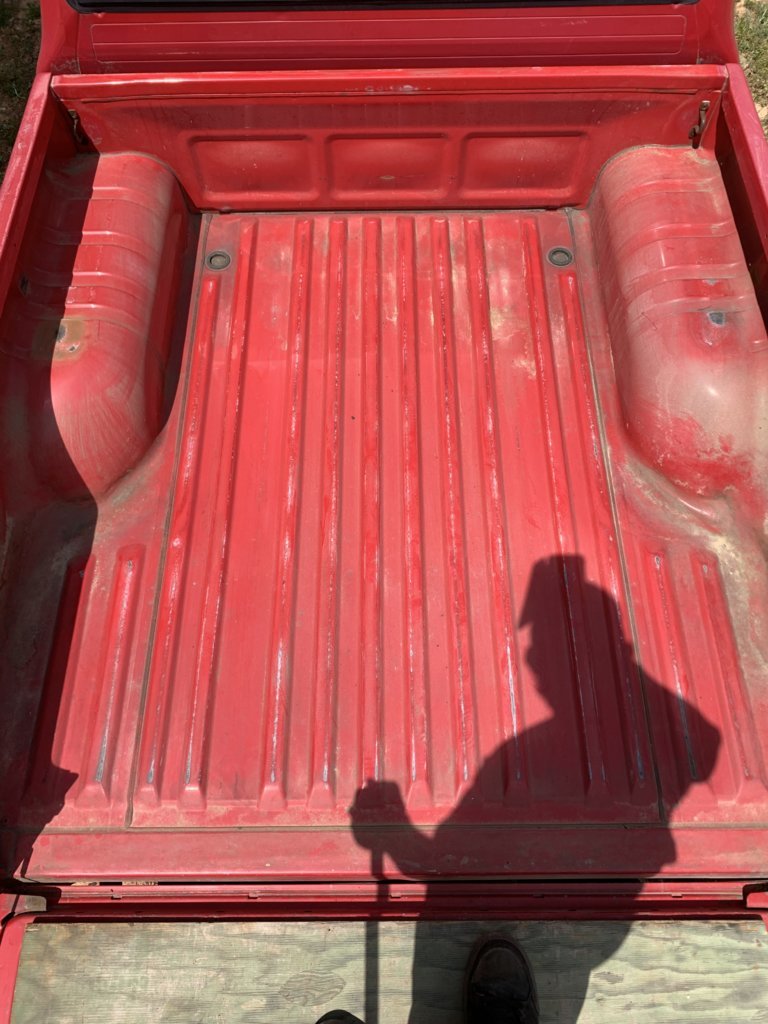

    Pulled the plastic bed liner out to prepare for the worst… but was pleasantly surprised to see no real rust. Just some paint that was rubbed through. 4322EE8E-CAF9-46F6-928A-8355A5407C87.jpg 624435AE-5829-48A7-B433-B8C409752353.jpg

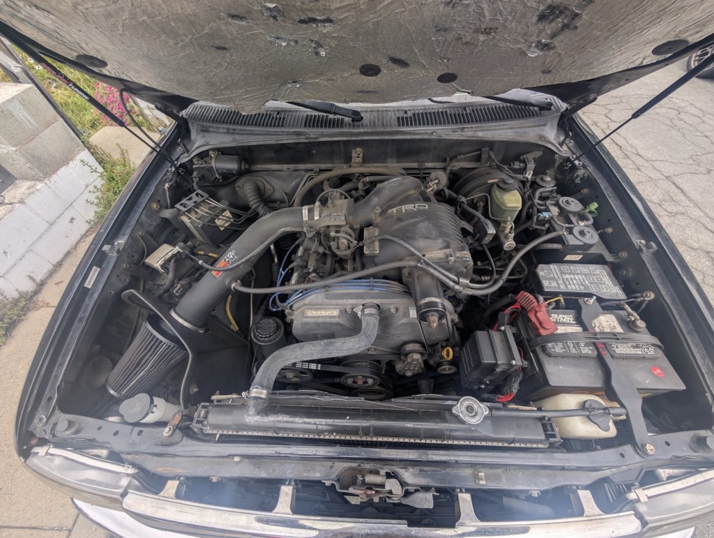

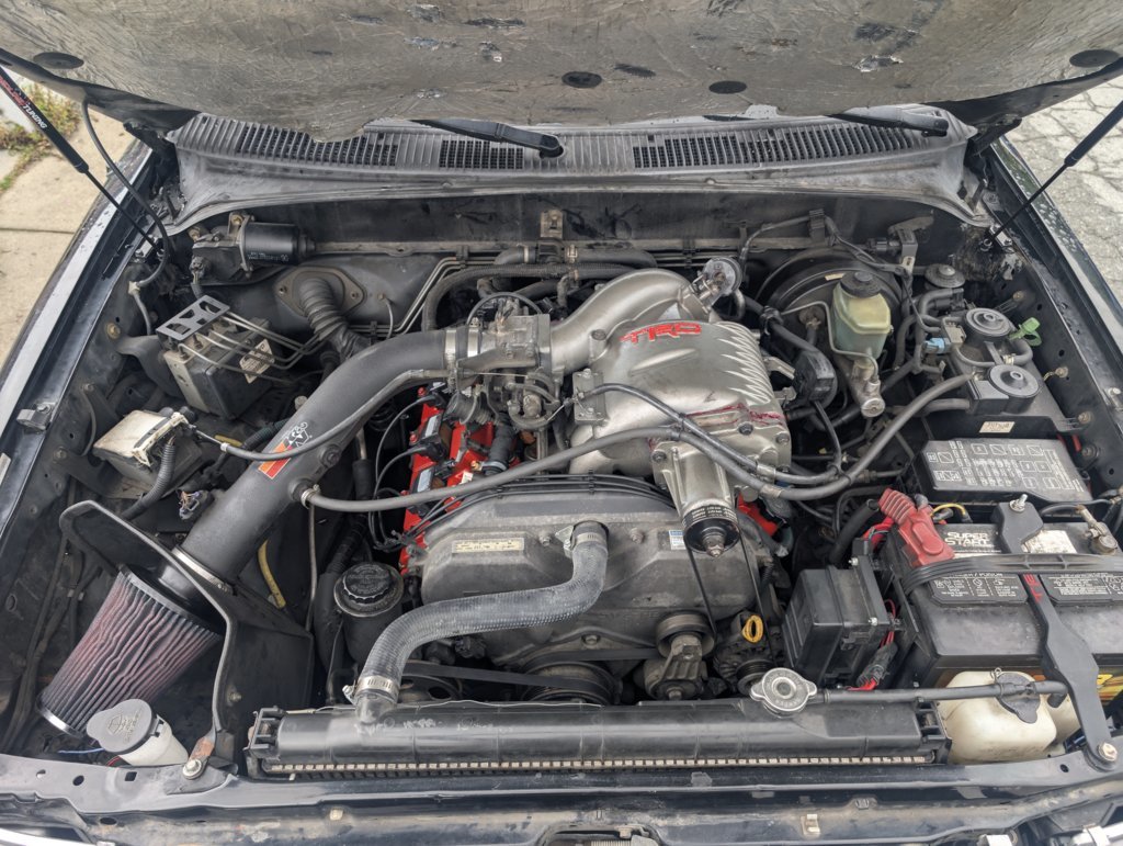

    47 hours later, and I'm done!
    Jobs included:
    SC rebuild
    SC paint (was meant to just be a touchup but I bought the wrong color, so I said fuck it and did the whole thing)
    Valve cover gasket replacement
    Valve cover paint (red makes it go faster)
    New spark plugs/wires
    Cleaned K&N filter
    Before and after:

    Well, I knew I had to have fucked up somewhere. After about 10 minutes of driving, I started hearing a grinding sound from the SC, and once it got up to temp, I lost acceleration and the check engine light started flickering.
    Edit: also, the damned drivers side valve cover is still leaking. I may have cracked it.

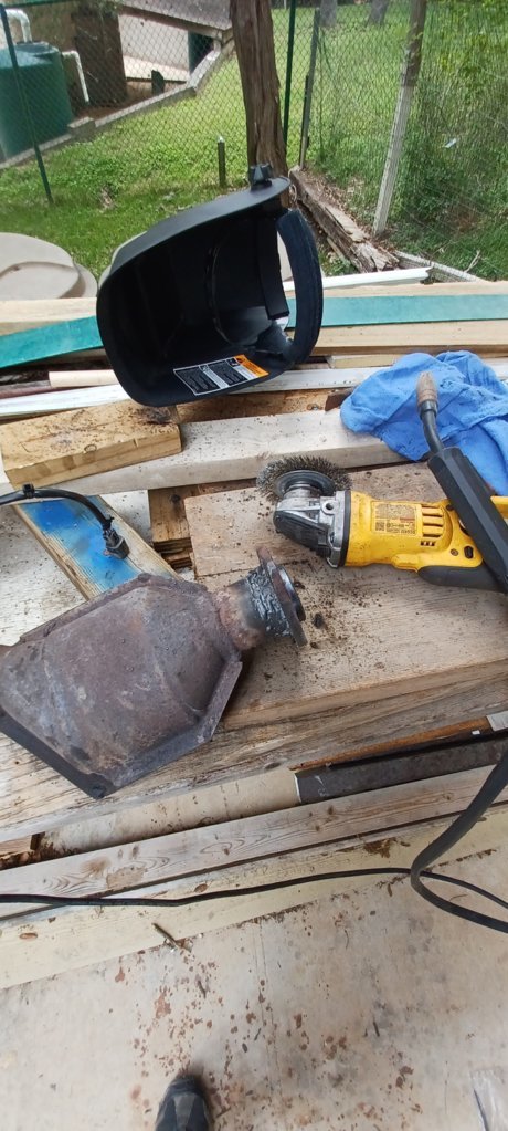

    Had an exhaust leak on cat. Proven with shop vac in the tail pipe soapy water trick. Which was generating a p0420 code and CEL. So I finally got around to welding leak. Not a pretty weld but seems to be effective. Put 25 miles on it no code. Codeless once again so far, yes!

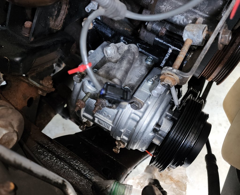

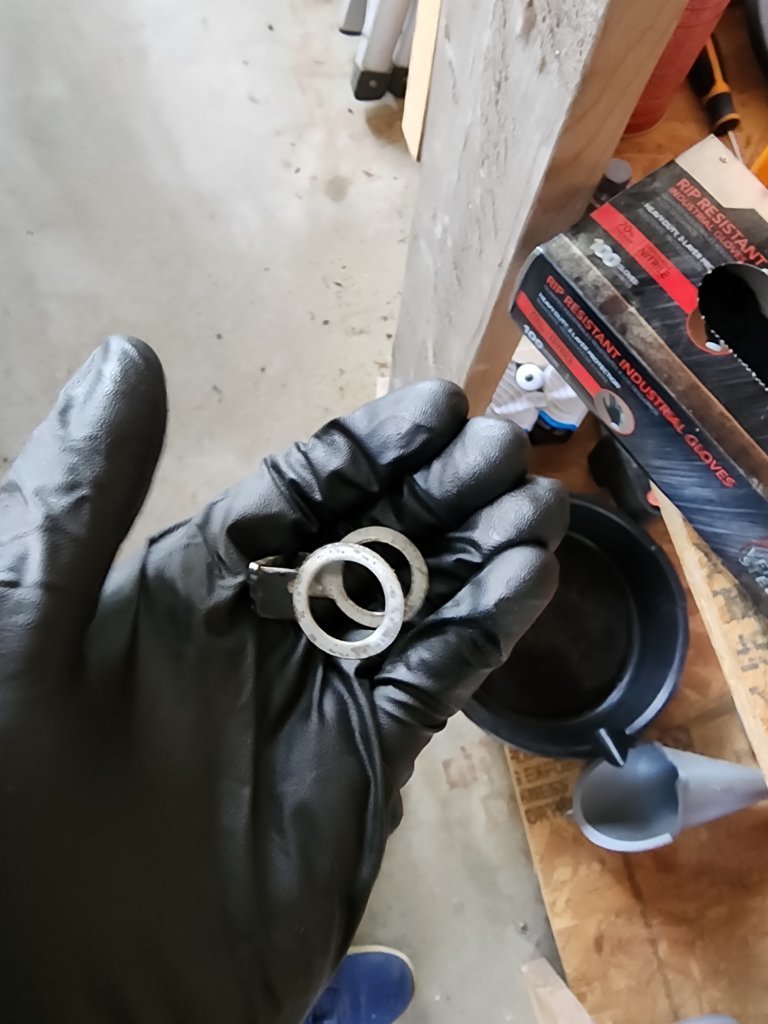

    Got the new compressor mounted, the belts and the PS pump on. Discovered the banjo bolt for the PS pump has some kind of shim instead of the copper crush washers I expected from turbodb's excellent guide. Oh well. Always some differences between late-model and early model trucks, even in the same generation.
    Aint' it pretty? All shiny and new.
    Not sure if it's a shim or a crush fitting.

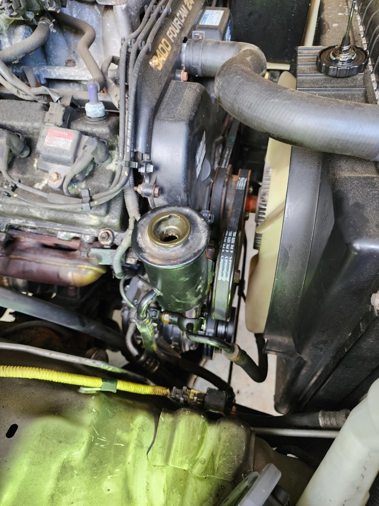

    Home stretch! Cap's off the reservoir to let the last remnants of brake cleaner that might be in there keep evaporating.
    Oh, and I cleared 21 years of road grime off the engine/differential/transmission skid. No real reason to, except "why not" while it was already off.
    I'm tempted to wrap this job after work during the week, but realistically that's not going to accelerate the "back on the road" timeline. And the diff & transfer case oil are probably going to eat the shop time I have after work anyhow.

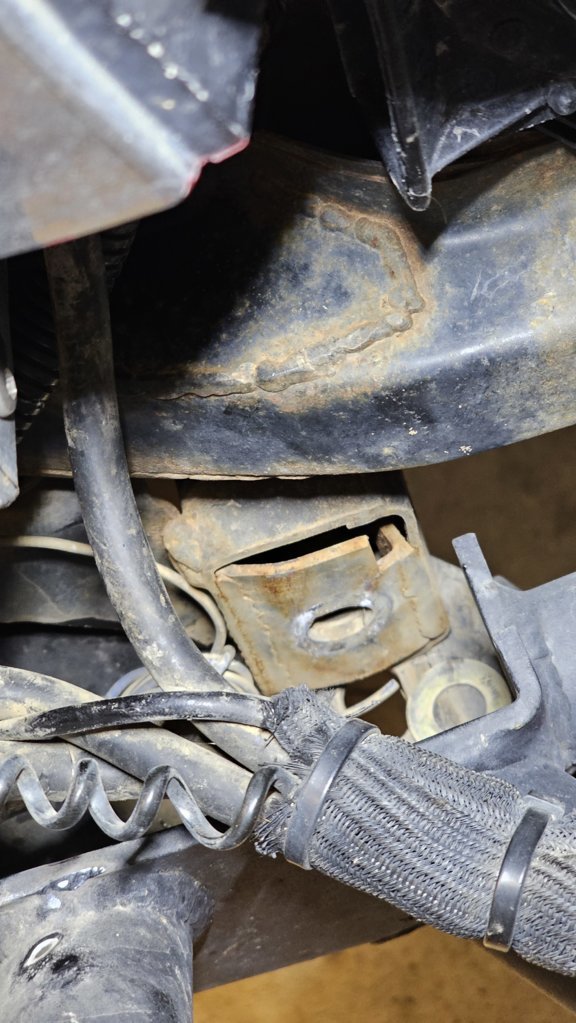

    Welded in some stronger front bumper tie-in plates. Winches are powerful I guess
