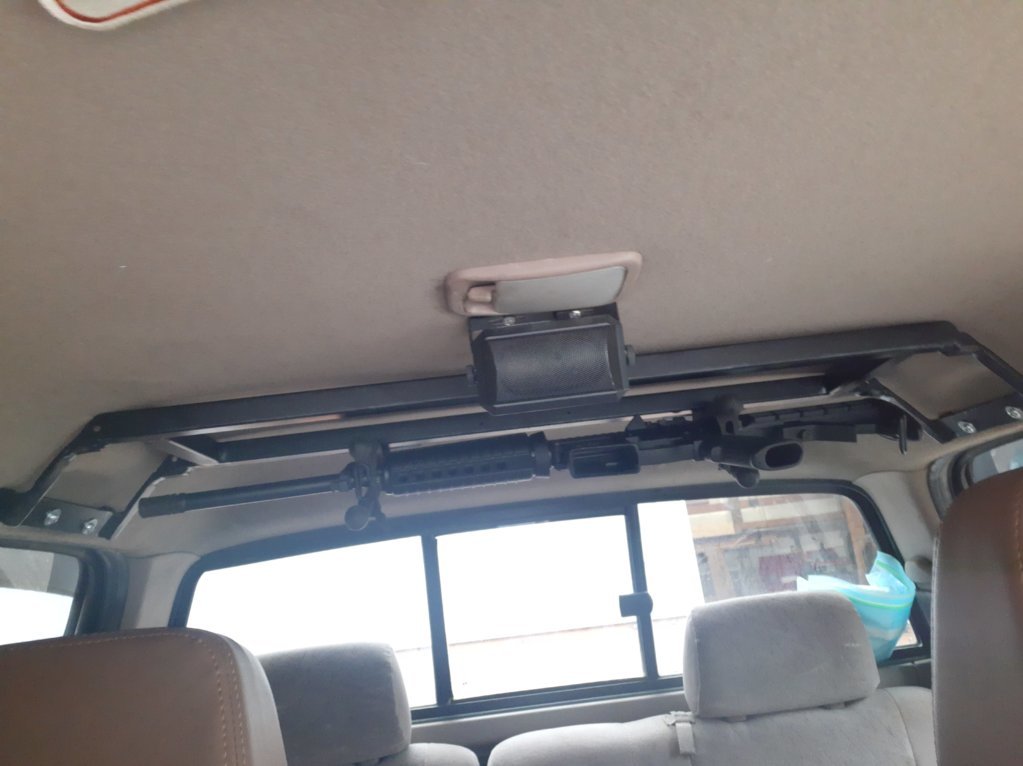

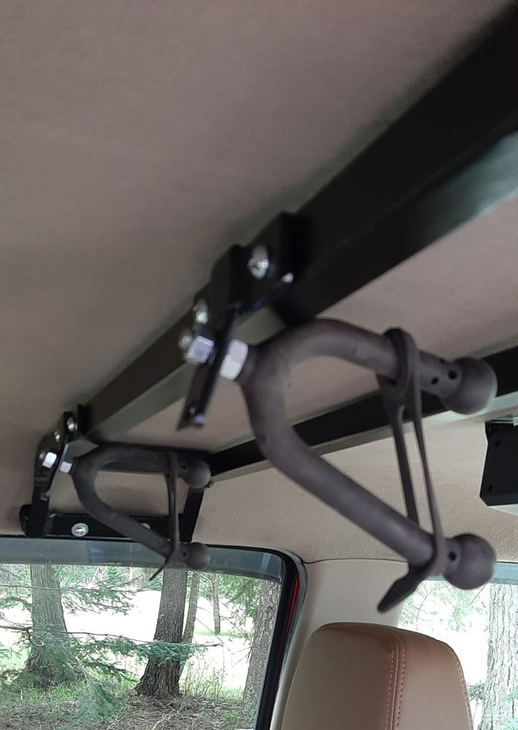

    Well, more of the last several days than just today. I built and installed an overhead rack for my double cab.
    This may be just version one, I'm likely going to be looking at improving, and refining it as I use it.
    To mount it, I replaced the handles with a pair of stand-offs, and attached my rack to that.
    I loaded it up, and took a test drive over a logging road, and it doesn't rattle around, or have any other weird noises, so far...
    Sooner or later the rear seat is coming out, and I will be building a 'rear seat delete' platform.

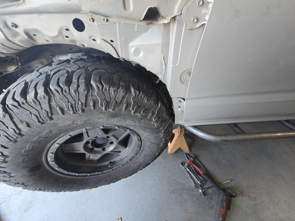

    which Body Bushings are those, and why doe it look like there's a ~1/2" lift?:boink:

    Energy Suspension body mounts with SRQ Fab 1 inch body lift.
    But these cuts were made to clearance with stock body mounts, no coil overs, and no bump stops installed.

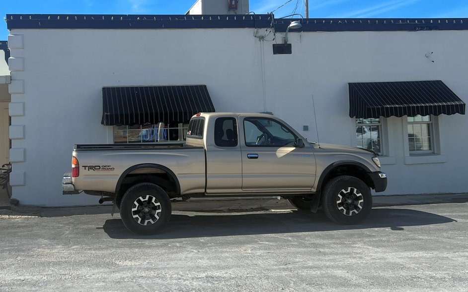

    Everything but the driveshaft. B03A - 410
    I like the way they run. I had some 1" bora spacers that I put on just to give them a little more clearance on shart turns.

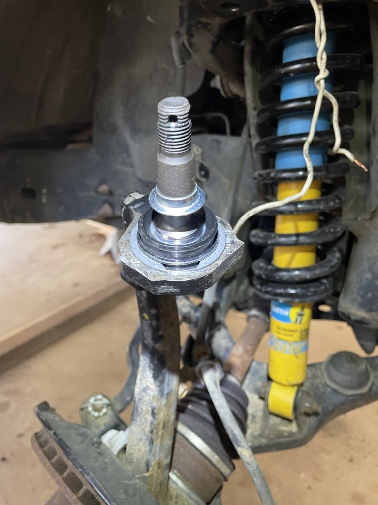

    New OEM upper ball joints are in. Many fights along the way between finding the right parts to press them out, freeing from the upper ball joint, that fucking weird C clip, seating them properly etc. Glad I’m done!

    Been there done that, not fun. Installed one side using the ball joint c clamp style rent a tool, fought it for 2 hours and done. The next side I pulled the knuckle and put it in the shop press. Out with old in with new 20min.

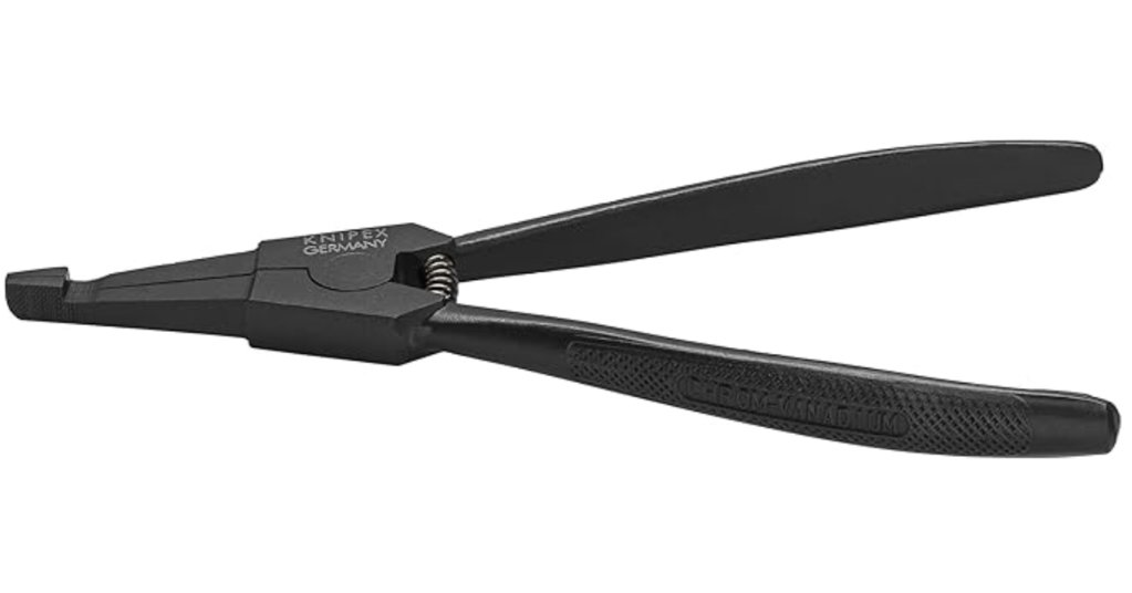

    Those rings are a snap with the right tool. I use Knipex 4510170.
    Looks like they've been discontinued and replaced by 4511170.
    https://www.knipex.com/products/cir...ng-ring-pliers-retaining-rings-shafts/4511170
    There are other brands that I'm sure would work just as well. A bit of a splurge but from the moment I used them the first time I had no regrets.

    all of this. Use them to rebuild cv’s, do the c clips on the rear axles etc. before these life was hell doing those with regular snap ring pliers.

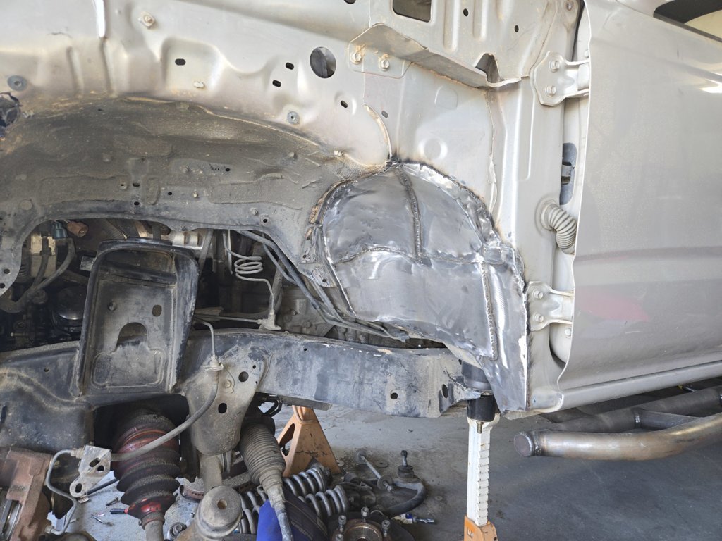

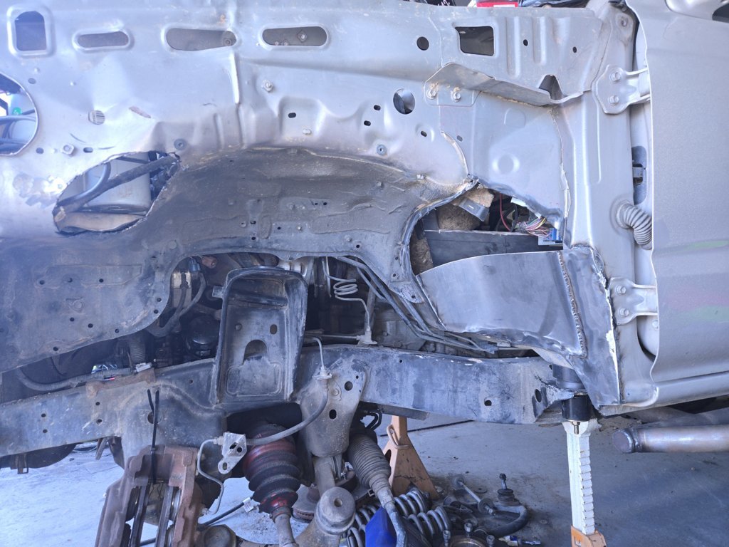

    With the 15 inch holes finished... it's on to the 8 inch holes :sawzall::welder:

    What is the foot box like ? I'm guessing this truck is a auto , because it has to be tight in there.

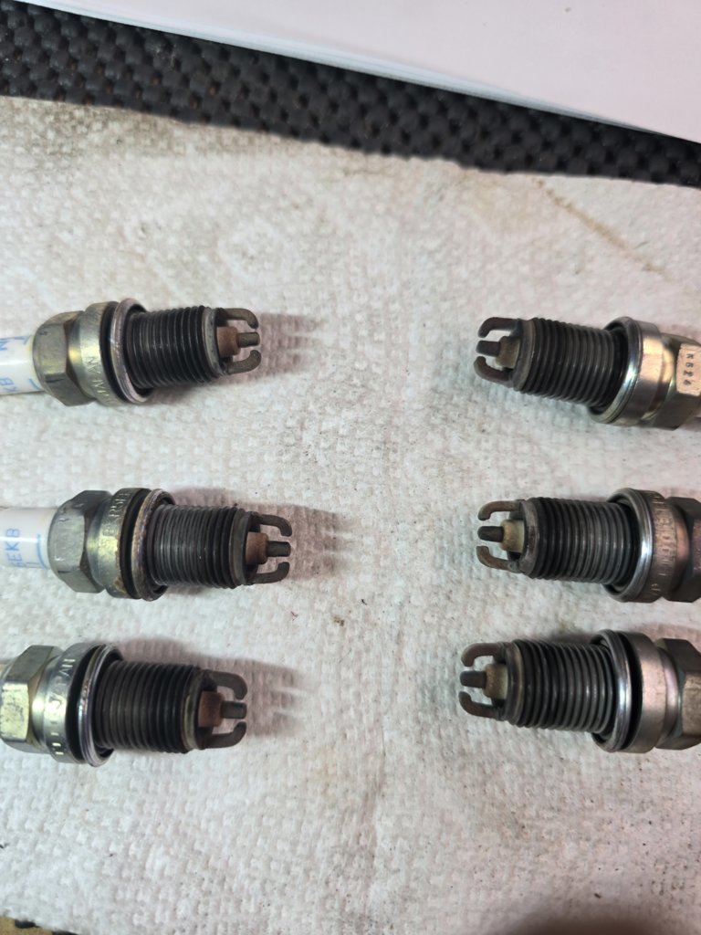

    Can I get some insight on my old plugs ? Only one side has combustion marking on them .
    You can see the blacking on this side.
    And almost nothing on this side.

    I don't think it would work with a clutch pedal. I don't mind it at all though. This is exactly the same thing I did to the Tacoma. I've had no issues. Even when driving long distances. King of the Hammers is an almost 6 hour drive for us, and I've done that twice since I did this to the Tacoma.
    My wife shouldn't have any problems with this. Her feet are a lot smaller than mine, lol.
    (This runner is for her)

    That's what I was wondering. Looks good
