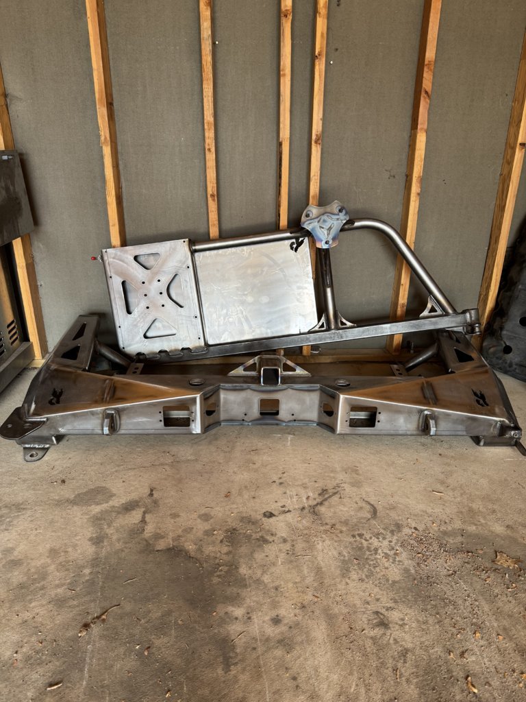

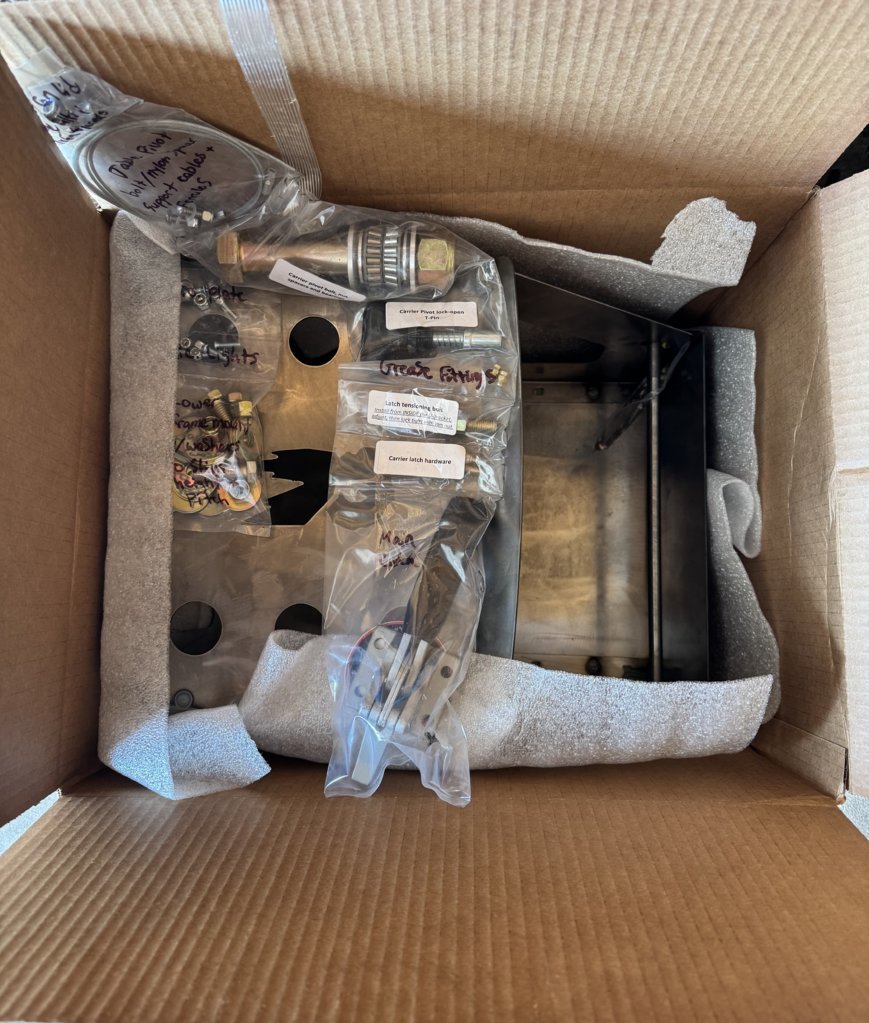

    Just came in today

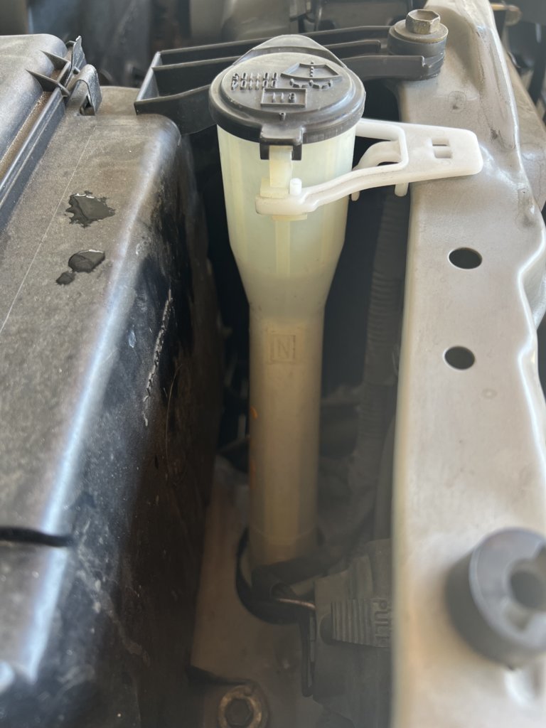

    IMG_4222.jpg Replaced the windshield reservoir filler tube with one from a 4Runner.

    that asssss will be dragging :rofl:

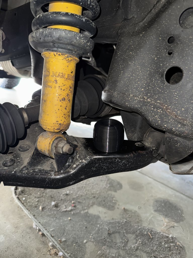

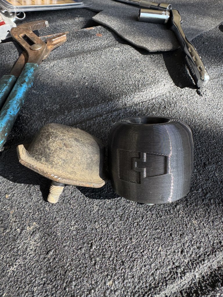

    Switched out the stock bump stops with these Perry Parts bump stops. Thanks to @unstpible for hooking it up.

    With taller bump stops like this, what is the advantage of the stunted up travel of the suspension? Always looks like people only have like 1” of up travel till they hit the bump stops- seems a little counter intuitive? I’m here for knowledge of our IFS

    I believe they are a "progressive " style of bumps. Their not hard for the initial part of the trave like the stock bump. So even though your into them earlier it's a softer smothered hit.

    How far do these compress?
    Was just playing with my suspension the other night. 1" of shock travel equated to roughly 3" of wheel travel. I noticed I wasn't making use of the last 1" of shock travel. Figured if I removed the bumps I'd gain 3" of up wheel travel. Not sure if the CVS could handle that though. I'd say that's a pretty significant amount and probably worth relocating the bump location so it doesn't limit travel but still protects the shock from bottom outs.

    Depends on how hard you hit them. If you want to go through the effort of relocating then you might as well get hydros

    I don't disagree but when hydro cost 8x as much I could see these being a decent option.

    Def not 8x as much. Durobumps go for just over $200 these days and you can get a set of locked offroad hydros with cans for about $450.
    edit: just saw that perry bumps are way more affordable at $90. So 5x at that point
