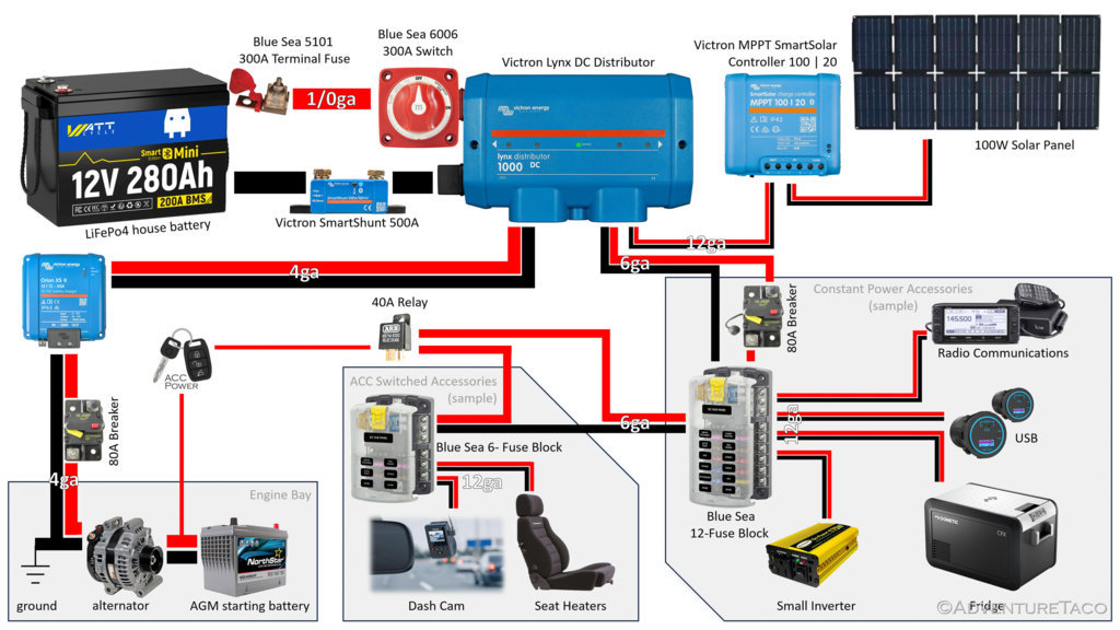

    Working on a new house battery system. Converting to LiFePo4 from dual AGM, and taking the opportunity to build out something that is so overkill as to be humorous. Really, the only new components for me are the battery, shunt, distributor and DC-DC Charger; everything else is reused from the existing house setup.

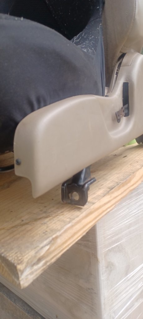

    I did the @mechanicjon drivers seat side metal bracket for cover mod/fix. Came out perfect. Mine was busted up so had to fix cracks and clips busted inside cover and I had to use the sheet metal screws in front and top to attach to plate also but it's rock solid and good to go. Thanks, I got it from his ebay store that's where you should get it from. The Chinese have ripped off his design so get the real deal from him and its USA made. I went the ebay route if you can buy it directly even better.

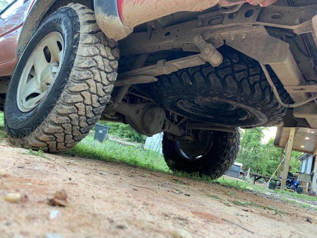

    New rubber + matching spare
    235/85R16

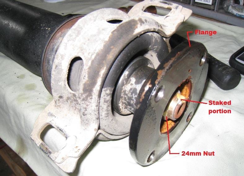

    Been busy chasing a vibration that comes on around 70 mph.
    Is it normal to have play in the rear driveshaft if I grab on either side of the carrier bearing (grabbing the shaft immediately in front of the carrier bearing and the flange immediately behind)?

    A little bit of side to side and up and down movement from the driveshaft inside of the CB is normal.

    Ok, I knew about the up and down, but you're saying some rotational play (i.e. I can rotate the front section several degrees whilst holding the rear section) is also normal?

    Wow, no. If the two halves of the driveshaft can rotate independently of one another, there is an issue. There is a splined connection just downstream of the center bearing to a flange that is bolted to the double cardan joint - if that spline is worn or the staked nut is loose, that may be the cause of the play.

    Ok that's kinda what I thought. It's strange that my only real symptom (and why I'm looking at the driveline) is a vibration that comes on strong at 70-75mph.
    Looks like I'll be taking apart my carrier bearing and checking those splines and stake nut this weekend.
